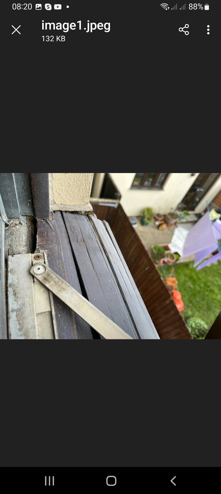

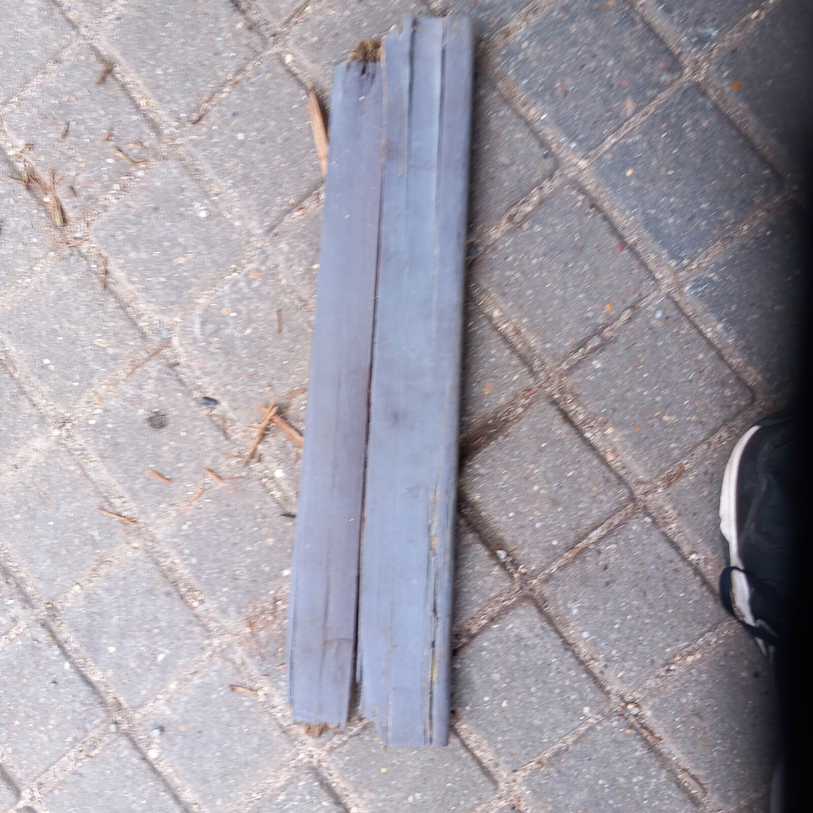

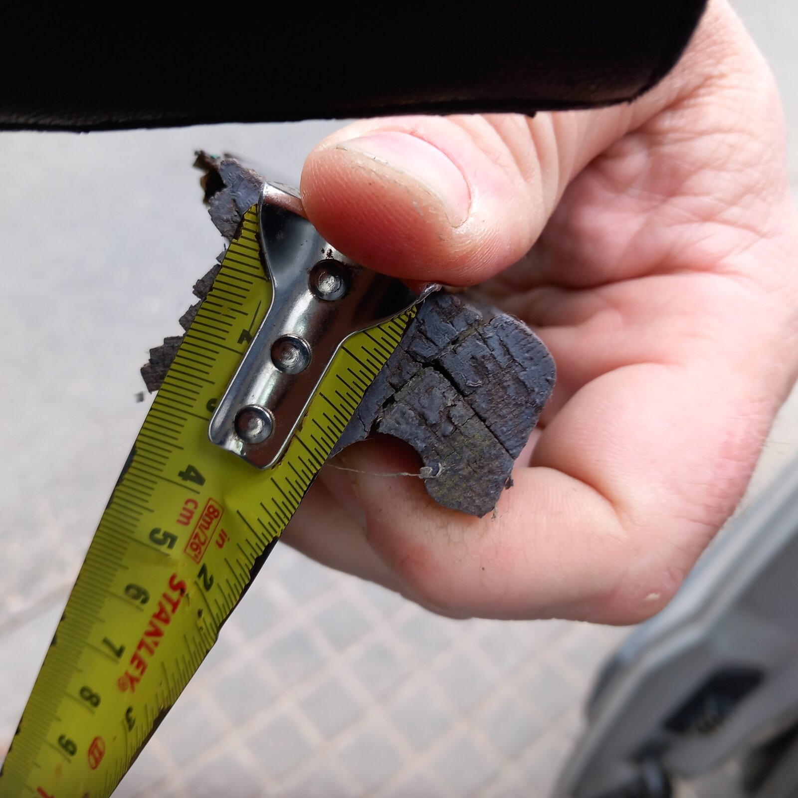

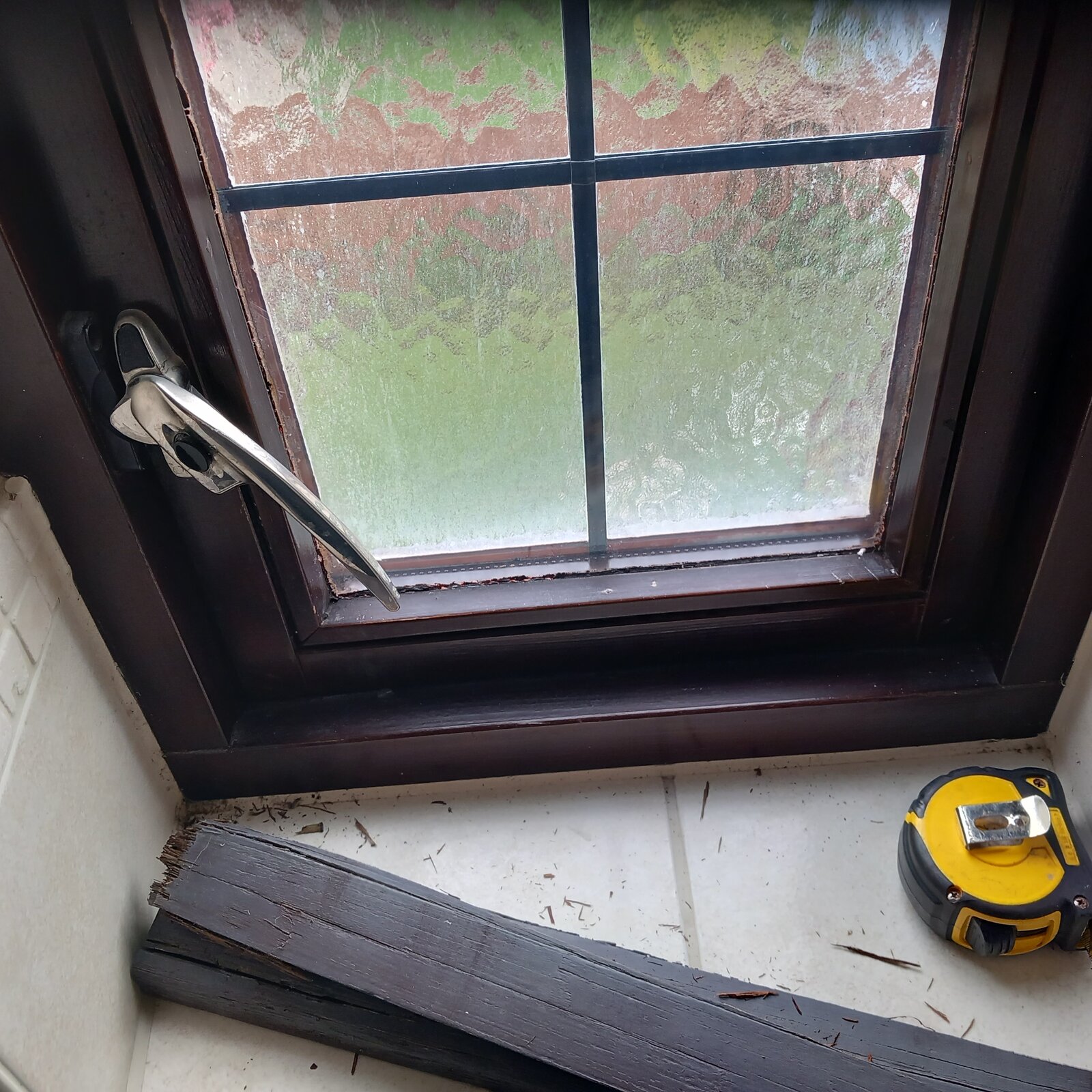

Is it best to rip the sill out then put a new one in (planed to size and hardwood) jammed in with expanding foam?
Did sill on same property 2 yrs ago and it had just fallen out. Will this just come out too?

I'd use repair care dry flex 4 resin to fit new sill.

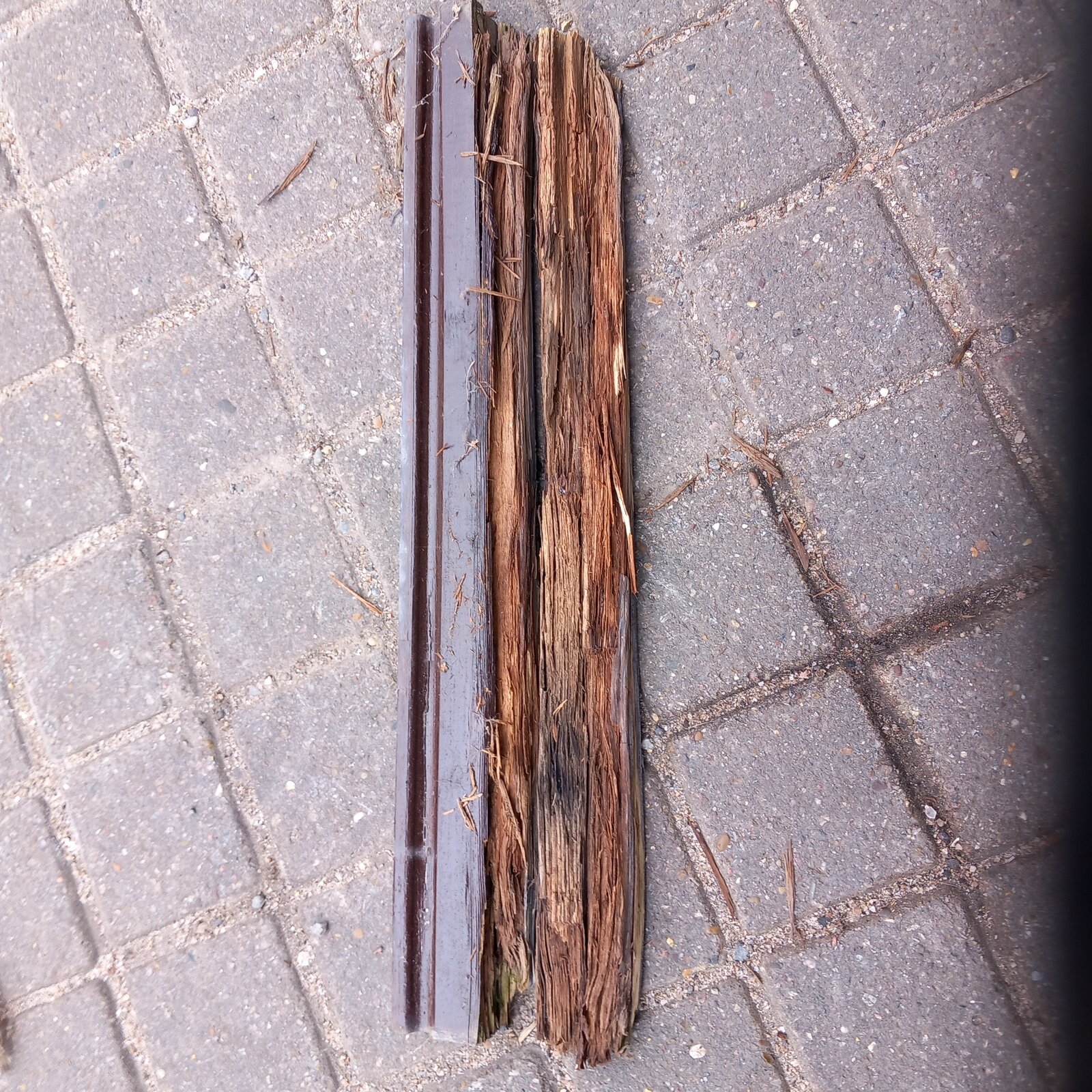

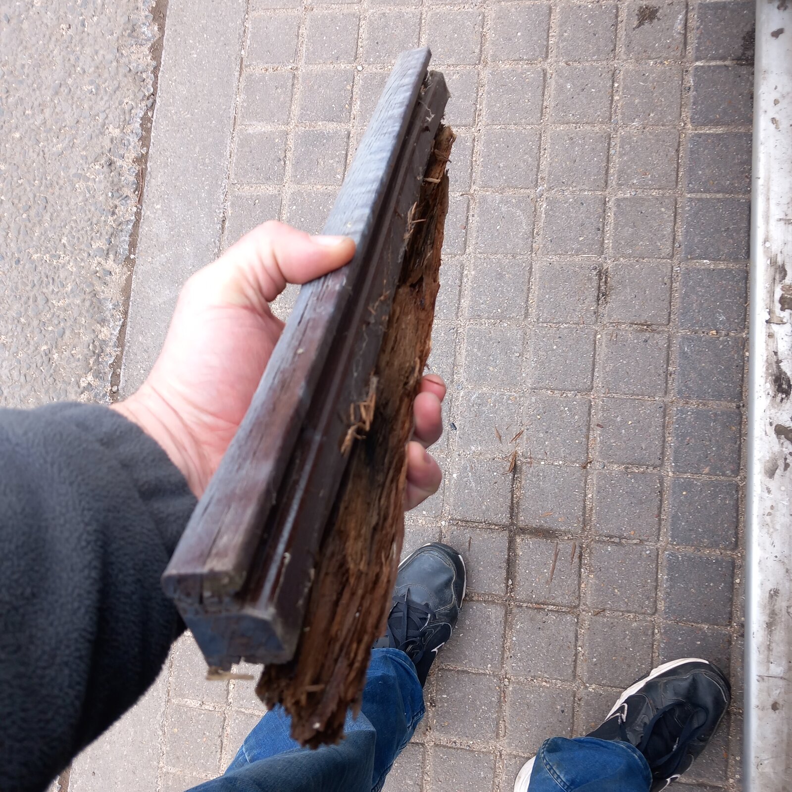

That looks like cheap soft wood. Hardwood would be much better, but if you are going to use softwood again, make sure it is properly seasoned and seal all faces, especially any cut ones, before installation.

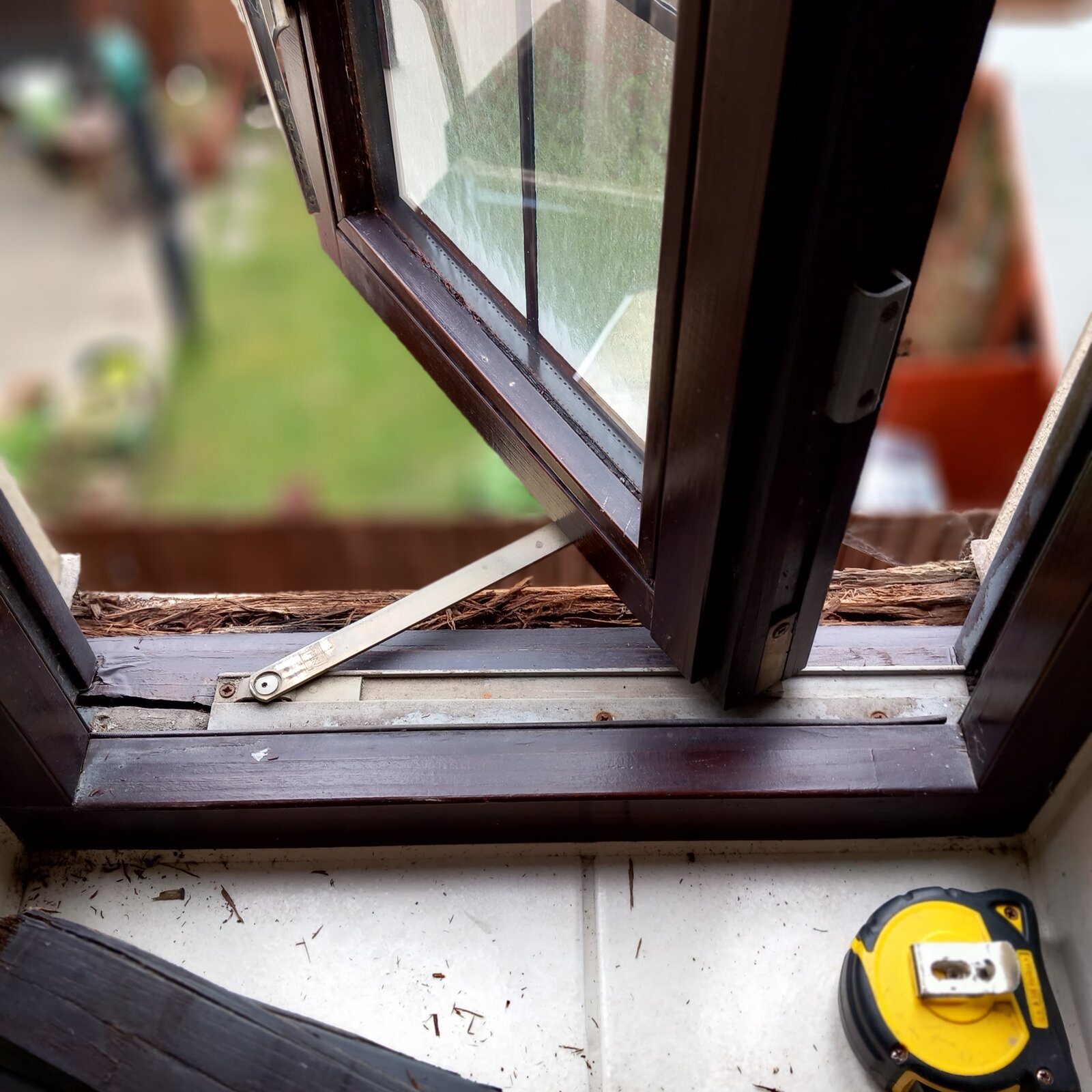

What's size is the best replacement?

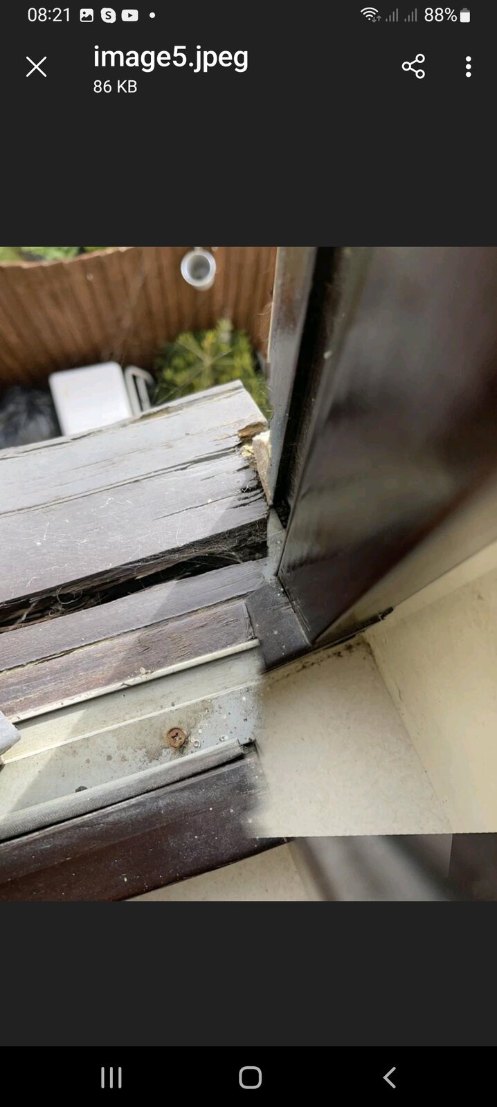

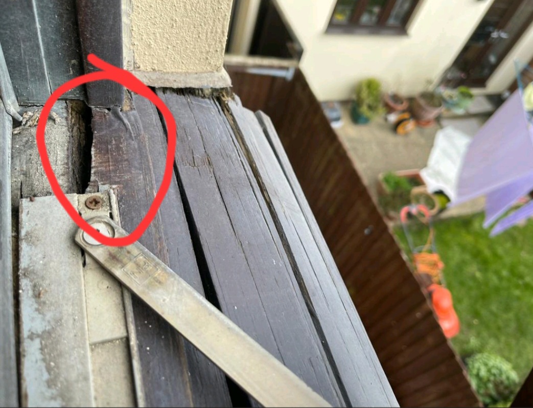

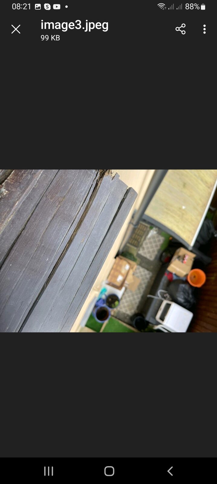

It's not just sill either, there's a crack on bottom of window frame (see pix) this should be replaced but not sure on a 1st floor I have skill or will to do that. I'll just jam sill in with expanding foam and try and seal that crack. Explain situation to him too. He obviously doesn't want to pay too much.
Could I use 2 part filler on the crack or that
repair care dry flex 4 resin is the only way?
