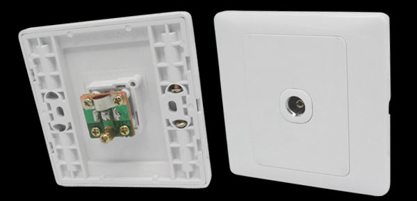

My first question is would it be better to run the cable directly from the splitter to the TV without installing a wall socket instead? Obviously it would be neater with one but I'm worried it that the signal would degrade using something like this especially when I'm already splitting it?

There'll always be some signal loss when a joint or other piece of hardware is added to an aerial system. Having said that, the signal loss through a wall socket isn't that great. With a decent quality wall plate you'll lose about 2-2.5dB. In the grand scheme of things a 2.5dB loss shouldn't be enough to cause any issues so long as the rest of the aerial system is up to the job. To put it another way, if putting the plate in did cause problems then that's showing you there are bigger issues to deal with elsewhere.
There's a good primer about what to look for and what to avoid here: http://www.satcure.co.uk/tech/wall_plates.htm#avoid They also sell decent gear by mail order so you can take the risk out of ordering on-line.
