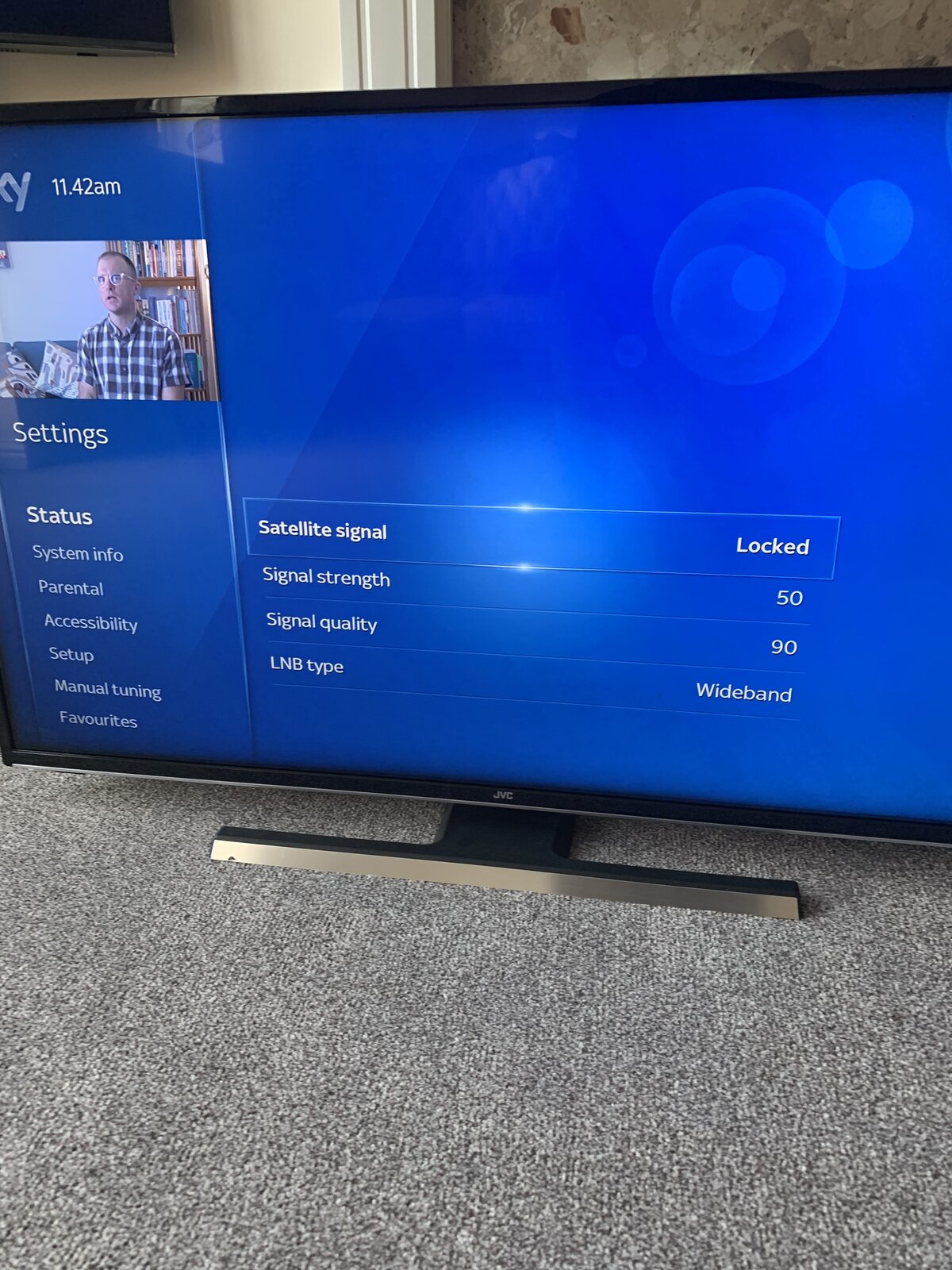

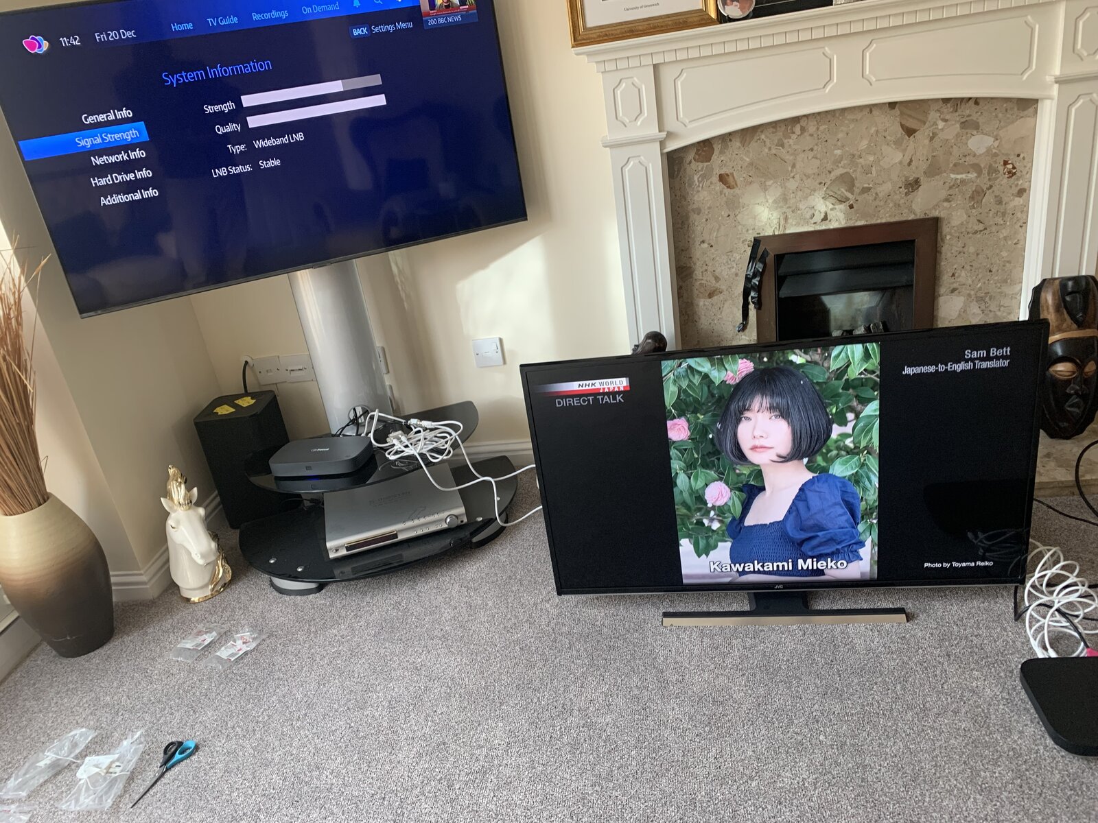

yes i have tested today and it works following your advice . i bought 2 splitters as you advised. connected both the freesat and yet to be returned sky Q box.
worked nicely. see pictures below.
signal quality 90% and strength appx 50% on sky box. freesat signal strength about 60% and quality seems 100%.
left both boxes on for about 30min and no pixilation or cut outs/freezing or anything. am well chuffed with it. seems to work very well. hopefully no surprises to come LOL.
Question- with both freesat and sky Q boxes sending power to the satelite dish via the 2 splitters, hopefully not an issue?
