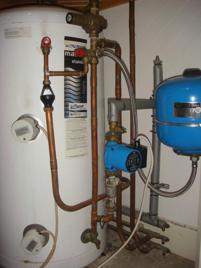

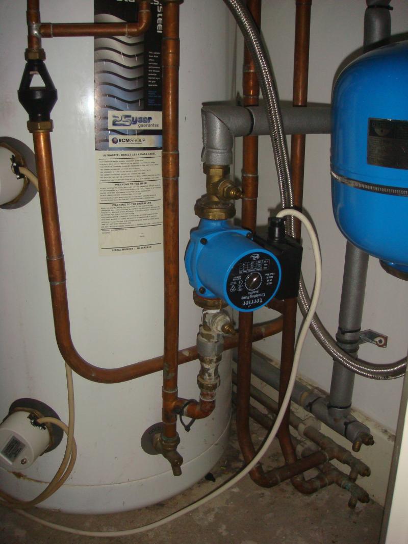

Just to confirm, the pump that I mentioned is a Terrier TC6 circulating pump. As I said, I dont know much about this kind of thing, but I figured this would be used to ensure hot water is fairly instant at all taps/showers etc.

The terrier TC6 is only suitable for heating systems, you should have a bronze pump if its on the hot water system, if they have installed the wrong pump there is a good chance they have not installed a nrv either which would give the problems your getting now.
That pump will just rust up and jam anyway! The system has been operating correctly for 4months so the lack of check valve next to pump can't be it otherwise it wouldn't have worked when they moved in! I suggest you get a BPEC domestic hot water storage systems qualified installer to check it over because it sounds like you have a few small problems regarding the installation of the unvented cylinder, if installed incorrectly theses things can cause explosions and level houses! It would be difficult to install one that badly though!

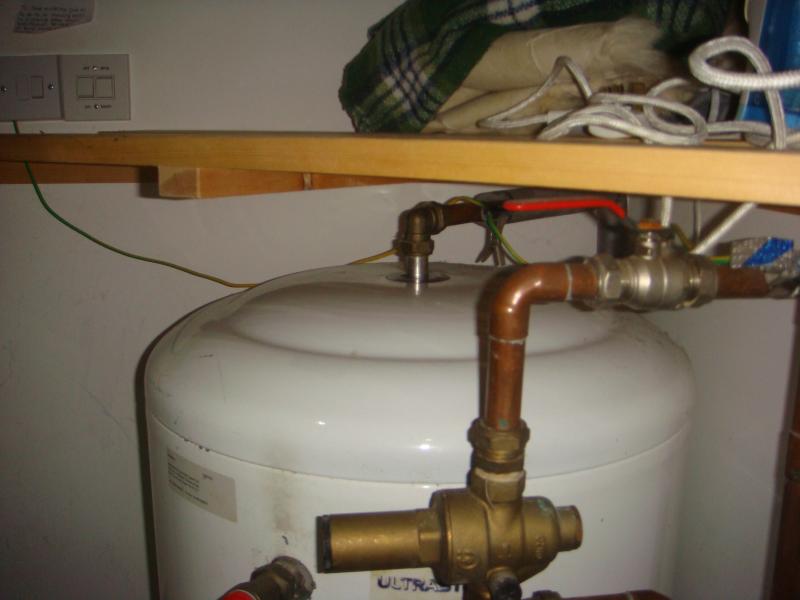

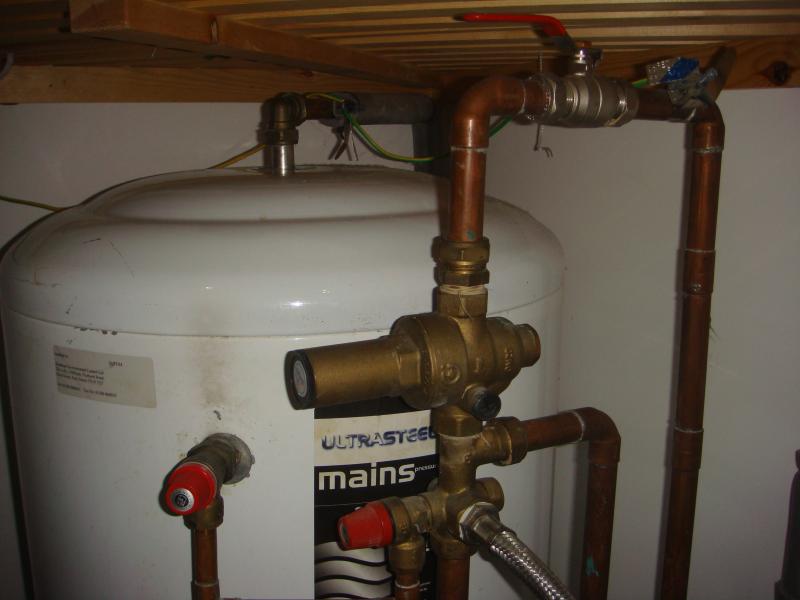

A few pictures of the cupboard would help us identify your system better! You can't see if the check valve/non return valves are working correctly the components are internal! The pump may well be part of the heating system, as for the immersion switches its sometimes cheaper to just leave them on depending on user requirements for hot water! Try leaving them on tonight and try the taps in question tomorrow!
you have the wrong type of pump installed, the terrier is for heating systems and will quickly rust away, if your not going to use it, close the valves either side and see if that stops the hot taps running cold, if it does that proves that the nrv (just under the pump) is stuck open,
if it doesnt solve the problem I would leave the pump isolated until your ready to change it, then its a case of isolating each outlet until you find the one that is passing cold water into the hot supply.
