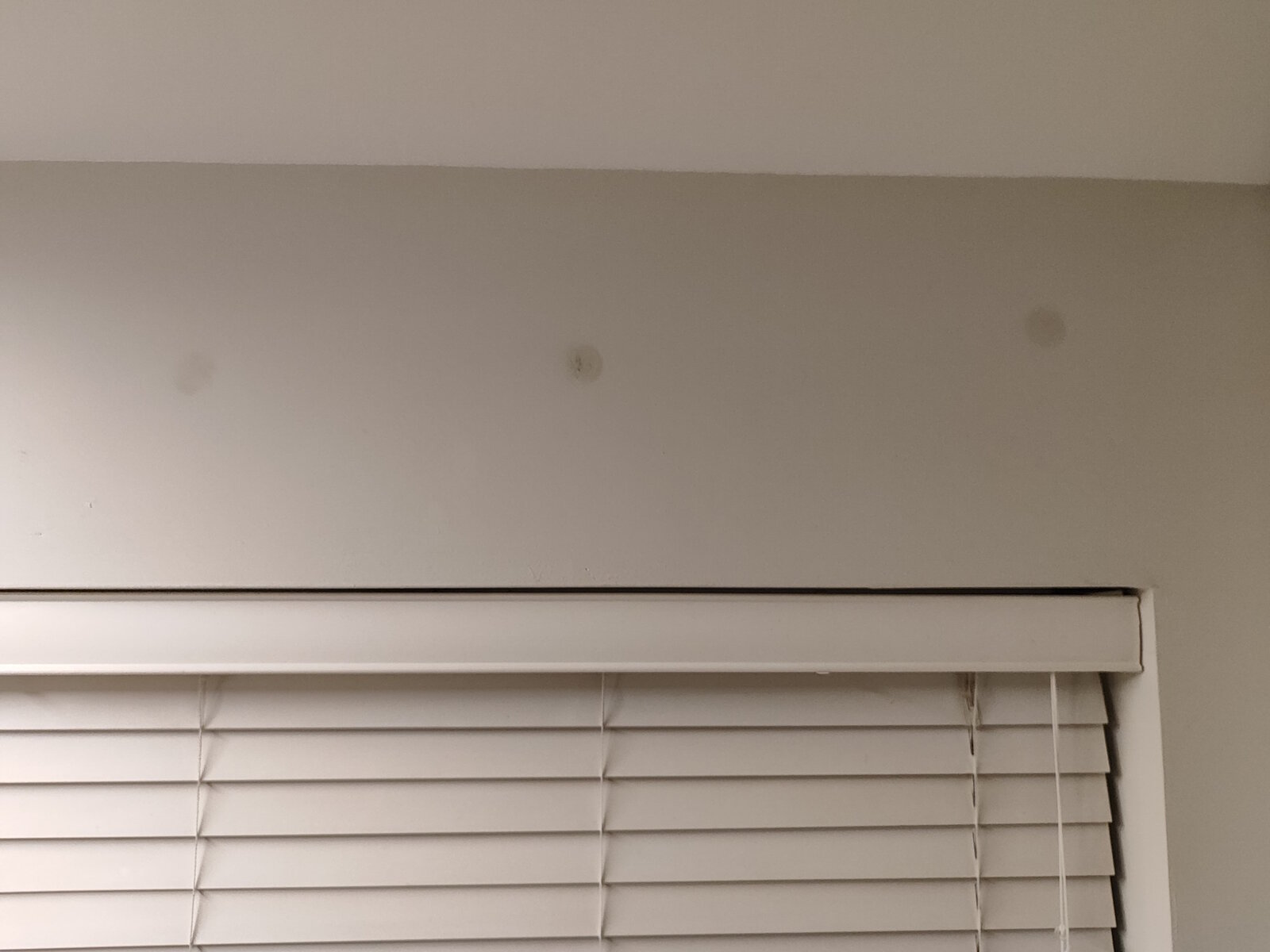

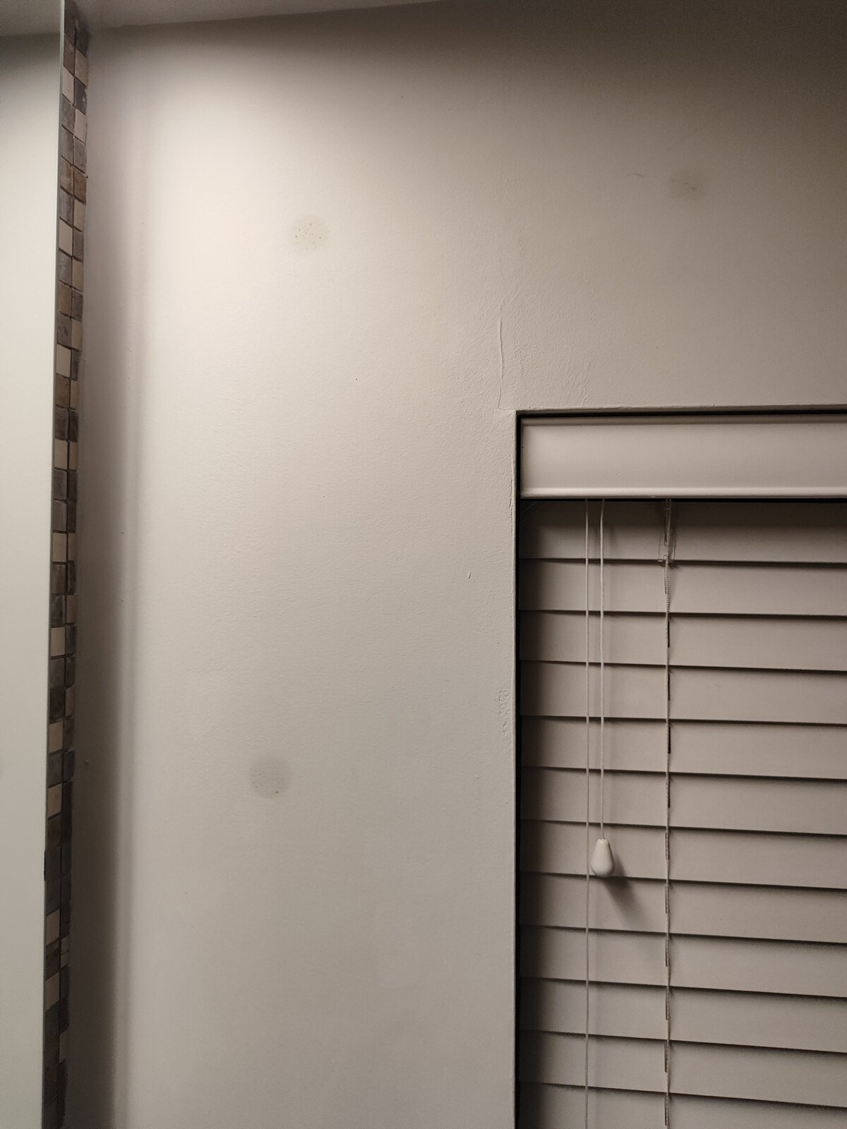

Hi there,
I've spotted these circular patches of mould in an upstairs bathroom recently - the wall is south facing. The house is a mass concrete mid-terrace two up two down and had extensive renovation about 12 years where internal insulation board (62mm I think) was fitted throughout.
If my understanding is correct, the pattern of spots indicate a cold bridge from the fixings - the spots have only become apparent recently, possibly coinciding with a new dehumidifier that is now being used daily in the an adjoining upstairs bedroom. Upstairs isn't heated most of the time, perhaps for 30=90 mins before going to bed during the winter.
Is this common - should I just paint over them with cover stain and forget about it? Or does it indicate that some other course of action is required. Thanks in advance
Odd those patches.
Looks like old curtain brackets marks and tiebacks but dont line up.
Id just wash and paint myself
There are mechanical fixings that are used on insulated board and standard boards that are dot and dab. Could be those causing cold bridging.
Would explain the small round circles and the position of them
Condensation spots.
You say course of action.
It's a bathroom.
Provide an effective extractor to lower humidity.
