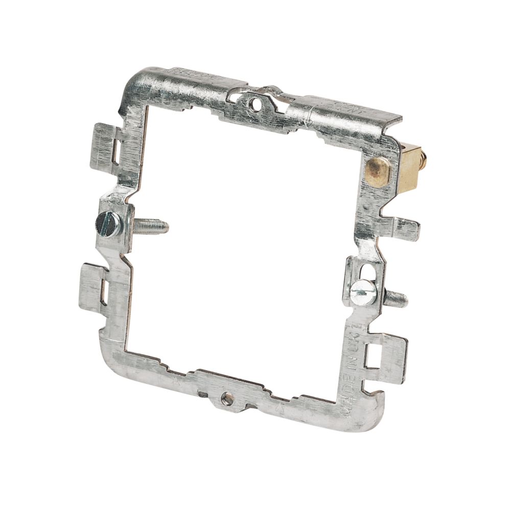

I found this grid plate online:
Would it fit into the existing backbox do you think or require a special one?
I would probably use these then (hopefully the MK grid plate and switches are compatible with the British General faceplate):
There is no standard for grid products, so generally all the parts (grid, faceplate and modules) should be from the same manufacturer.
OK, I'll look for parts from the same manufacturer then, thanks.
Only remaining doubt is would the existing backbox accept a grid plate or is it necessary to install a special backbox as well?
Grid plates of that size fit on normal backboxes, but I'd reccomend at least a 25mm one.
