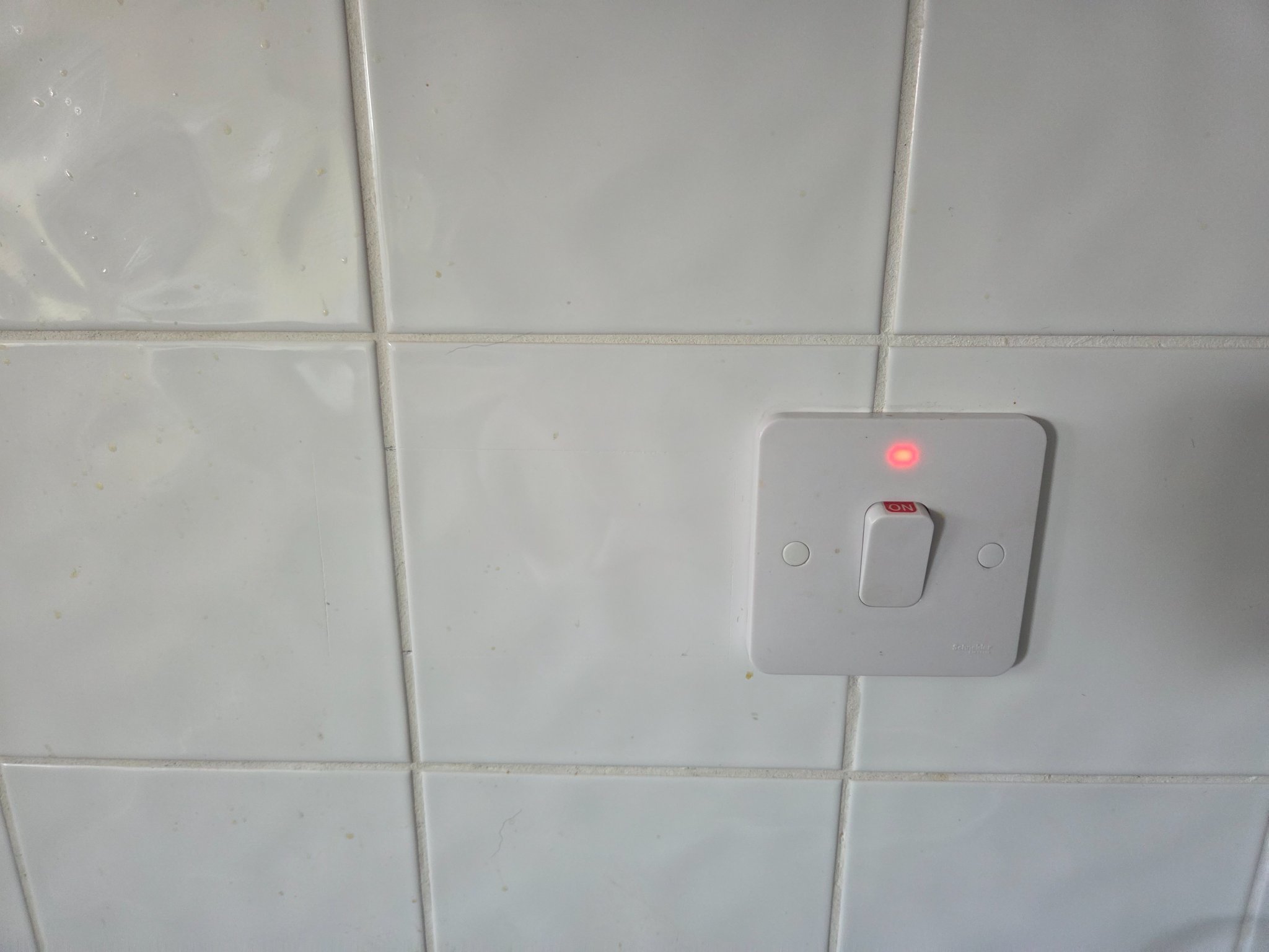

Now, I am getting an electrician to do this, but just wanted verification as I am making the hole for the new back box.
Reason being it is a tiled wall, and the electrician is giving me a cheaper price if i do this myself.
I have verified his request i make a hole for the double back box and nothing more.
I questioned this as would there not have to be a hole for the required FCU as well, needed to take the cooker supply down to the 2.5mm cable?
I don't normally question an electricians request, but being a tiled wall i don't want to end up making a hole that isn't big enough, or worse too big.
Photo shows the cooker switch which I want the double socket placed next to it.
Thanks in advance for replies.
Can't see why not, What size is the oven?
I assume the cooker already has rcd protection?
As long as there‘s no more than one double socket you don’t need an FCU.
Interesting as I thought you couldn't spurs 2.5mm cable directly off 6mm...if you can then this is why the electrician is saying only make the hole for the double socket.
