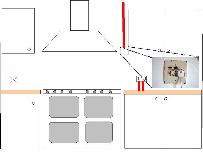

I am replacing an old single cooker with a dual fuel range (gas hob/electric oven) and steel splashback and hood.
The original cooker was supplied from a cooker switch on the wall which also has a plug socket in it.
The drawing shows the layout, and the photo is not of my actual switch but is the same thing (camera has died so found pic on google)
My questions are;
I will use the existing 6-10 mm2 cables to supply the new range oven, but can I also spur from this switch to supply the hood. From reading other posts it seems that people prefer to supply the hood from a ring main?.
If I can use cooker switch can I then also run a horizontal spur from the existing socket to the other side of the range (red x in the picture) to put an additional socket here.
If I cant supply the hood from the cooker switch then i guess I will have to use the existing socket to supply the hood?
If you spur off teh cooker circuit you will need to do it in the same size cable as the existing. As that will be 6mm or 10mm then you wont be able to stuff both of them in the cooker switch.
You'll also have the near impossible job of terminating 6/10mm at the FCU.
Give up on this quest and find a way to run the FCU as a spur of an adjacent ring.
PS Don't forget to notify the local authority BEFORE you start any electrical work in the kitchen.
Could use a dual outlet plate, and run to the FCU from there. FCU terminals should take 2 x 6mm², and as they and 10mm² are stranded then 10mm² should also fit.
thanks for your replies, good point, i hadnt thought about trying to squeeze the cables into the FCU terminals...
Is this the dual switch ban?
http://www.alertelectrical.com/Wiri...asyfit-Dual-Appliance-Outlet-Plate-PRW217.asp
if so i guess i could run from the consumer unit to the dual switch.
Then from the dual switch run a 6-10 mm to FCU and a 6-10mm to cooker switch
then run 6-10 mm from cooker switch to range
1.5-2.5 mm from FCU to hood (havent got it yet so will see what they suggest)?
does this look ok? if so i will make a start :D

It's not a switch - just an outlet plate - it's customary to have it after the cooker control unit.

so CU>>>cooker switch>>>outlet plate>>>2x cables 1. to range and 2. to FCU>>hood

Looking at your diagram, you seem to have a double socket to the right of the range. I would put an FCU there and run the hood from it.

but presumably then, even without using the outlet plate and wiring an FCU to the ring there should still be an RCD for the circuit (CU>cooker switch>range) to comply with current regs?.
im starting to come round to the ring main idea, there is a socket there i can use to spur to an FCU..its just i was hoping to use this to extend to another socket..guess i could manage without that tho...
any suggestions on the best path to run from the socket to the FCU. I am guessing that it would be vertical and then horizontal to an FCU near the top of the hood (close to ceiling or does it need to be easily reached?) and then some flex to inside the hood?. I havent got the hood yet so will look at their instructions as well.
