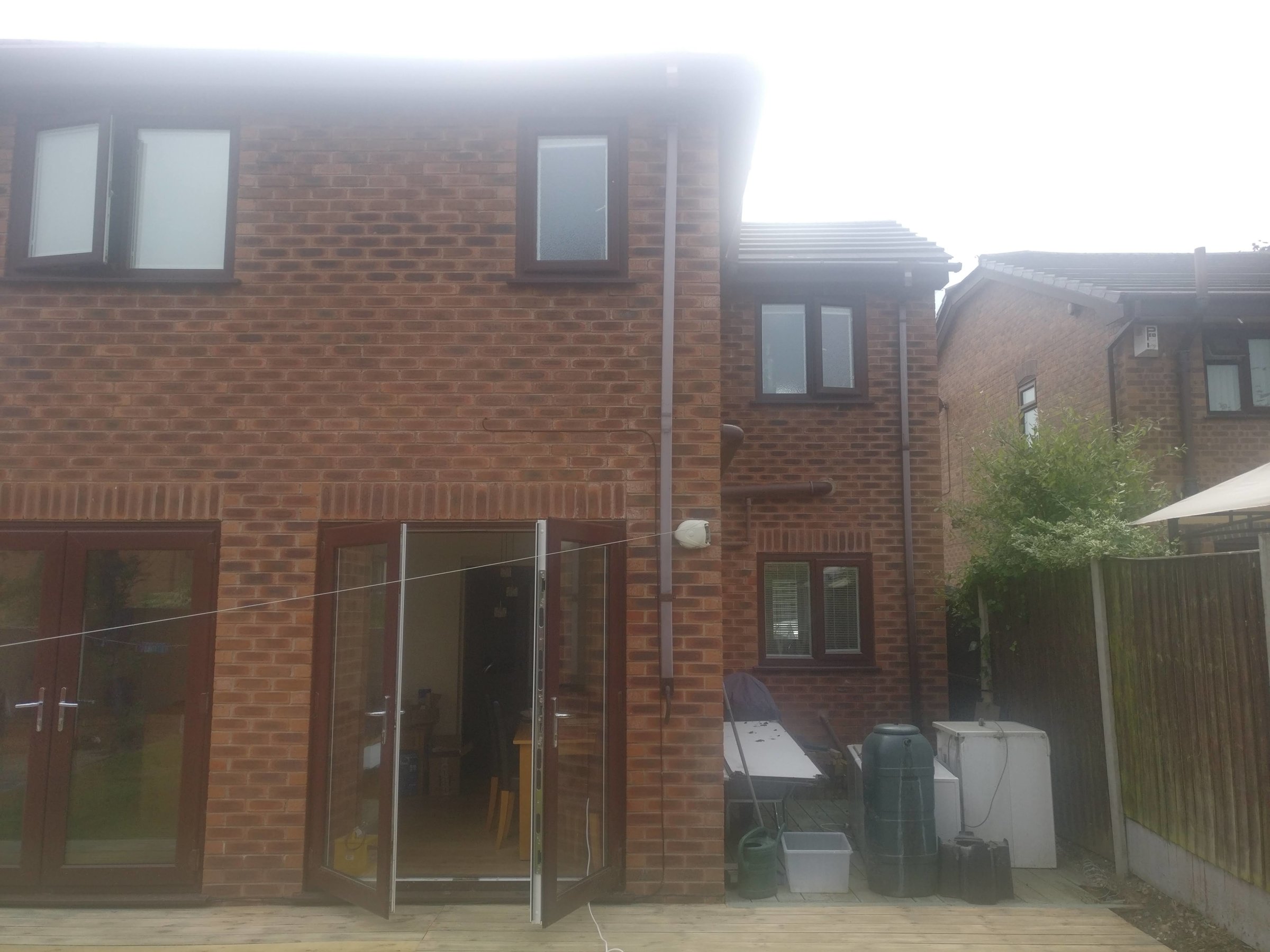

Have a water butt in the garden but previous owners have installed it wrong. The downpipe that feeds the water butt stops 3 feet from the floor with no drain or grid at floor level causing it to overflows leak out of the water butt connection and drips down to the floor (decking) leaving green bacteria, algae etc.
I would like to reposition it to another down pipe with floor drainage or get rid altogether.... The problem....can I cap of existing downpipe? This will leave the pipe constantly full water so is there a better idea...maybe plug it at gutter level.

As you can see. The downpipe to the right of french doors is from the water butt which has been removed for now.
Behind the junk is another downpipe i want to position the water butt there once junk removed and i have sorted that part of the garden. (Its an extension previous owner had done which is wasted space really as not much sunlight etc so going to probably gravel and use it as storage are. Keter storage units etc).
I dont think the fall would need altering as that is the only downpipe running into a drain so water must fall in that direction already.
So, as you say adding a straight section could solve problem. How easy would this be?

I'm talking about removing the piece of gutter which forms the top of the downpipe, replacing it with a short piece of straight gutter.
I guess you'd need brackets under each of the joins. I've only done one guttering job at home here so don't know enough to say how hard it would be for you. You'd need to be safe and comfortable working at that height, apart from anything else.
Another option is to cut the downpipe off a little further up, and add a very gently sloping section of downpipe running round the corner to the butt and/or drain - that would also avoid creating new problems with downpipe capacity, and gutter fall in the wrong direction.
