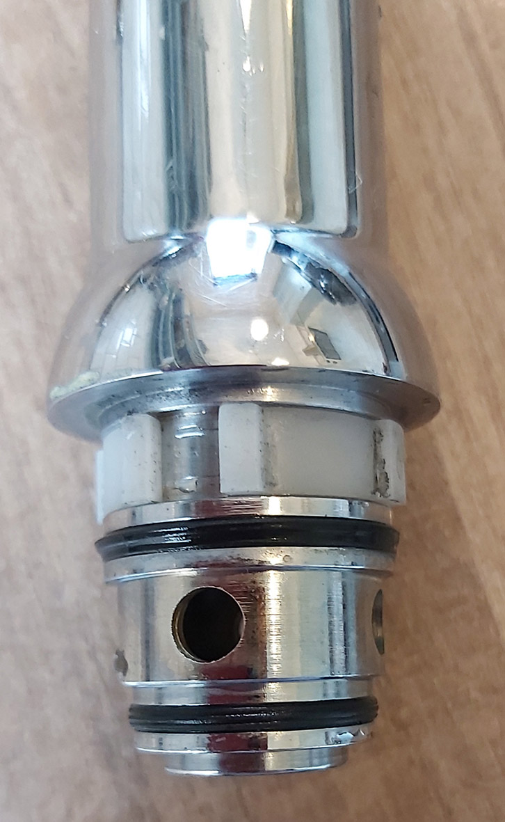

Square O rings?
You might be able to get the tap to reassemble with round ones if you put a slight chamfer on the edge of the hole into which the O-ringed part is fitted. Silicone lubricant and a twisting option may also help but take care not to distort the ring as you twist
