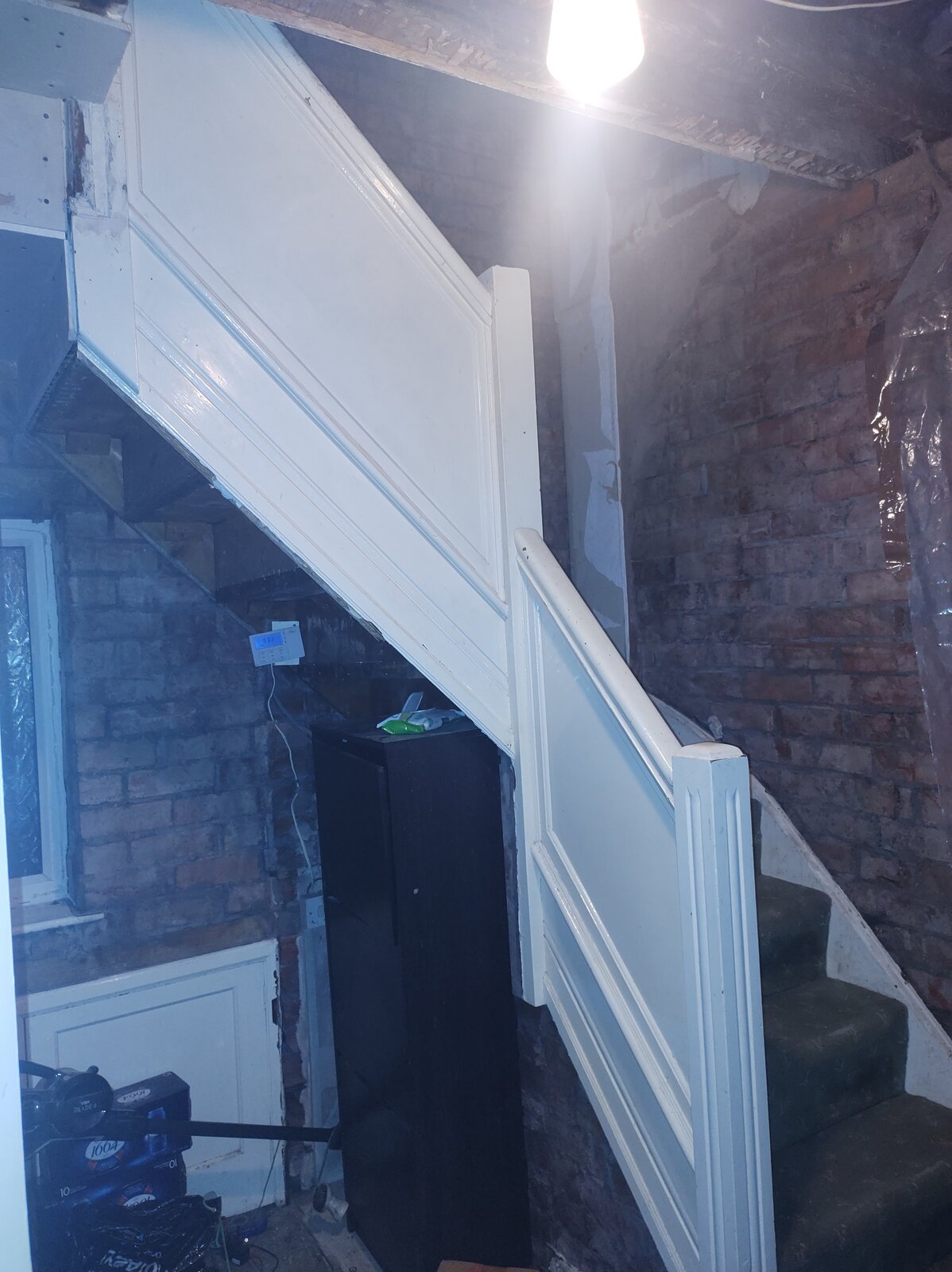

I (or rather my wife) wants stair tread lights so I'm looking for a bit of advice. Currently it's all open and stripped for first fix, I think I want them on the stairs circuit so at this stage is it just a case of looping a cable up to the rose and down under the stairs?
After that is seems to be LEDs in the strings or strips under the nosing but I haven't really investigated - are they some kind of kit with a transformer?
Any advice appreciated. Obviously looking for a professional product not some tat glued on.
I'd plug them into a socket if that was easier. Like the idea of lighting just from safety perspective.
Yep, connect it to the same terminals as the bulb is

Caution; down lighters are easy to get wrong. Take a look at some "good lighting design ideas" type articles and note how few times you'll see downlighters recommended for creating a pleasantly lit space. Add in LED lighting, which is less diffuse/casts sharp shadows and generally less warm, and downlighters can make a lighting set up pretty horrible overall
The pic you've posted highlights this - no offence intended but the lighting looks awful as far as your camera can see, with what looks like a cool white single pendant down light just blasting a stark illumination on everything. Consider how it would change if there were warm white up-down lighters on the walls, picking up the features of the brick and creating warmth and a mix of shadow and light.. I'd also consider swapping the balustrade panels for spindles and ditching the white paint

The area is stripped for rewire, replastering and staircase refurbishment - the bare brick isn't a feature and the horrible pendant belong to the old lady! I'm fully on board with the idea of lighting design but clueless as to how to achieve it - hence a grid/pepperpot approach for the main extension where at least we can swap temperatures and wattages of bulbs/replace spots with pendants/smart bulbs/plug in floor lamps etc when it's decorated and furnished (no access from above so once plastered that's it). I'll certainly check out the article.
