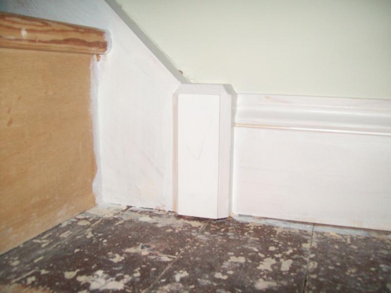

I'm struggling with this. You'd think it'd be simple but my planing skills appear to be dreadful - can't get the top chamfers to "match up" with the side chamfers - to give a nice point. Obviously I'm not able to keep the plane at 45deg when making the cuts. I'm considering having no chamfers on the long sides and just 45 deg on top ( which I can do with the electric mitre saw ). I've wasted a few bits of wood now. Its amazing isn't it, I used to turn, mill and file metal to really close tolerances during my engineering apprenticeship, yet I'm beaten by a plinth block and hand plane :cry:
Don’t you dare tell me you are giving up. Do i have to hold you hand ?
Mark the 45 deg chamfer on both sides and on the face and just plane to the lines. And the cut the top chamfer last taking it off a little at a time.

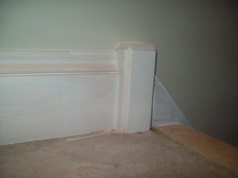

I gave up! awbcm bailed me out and he kindly sent me the plinths through the post in return for a donation to a very worthy charity..... it was just breaking my heart ( and bank account ) to waste any more wood, just couldn't get those angles right with a hand plane :oops: .
Thought I'd post the piccies ( half way through painting ) just in case anyone else needs to see what a quality plinth block looks like.

Ginga - looks good, but is that still that short bit of skirting on the landing, or did you forget to use your wide-angle camera lens? :lol: Think about that BEFORE you get into the shower :lol:
Yes Symptoms,the wide angle lens feature has miraculously stopped working on my camera since my last photo effort.......(and your associated hurtful comments about my measuring skills) :wink:
