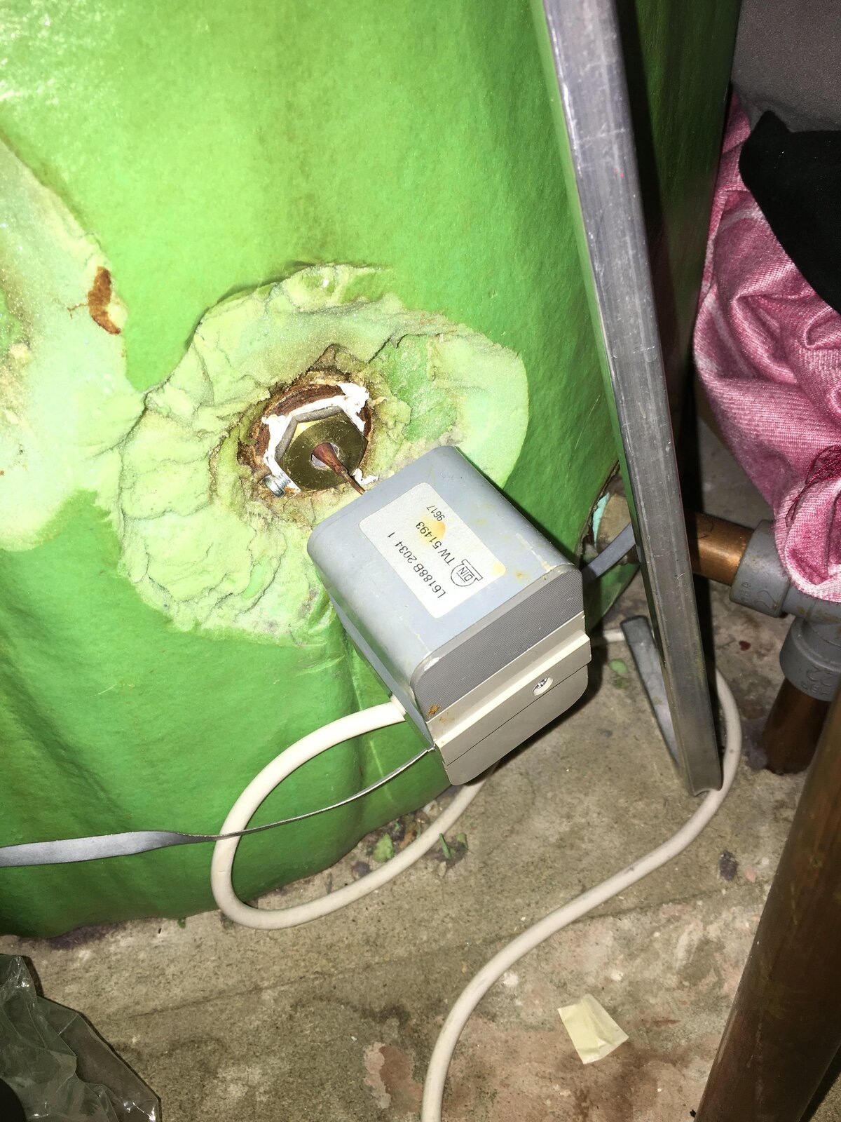

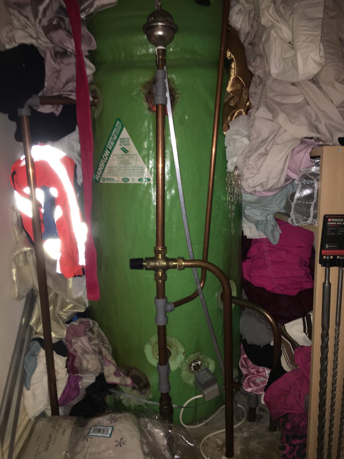

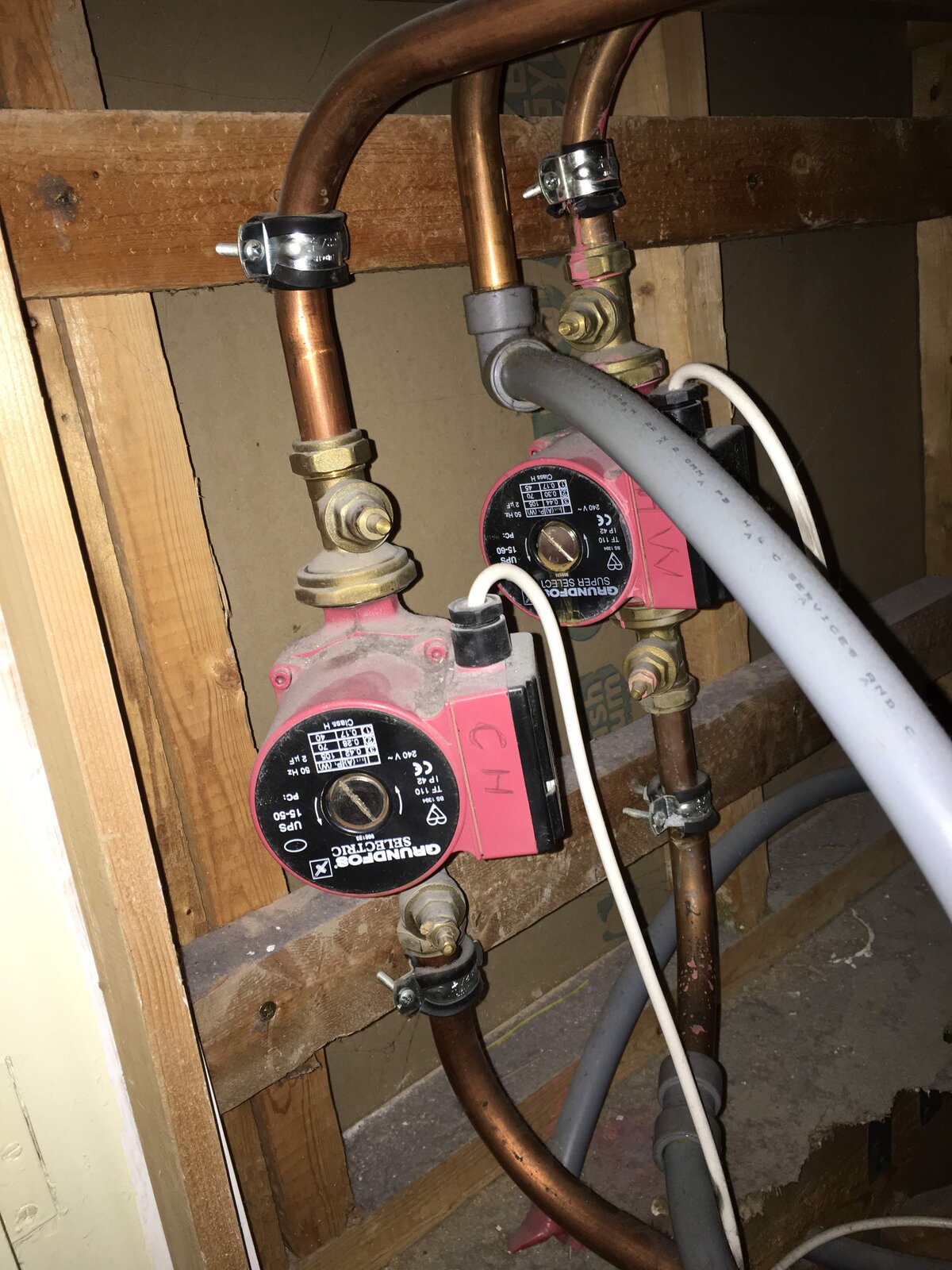

Also, could you post a couple of photos of your heat store?
Hi, pictures of my heat store.

Great, just wanted to check what it was. You can have a combi boiler to replace that but you may find that you get a significant drop off in hot water performance - possibly as much as 50%.
