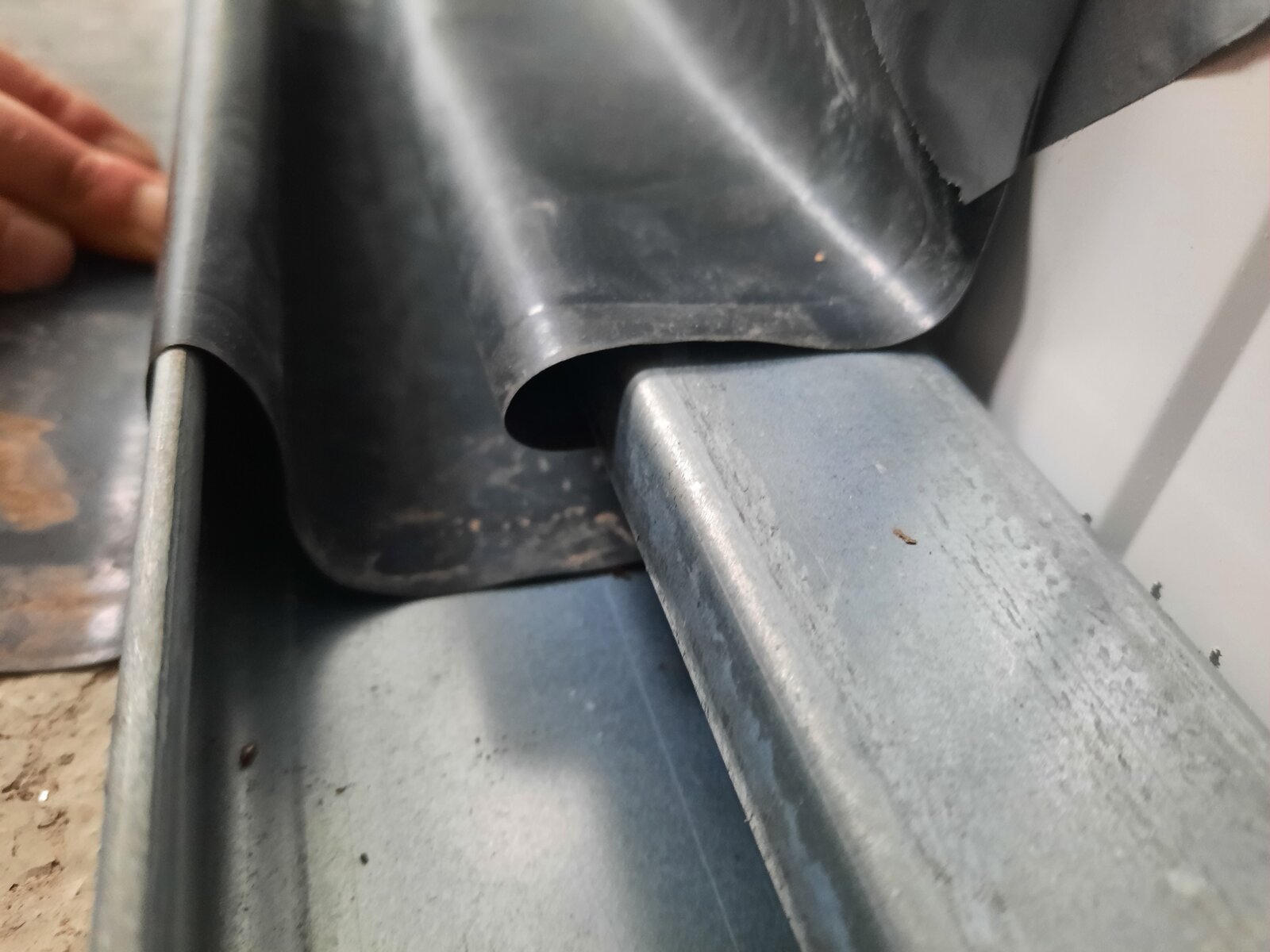

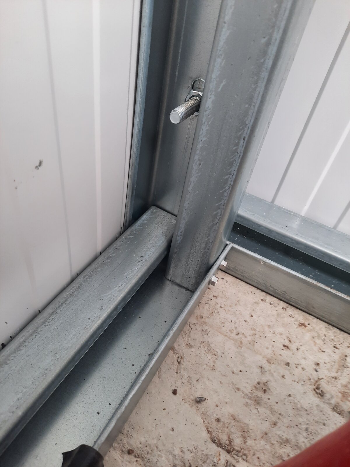

Hi,
Im doing 3m x 5m steel shed base in 2 stages
Stage 1 was strip foundation.
Shed was put, now I want to pour floor inside.
I imagined I will lay out DPM and tape up against the walls and pour concrete over.
The problem I have is metal shed profile. Its hollow inside and 45mm high which I about the hight over foundation I wanted to pour.
I cannot figure out how to lay out plastic.
I don't want to leave it hollow so I can stand eg shelf there and I wanted to seal to the wall to keep moisture away so I was thinking to put DPM inside and pour 1cm over profile height like this
Would you have any better ideas?
What does the outside look like? Do the panels come off the frame?
Steel panels sit on top of strip foundation so currently, without the the floor, you can see some wet spots inside when it rains
