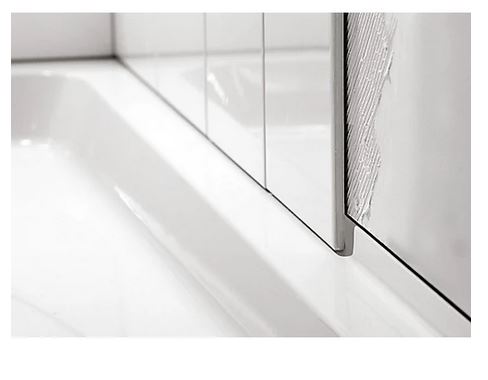

Hi all,
I'm looking for a shower tray for our shower room renovation. I stumbled across the reassuringly expensive Bette steel shower trays as they happened to be the dimensions I was after (750 x 750) which would fit perfectly into our existing niche, once I've boarded etc. All other trays seem to be 760 x 760, and then I'd have to have the boards come down over the edges rather than behind....
I also quite like the idea of a tray that essentially has no risk of cracking so was tempted by a steel one anyway.
This is the one I was looking at.
https://www.bathroomsuppliesonline.com/bette-ultra-750-x-750-x-25mm-square-shower/
Getting any kind of response from Bette support would appear fruitless when it comes to asking anything technical, and the installation instructions don't really help that much either- is there anything special about installing these trays, or in fact easier than stone resin as there is less risk of cracking? Can I just place it on the [secure and level] floorboards and then just tile over the edges/seal as normal?
Any advice would be much appreciated.

Boards need to over hang. Behind is likely to cause leaks .
Yes I have 2 mira flight trays that have up stands the boards are cut to allow the trays upstands to push flush with the face of the boards, the tiles then go over the up stands to the bottom top edge of the tray body leaving the last 5mm for silicone.
Right. I thought it was regarded best to have a tray up against the backer boards rather than leave a void, and then tiles which will obviously overhang the tray edge by around 10mm i.e. thickness of tile/adhesive?
The mira ones with upstands fit like this
You can get them with either 2 upstands or 4 upstands so all the way around which is what I have got so that the cubical sits inside the upstand and is impossible for it to leak under the cubical. I left a 10mm gap between the glass and the up stand to allow cleaning
ah yes that does look like the ultimate leak free solution.
With this one, having redone my measurements I essentially have a choice of 6mm hardie on 2 of the shower niche walls (I will put in loads of extra noggins so centres will be reduced, to make sure it is rigid) into which the tray will slot in almost to the mm, or 12mm which will overhang the tray by around 6mm.

No void with usual methods .
Steel enamel? IMHO That will eventually get a crack in the enamel and then you get rust.
Because the enamel will be done very thinly - because that's the way it's done these days, to the bottom dollar.
Have you actually seen this happen with a decent quality steel shower tray or just hypothesising?
