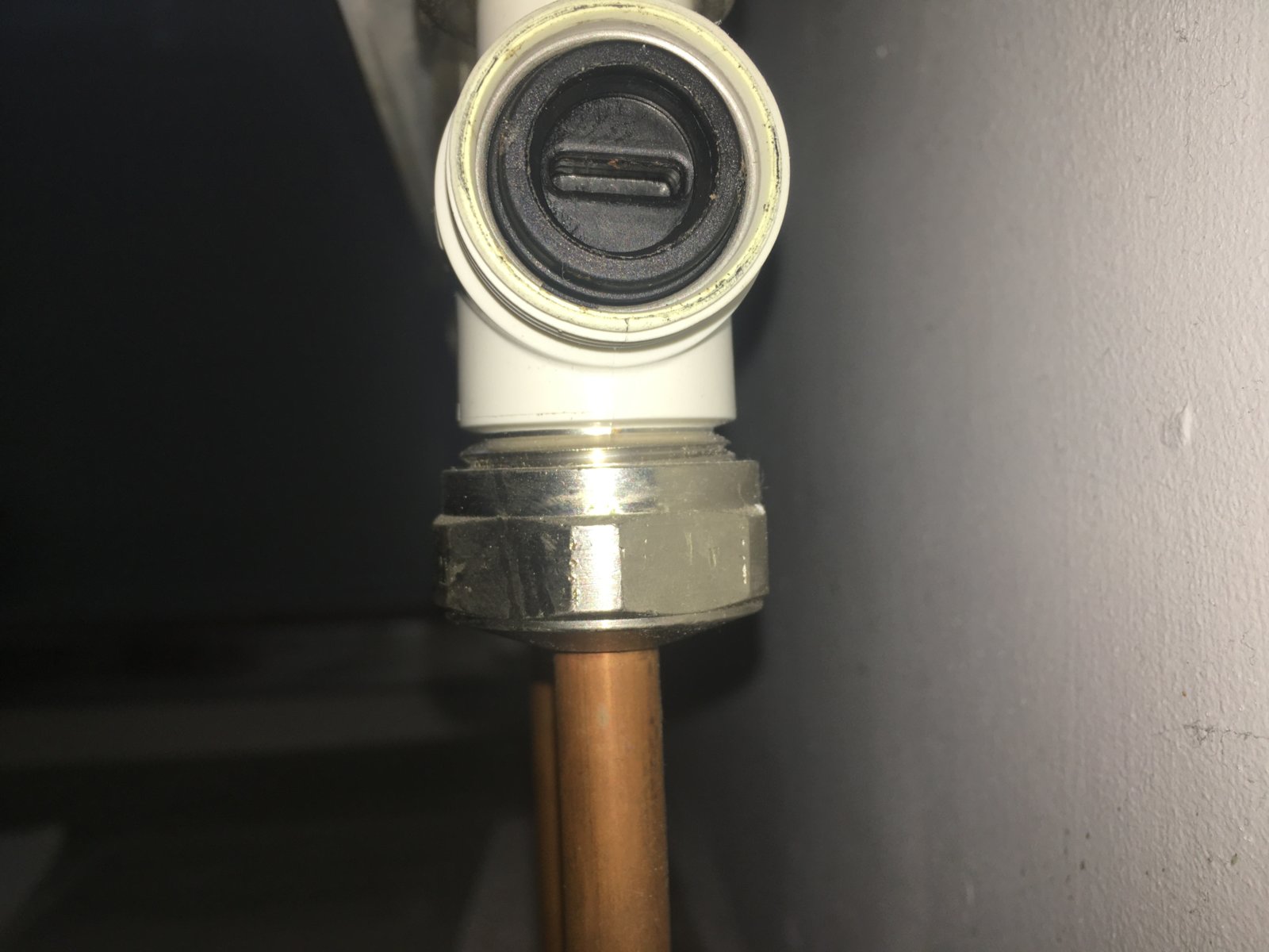

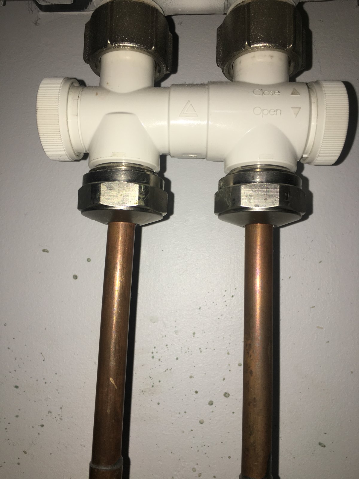

Hi, I have phoned Stelrad but their technical department are on Furlough.
We have one of the centre fed radiators in our en-suite (which aren’t available any more) and it is supposed to be easy to remove which I want to do to fit skirting.
Do I just turn the black thing to closed and remove the other cap to drain once closed?? (Releasing the bleed valve at the same time)
Thanks in advance
Steve
To answer my own question - isolate valve on the right (under screw on cap). Slacken off bleed valve. Remove cap on the left and push on the plastic (I used a removable bit screwdriver without a bit) - obviously have something to catch the water
