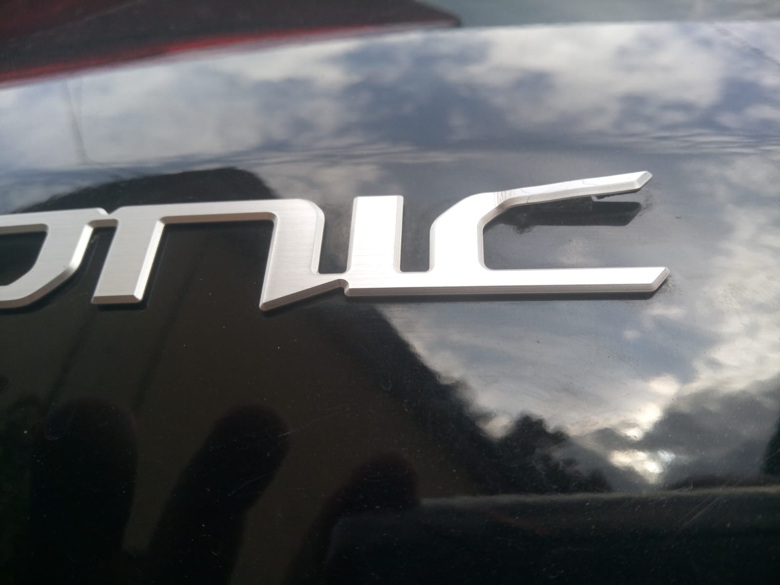

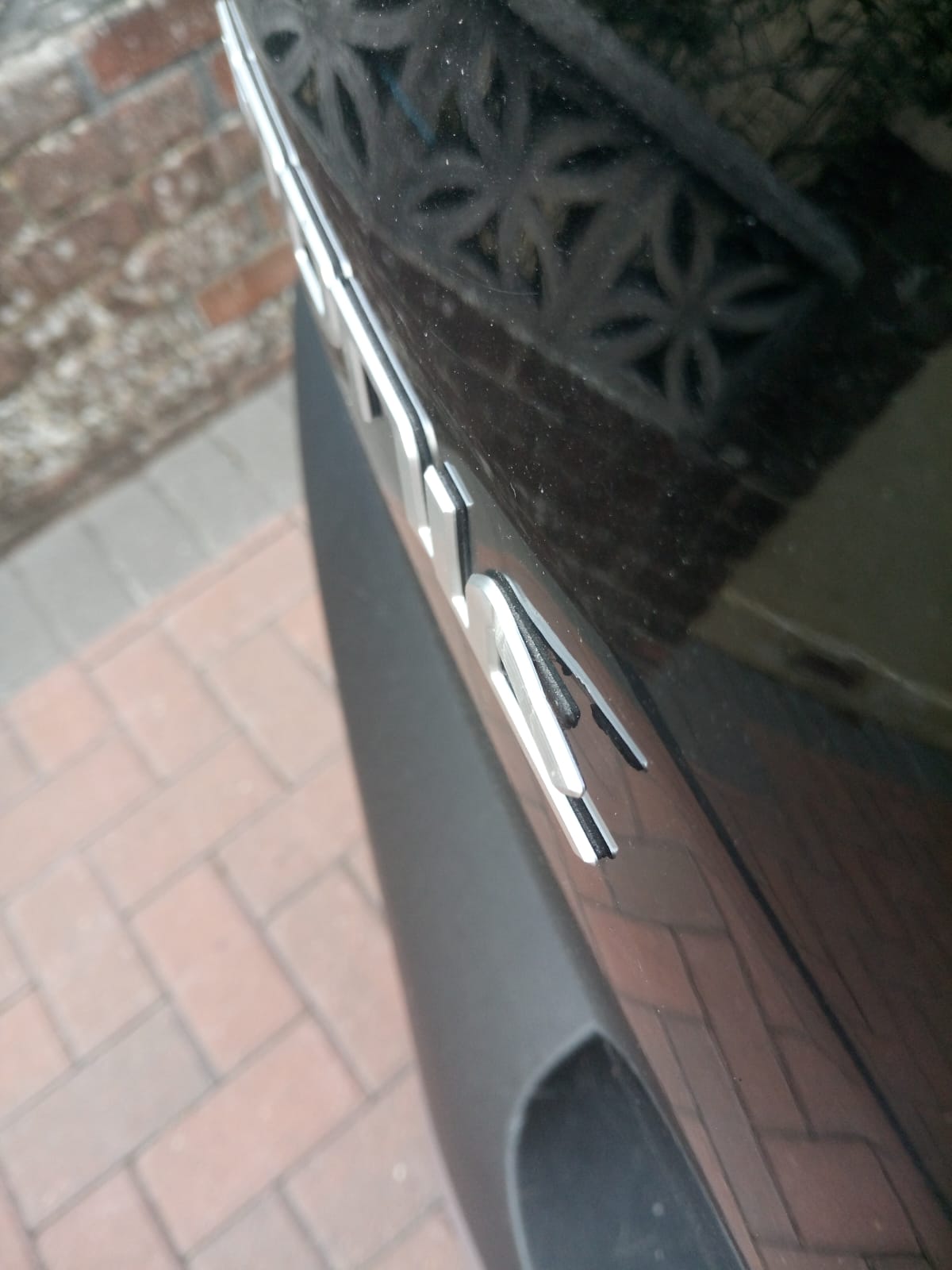

The badge lettering obviously caught something (carwash?) and is now a potential flesh-stripping hazard.
The pics show the stress lines in the top of the final letter making rework a bit problematic.
Any suggestions as to the best way forward? Hot air gun and removal? Another bit of double-sided tape and hope? Break the thing off, so she's driving a STONIL?
Its her car, and she doesn't want to pay what she's been quoted. I guess I don't want to use superglue. It'll go everywhere and be too permanent.

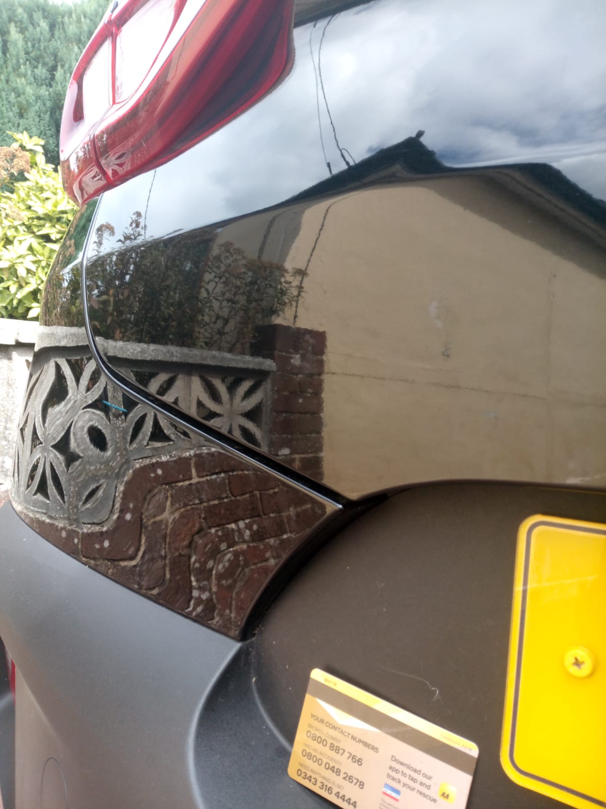

Thanks for all the suggestions. The hairdryer low/med setting was more than adequate. It was a muggy day so a bit of a head start.
The dental floss would have worked but was a bit slow and needed a third hand. Ended up using an old AA plastic membership card (see pic) in a prying rather than slicing action. A bit of WD40 to remove the glue residue and a bit of spray polish....
Not sure the old badge is likely to be reusable after reshaping. The very thin letter joins make that a bit touchy, so I favour the leave it as is suggestions.
