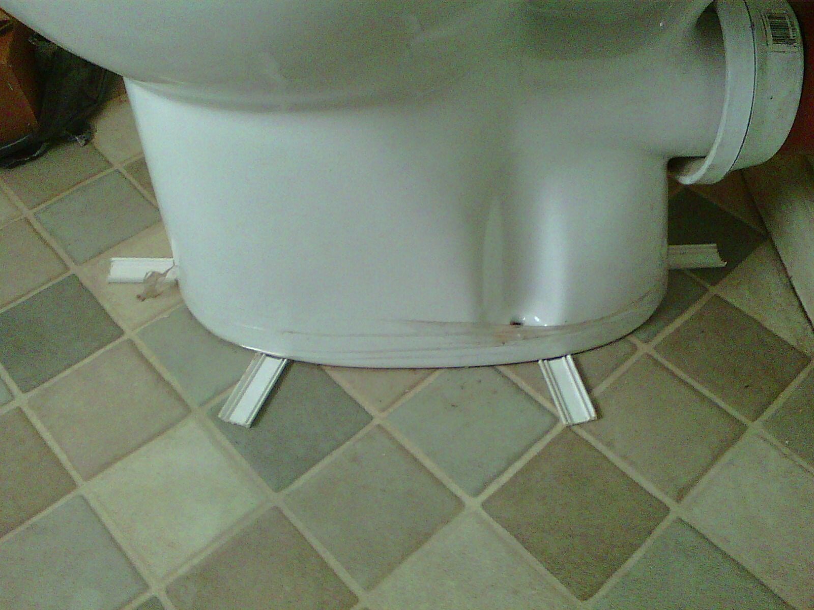

Well, so this is the plan......the toilet pan is in situ, so once I've removed the cushion floor underneath it, lift it a few millimetres (6mm) ?
and apply the Sticks Like **** around the underneath of it, then gently lower the pan down onto it, and leave to cure.....luckily I haven't bricked the hole up yet, where the soil pipe goes through the wall, so it allows for upwards movement......does this sound feasible ?......
I'm just wondering if these spacers are thick enough ?.....
I suddenly realised, that with using those thin spacers, I wouldn't be able to get the bit of cushionfloor out from under the pan......so using one's about an inch thick, anyway it's out now, just got to get the sticky
stuff and we can get it stuck down........
