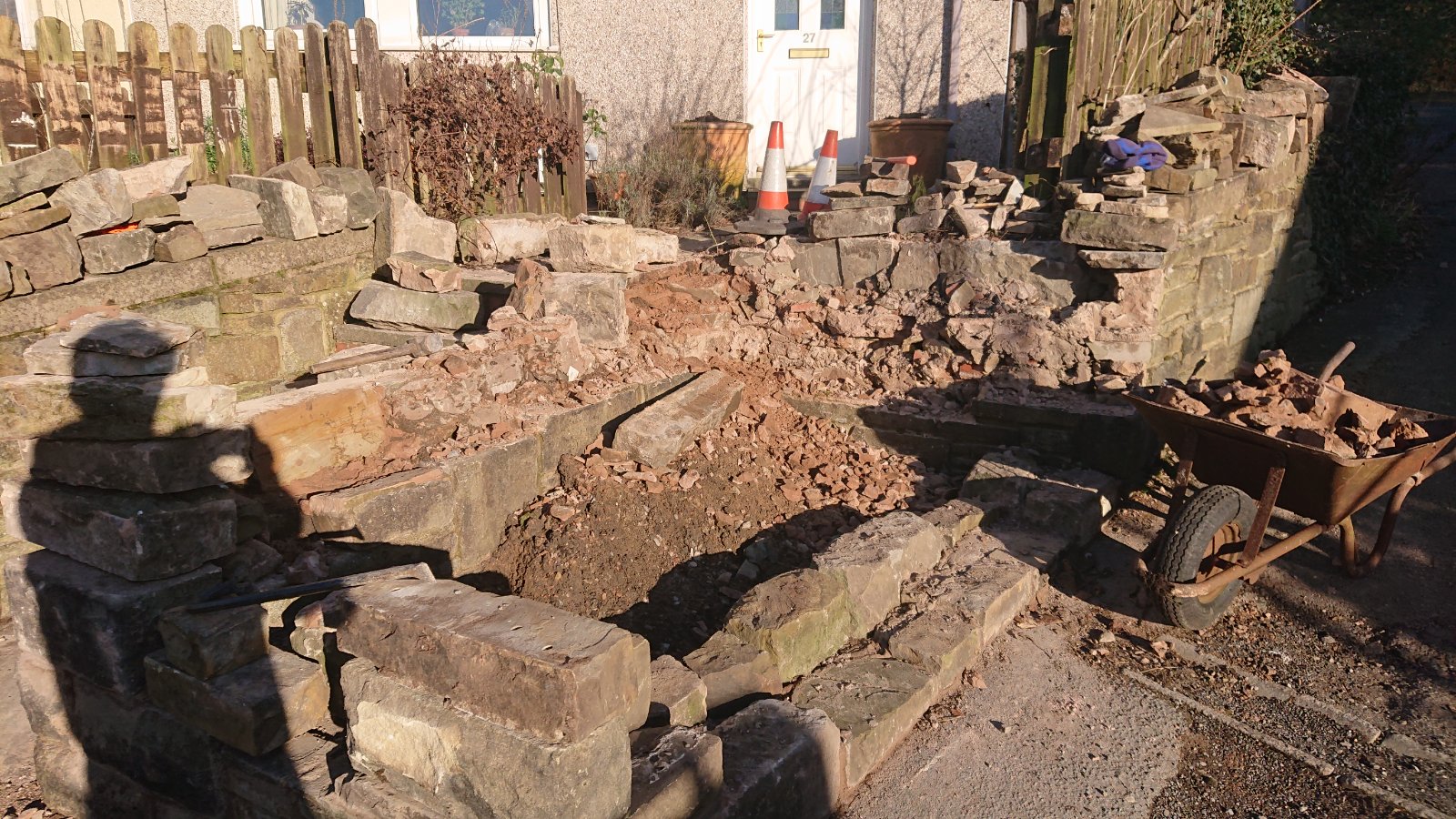

Hi just want some opinions on a stone wall I am building in the front garden. I am getting a bit confused if I should be using lime in my mortar mix ? Its just going to be a flower bed on top . The wall will be 3ft high by 16inch wide
I am using 4.5 red builders sand to 1 cement which I think has been used on the other section of wall I am joining to, I 've put a weeping pipe in for drainage and will be back filling around the back of the wall with rubble to aid drainage . Stone is some Yorkshire stone I suspect which is a tad soft compared to the rock hard local stone.

You can use lime as a plasticiser, but no need to use lime mortar.
For a cement mortar, no stronger than 4:1
It's often advantageous to use either a sharp sand, or part sharp sand mix to toughen the mortar to compensate for a weaker mix. Sharp sand also removes the brown shade of red building sand, and this can look better with stone.
Or you can use white cement with the grey cement.
