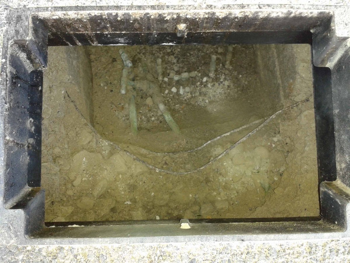

Close - we have an outside stop cock that some idiot has tarmacked over! Yorkshire Water were here this morning with metal detector etc. and we think we may have found it but it's been passed back for a bit of digging and that probably won't be done for another week. We do have a meter but it is immediately after the dodgy stop cock within the property, and is part of the reason it's such a pain to get to the latter. Its a flat and both live in a void with a 1ft sq access panel and loads of other pipes. I've opened the access up to fit a larger panel but it's still far from ideal. So I can't really do anything until the outside stop cock is located anyway.

Well, finally got the OUTSIDE stop tap saga sorted courtesy of Yorkshire Water. Looks like the prefabricated concrete front of the chamber has been smashed by a digger in the past (the exposed steel rods look like they would have been steel reinforcement), and whoever did it, just filled the chamber up with rubble afterwards, and it was then covered in tarmac. Thankfully, the original chamber lid was also buried just a few inches away and it was that which YW were able to pickup with a metal detector. So at least I can get the inside stop cock done now, once I work out which of the six is mine.
