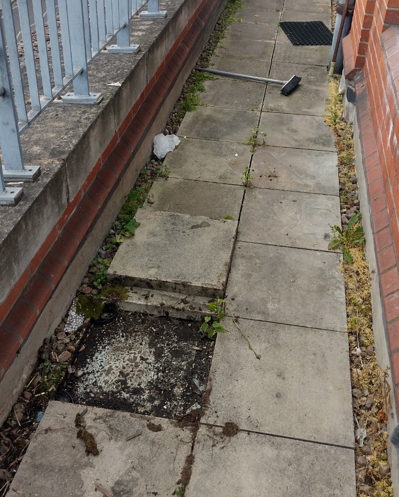

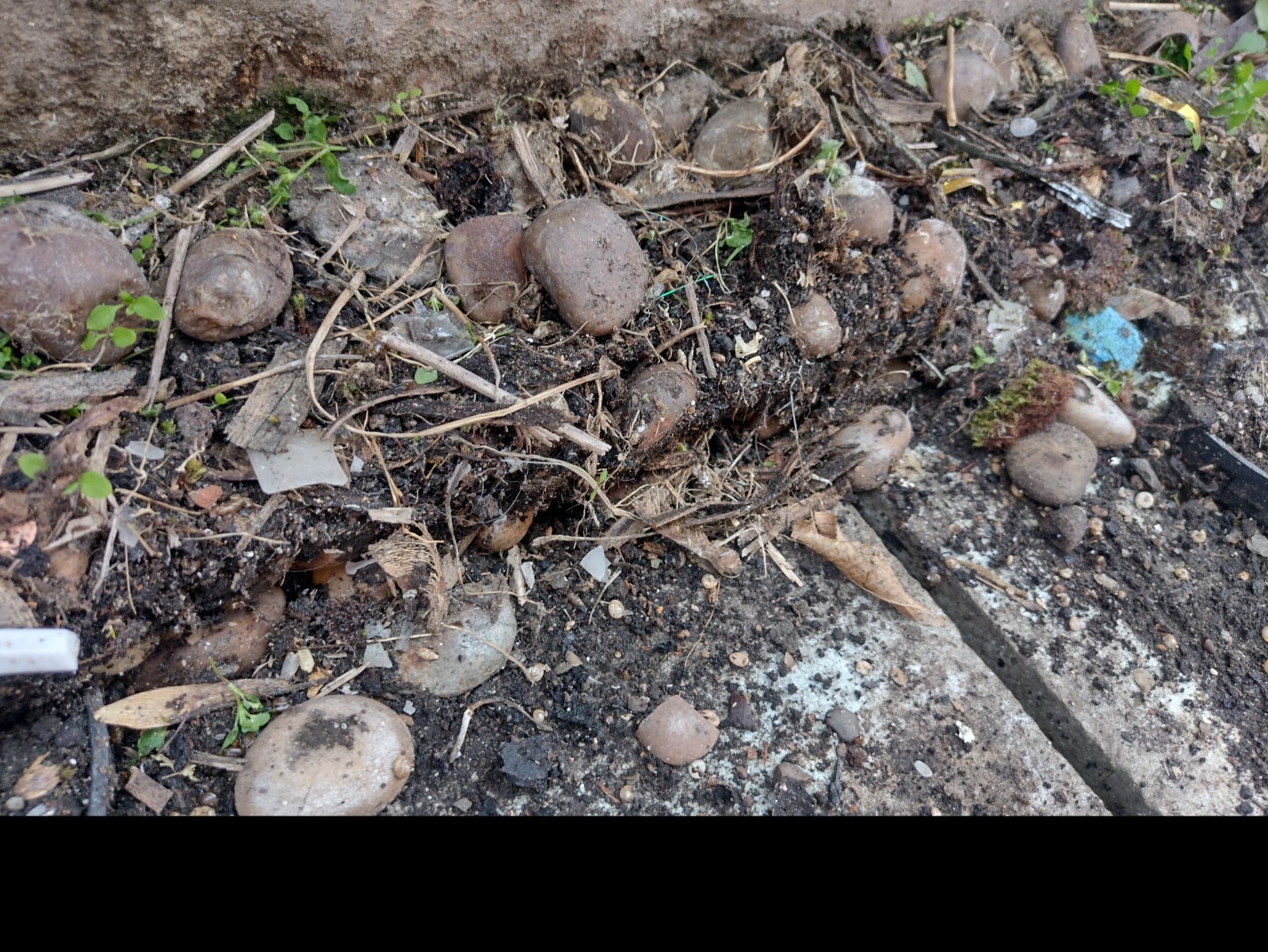

Paving stones on balcony have weeds coming through.
Need advice on effectively dealing with this.

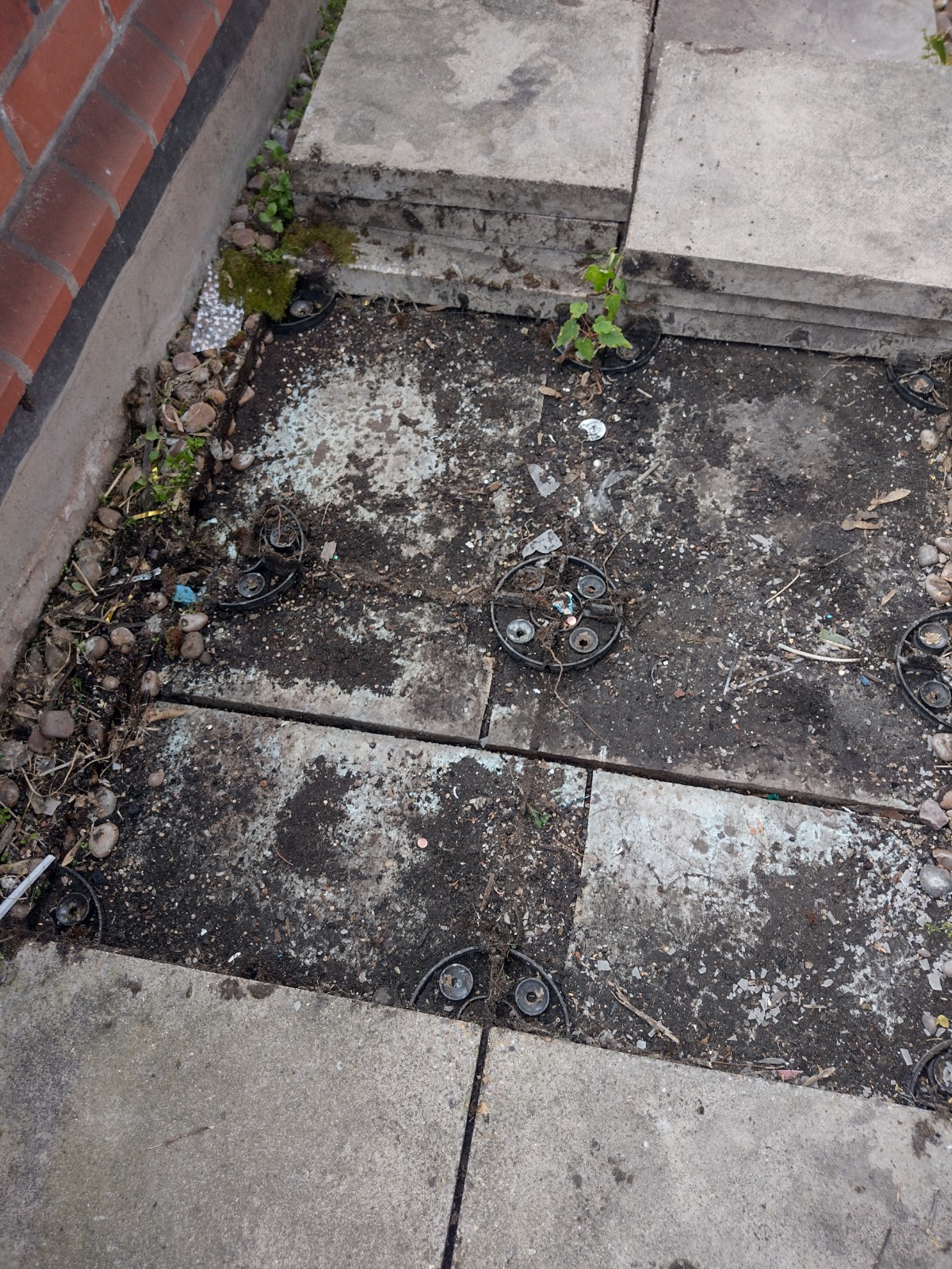

After lifting the paving stones, I notices that they were laid on some sort of foam
Can I just
1. Sweep up the organic matter from the foam
2. Lay a weed membrane over the foam
3. Relay the paving stones
4. Fill gaps with kiln dried sand
5. Clean organic matter from the gravel stone and relay
or do I need to do something else?

Weed membrane wont do anything here. They are growing in the dirt on between the slabs. Even if you took that out there will still be trapped moisture under the slabs that will be enough for some weeds to survive on.
By all means clean it up. But in the future, regular weeding or spraying will keep them in check.
Not sure how sand would work here when the slabs are effectively suspended on those bearers, I suspect they have been designed that way to allow for drainage.

You either fill it solid i.e. with sand cement or polymer pointing and take the risk water may pond everywhere or you leave it as it is and go out there and keep it weed free every other week. The UK is a green and pleasant land and will totally ignore your pleading for it not to grow weeds. You have a Garden of Eden there and the weeds know it.
