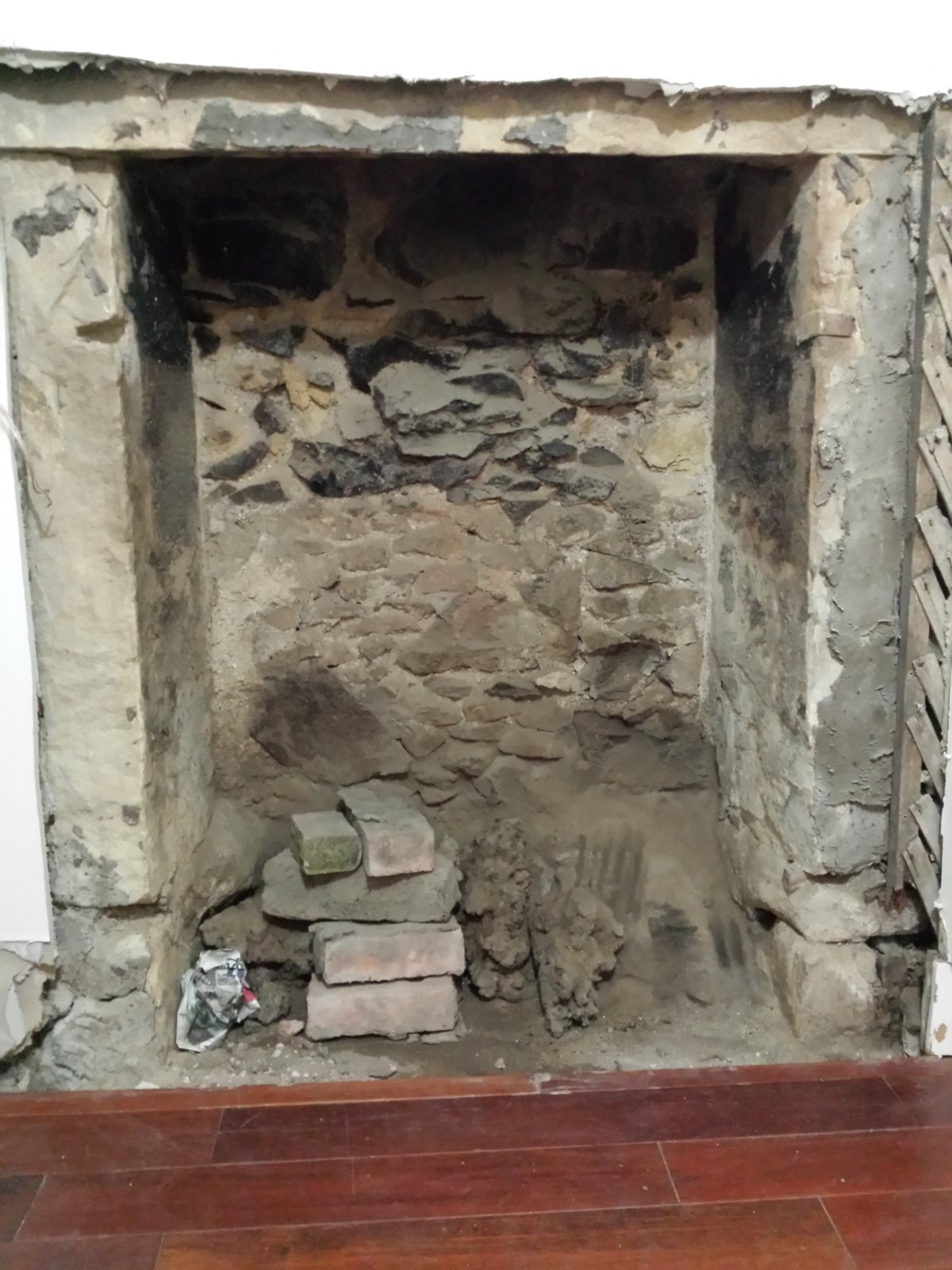

I had been thinking of taking that wall back to stone, insulating and re plastering so I might wait and do these things in conjunction. I have a new problem to deal with now as I have found out, referring to the picture below, the slop on the right which I thought was some kind of historic fireplace thingy, is actually a concrete slab, cemented in place to provide a path for an underfloor vent. Quite funny that I was staring at this thing for so long wondering what kind of historic function it had in a fireplace when its turned out that it was probably installed about 30 years ago. Obviously when blocking up the fireplace many years ago they decided to use the fireplace to add a vent and have butchered away the hearth underneath this too! As this vent is only just above ground level, and it needs to go down at this angle to get under the floor, its brought to my attention that the floor of this room, and obviously the joists, are below outside ground level which highlights a completely separate problem and why the room as had a historic dampness problem.
Old houses! $#$£# :)
