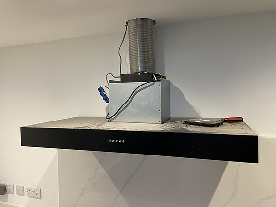

Hi, can anyone help with this?
My new Stoves Sterling cooker hood 444410831 has 150mm cylindrical trunking which reduces after a 90 degree bend into box trunking 200mm x 60mm, then out through a tile vent.
The reduction in flow is about 33%, which doesn't sound a massive amount.

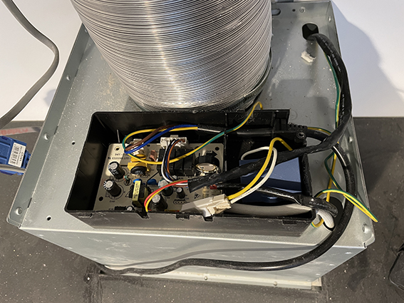

When the extractor is set to minimum there is a sensor that detects the reduced flow and sets the fan to maximum output. This is very noisy and annoying!!
I have read that it is possible to reduce the power sent to the fan using a potentiometer or resistor.
Has anyone done this and if so how would I find a technician to do this work?

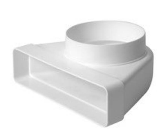

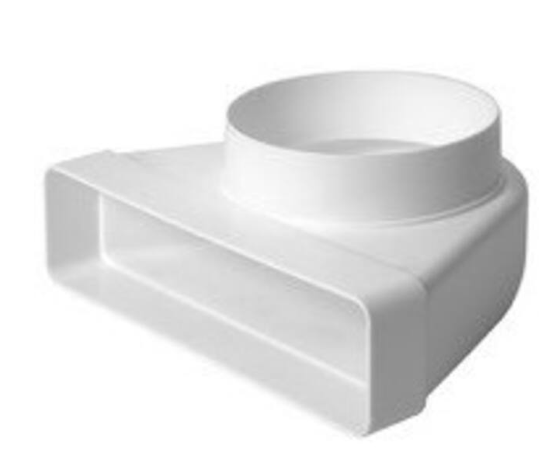

Where the trunking goes through the ceiling this 90 degree bend is located (the other way up) converting from 150mm circular to 200mm x 60mm rectangular.
Yes that is where your problem is. Is there space to go bigger that 60mm tall.

if your only option is to tinker with the control circuitry, I would have thought disabling the sensor would be simpler.
No idea.
Motor speed controls use electric wizardry. It might be measuring load on the motor caused by obstructed flow.
A circuit builder can buy ready made control circuits, but not something I know about.
