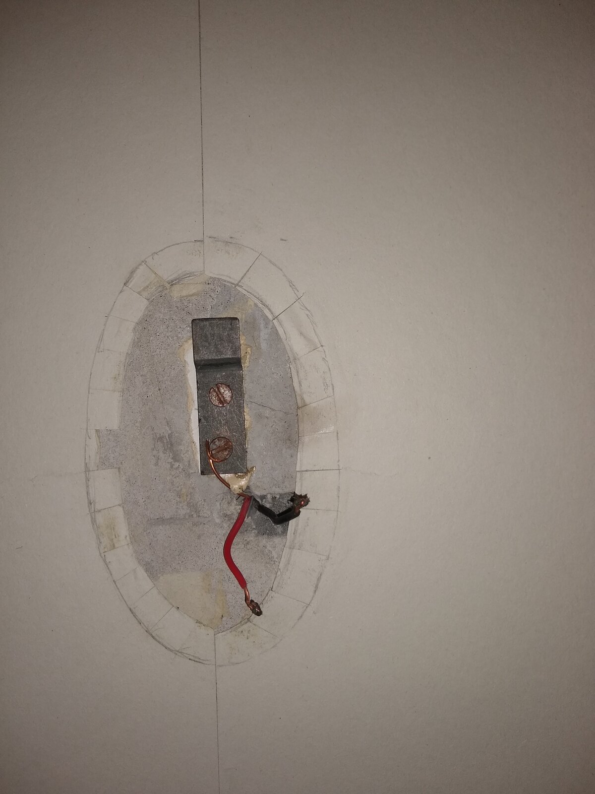

Hi all -
I have 2 wall lights and each has 2 bulbs – they both operate from a single wall switch. The wiring concealed behind the lights is in very poor condition and insulation has dropped off in places. Recently I slightly disturbed one light whilst decorating - there was a small flash and the mcb was tripped. I have now removed that light - there were thin insulated wires going off to each bulb (in poor condition) and these were crudely joined to the incoming cable with insulating tape. The incoming cable emerging from the wall is just a red, black and earth wire - the red wire is live regardless whether the switch is on/off. Obviously the 2 wall lights are interconnected but I now also find the other wall light remains on all the time regardless whether the switch is on or off? I have not disturbed the other wall light or examined the wall switch but can do so if necessary.
I will be grateful if anyone can explain this and suggest how the failed wall light was wired to the incoming cable and the other wall light?? (A diagram would be most helpful!).

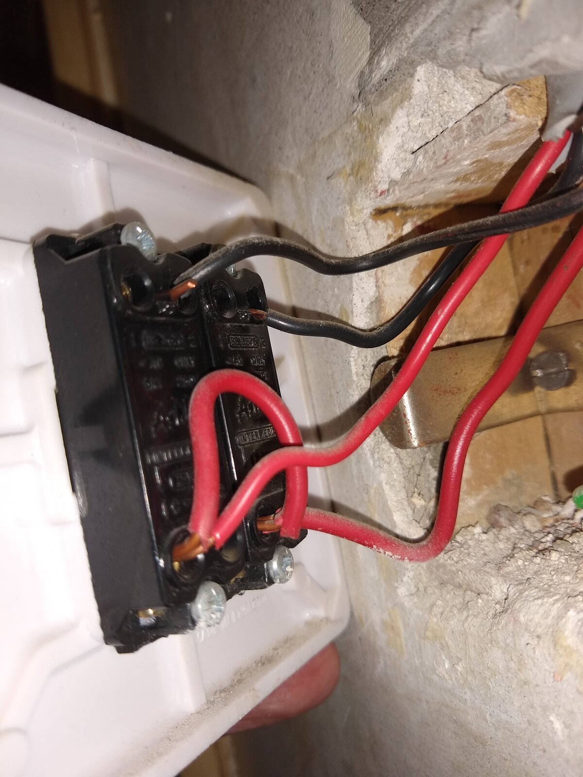

I am no sparks, but I suggest the contacts on the switch are fused together.

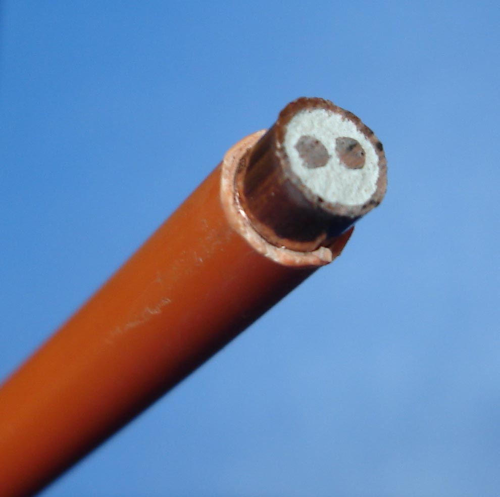

The use of conduit (tube) was common with older homes, pre-1966 lights did not need to be earthed, and even when twin and earth was used, often the earth was not connected, and it could be wired in singles, not twin and earth, there is also mineral insulated, unusual in houses, normally only used with stone building or high fire risk buildings, upload_2022-3-24_10-24-6.png seems unlikely you have this cable, to be frank even as an electrician I would get some one use to working with it to do any work, it depends on a good seal at ends, and not a DIY job.

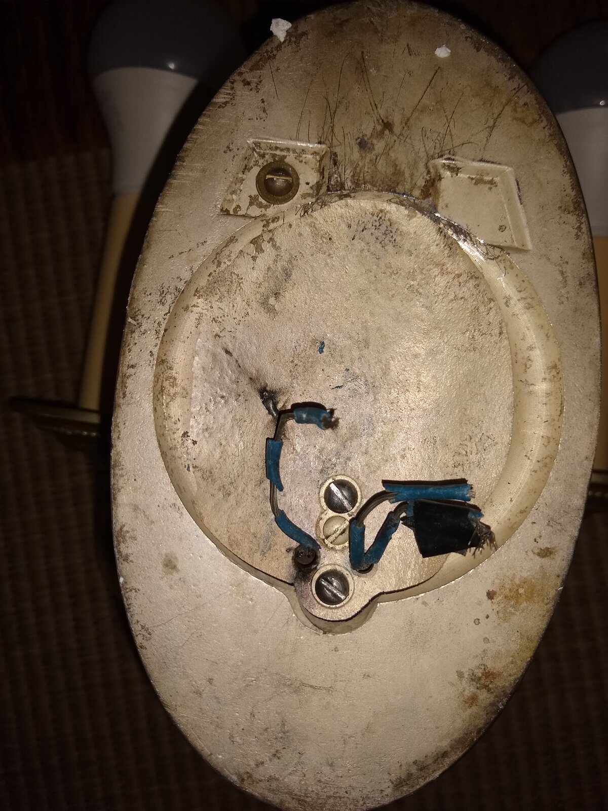

To be honest, because of the poor state of things, I've taken photos but they're probably less revealing than my written explanation (not sure if I should've inserted photos as thumbnails or full images?). The cable emerging from the wall is sheathed and comprises insulated red, black and earth wires - these all seem sound. The hollow metal tube going off to each bulb is S-shaped and I doubt any sheathed flex/cable would thread through so I'm thinking the outer sheath would need to be removed and 2 individual (insulated) wires used if this is deemed safe to do? - it's presumably what was originally done.

The cores appear to be PVC insulated so I think the degradation will be due to heat from the lamp. Use sleeving on the exposed parts. Use LEDs in future, which run cooler.
I think that if you remove the lamp you will find very little degradation behind, but you should sleeve it.
It's possible that scraps of old wire were used when fitting the lamps, especially if they were second-hand or re-used.

I'm not sure if the cable in the wall is in conduit but my main concern is the wiring from the ends of this cable through the wall light to the bulbs. I doubt the wall lights were secondhand and they probably came wired up to each bulb. Because there's only a shallow recess to cover the wires some bodger obviously decided to join up the wires and wrap in insulating tape. Possibly small connector blocks would be better and safer, or heat shrink?
I have another pair of wall lights on the opposite wall – these and the offending ones use a 2-gang wall switch. When I switched the wires around the (remaining) wall light on the offending wall switched on and off ok. Which suggests (as footprints said) the dodgy wiring at the wall light fused the contacts on the wall switch. That remaining wall light has equally suspect wiring and needs sorting.
