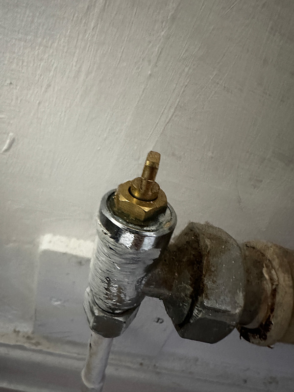

Since we had a new boiler installed I am struggling to balance the radiators - they will be fine for a few days or even weeks but eventually go very tepid.
Because they are tepid It's difficult to work out which order they run in.
I have just brought some digital thermometer clips and plan on trying to get them all with a 12 degree diference but unsure which side I should adjust as on many radiators the screw looks the same - only one is usually covered with an old school +/- nob - I believe that is a manual valve and the lockshiled is the opposite side to that?
I thought the lock shield was the outlet and would be the cooler side, but on some radiators this seems to fill the radiator and is generally hotter!
So confused becasue all the YouTube videos are based on rads with thermostatic valves and we have none!
Balance using the lockshield.
Post photos of both valve types please.
The idea of the lockshield is that the plastic knob is just a cover and does not adjust the valve. You take it off to turn the spindle. So nobody fiddling with the knob later will upset your balancing.

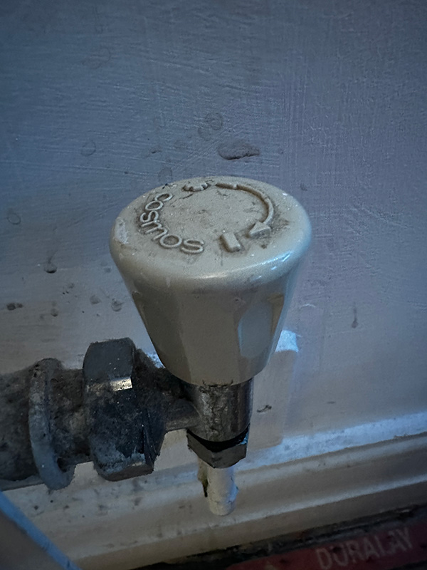

All of them have these as both sides - expect 1 radiator which has a flat type screw.
Half have one side like this (which is the same as above underneath)
Some have a white cap over one side which I assume is the lock shield but who knows as underneath they look the same.
one or two have drainage pipes coming off them.
The valves themselves are the same. It is only the absence of a knob that makes it a lockshield.
The ones without a knob appear to be the ones that control flow into the radiator.

Doesn't matter. The knob is the only difference on yours. You can move it if you want.
If you have TRVs, it is an advantage to put them on the flow side to prevent chatter. But you haven't.
Doesn't matter whish valve you use to balance if you only have turn down valves, as long as once it's set it isn't changed, hence the reason that the lockshields are used.
It also doesn't really matter which is flow or return as both restrict the water flow in and therefore out of the rad.
The valves that have the turn head on them leave fully open and turn the lockshields off on all the rads, then start blancing from there.
