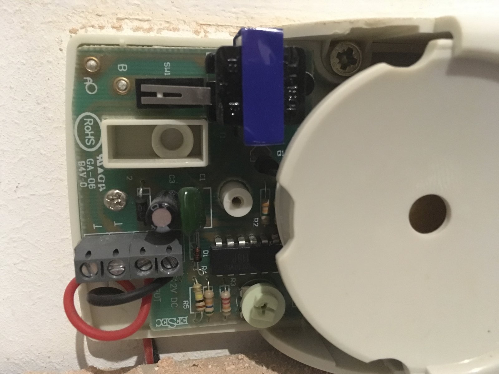

I just remembered that i have the internal siren from my old Bosch alarm that used to be installed, that has two cables, black was to GND and red to NO on the original Bosch board.
Could you please tell me which connectors on the Enforcer io board i would connect the two wires to?
If this works, that would be good. if not, i will just go with sparkymarkas idea of the Pyronix twin alert int sounder.
When an alarm engineer talks of a cable they mean, 6core, 8core, 12core or larger sometimes - NOT the individual cores inside the cable as in red, black, blue, yellow etc (that's a 4core) + green & white, that's a 6core
Depends on the current requirements of the Bosch sounder as its limited to around 250ma on the enforcer
I just went to check the retired alarm system, and even though the system was Bosch, it looks like the sounder that was attached was from a company called EfSec, so have no idea if this will work as a internal sounder for the Enforcer.
heres a photo.
