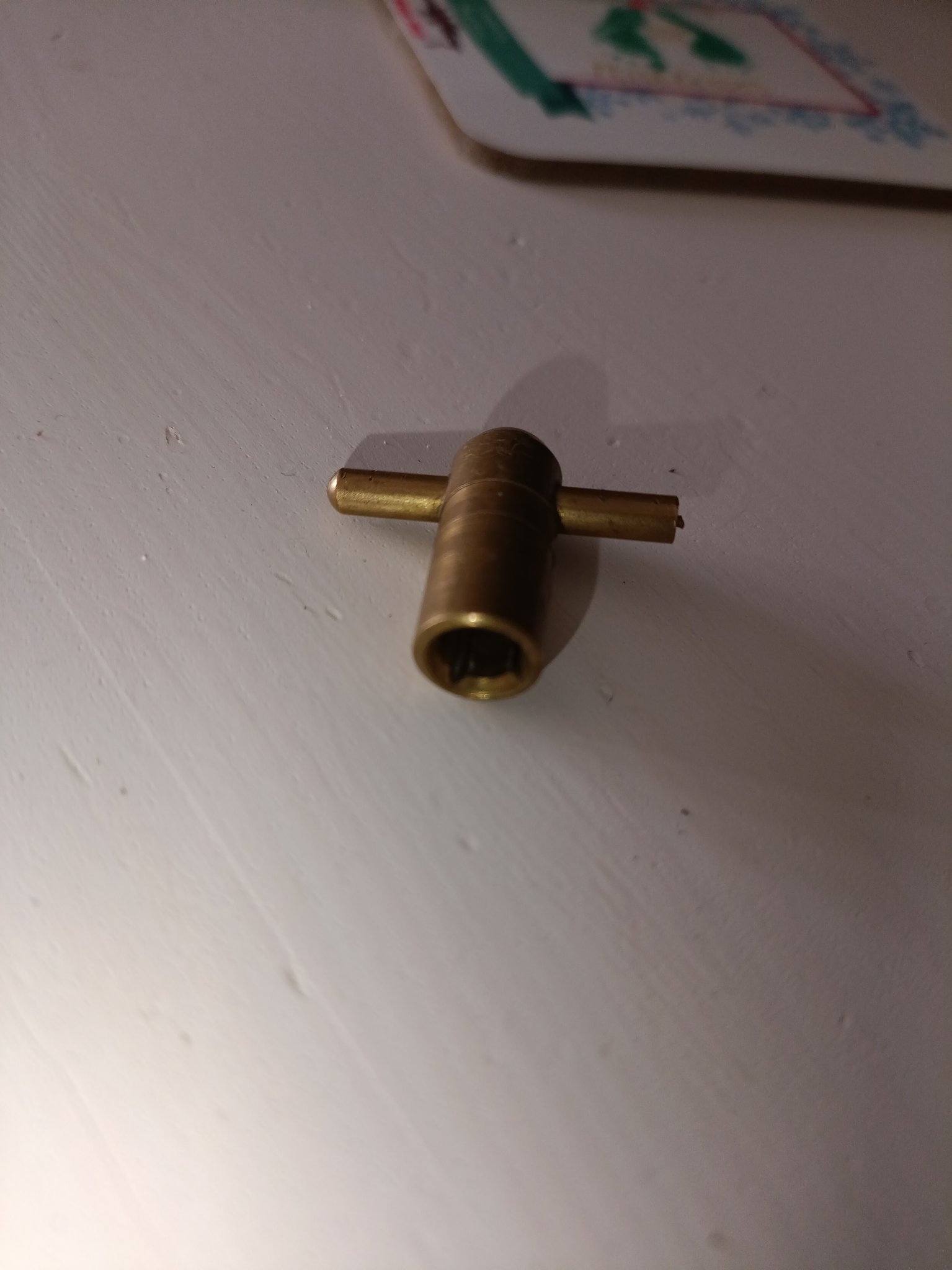

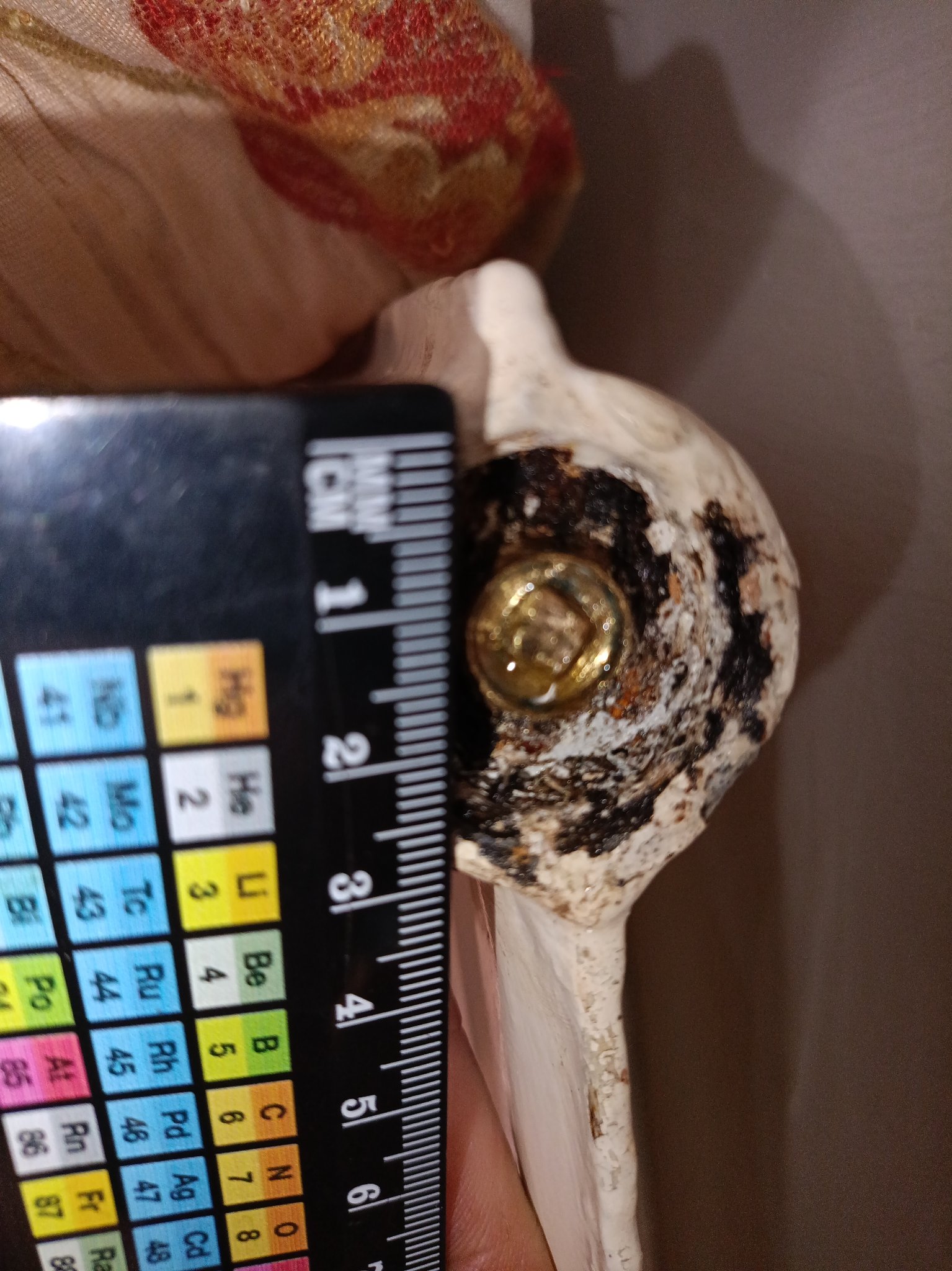

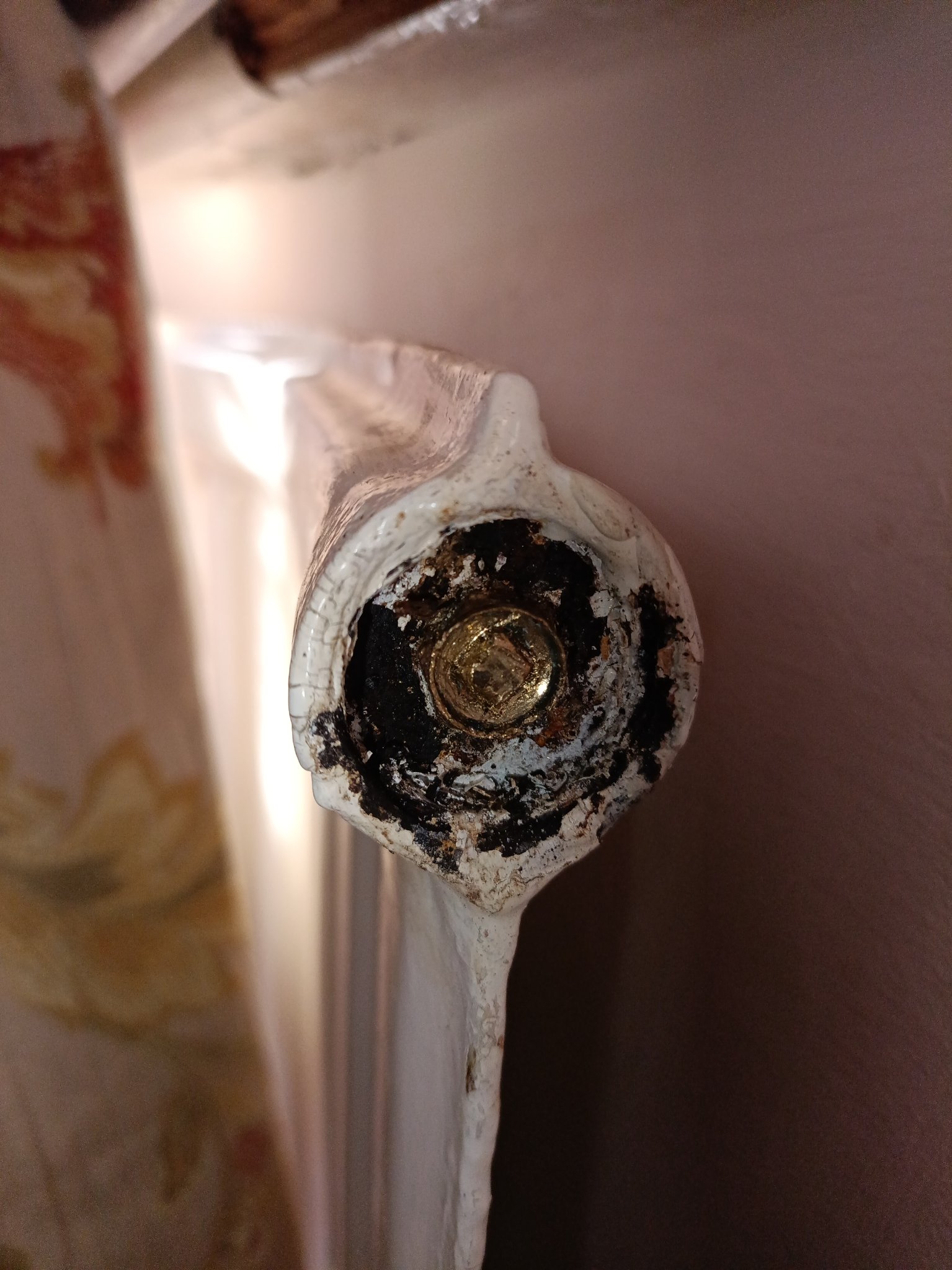

Hi there. I have been checking our radiators for the upcoming winter (ironically, over the hottest weekend of the year) and one of my radiator valves is stuck closed, so I cannot bleed it. I bought a radiator key but it is too big - in the past, I have just used a pair of pliers but they just won't budge it this time. What are my options?
I can either continue to have a go with getting the tiny square screw open or should I cut my losses and try and replace the entire valve with a new one?

Get a socket set.
Find a socket smaller than grub screw that don't fit on.
Couple of smacks with a hammer will shape the brass to the socket.
Very often the bleed screw comes loose when I've done this in the past.
If not when socket it's on use your socket wrench.
I've advised customers to get the radiator replaced as that's a cheap DIY job if you are game, and looking at the rust and corrosion in picture I would advise you do that sometime before winter this year.

Yes, the bleed screw may come loose after smacking with a hammer but, with that amount of rust, there's a danger that the whole bleed valve will come loose and leak or, worse, come out completely. If you don't want to renew the radiator for now, I'd leave well alone.

If you look at your rad key you will notice that the square hole which needs to engage with the bleed screw is recessed by a couple of mm. If you file the end of the key down (easy as its only soft brass), the key will engage much better with bleed screw.
