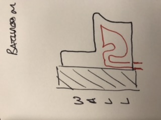

ok - are there toilets whereby the exit pipe after the bend, goes directly down below the floorboards, so that it is fully contained in the porcelain , therefore the toilet can be placed directly against the wall without the pipe on show?

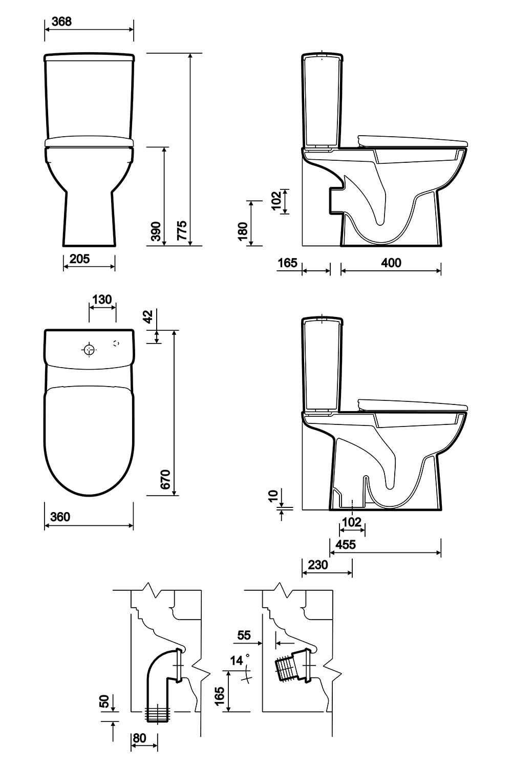

you are talking about a bottom-outlet pan, where the soil pipe goes downwards through the floor.
I have only seen one recent example where there is a skirt that conceals the trap and pipe, it is a Twyfords E100, Premium, the higher-grade model. Not widely stocked but can be ordered.
When you buy a bottom-outlet pan, you have to start be measuring accurately the distance between the wall and the centre of the soilpipe in the floor, because the pan must fit this. Different pans vary. I did see others of different distance but they were not of interest to me as they did not fit.
It has a distance of 230mm, mine was with 25mm of that and there is enough flex in the rubber seal of the adaptor collar to fit.
if yours is a different distance you will need some other pan. There is also a Twyfords Alcona (more traditional design, different size)
See pic.
Fourth image.
