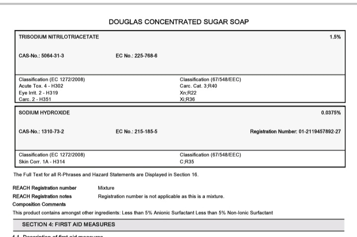

Only 20 years late! ;)
But I'm afraid you're partially incorrect.
"Sugar Soap" is a bit of a catch-all term. The chemical composition is down to the manufacturer and tends to have different ingredients, in different parts of the world.
Trisodium Phosphate has been used widely in the US, for example.
Sodium Hydroxide has traditionally been used here, but isn't very common now - although it is still around...
As with most chemicals, if you don't know exactly what you are dealing with, read the instructions / download the MSDS.
