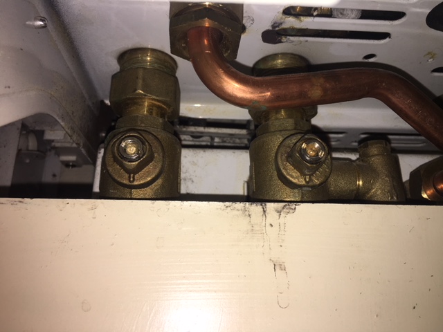

Thanks. Hmm yes that now jog's my memory. He didn't seem to want to shut off the valves (see pic) because he said that type always leak if you move them (suppose are quite old. 18 yrs approx).
Would you agree those are maybe best left alone..?
Think it'll have to be a suck it and see scenario with a new boiler. It's an old Vokera linea plus 32kw I have. To be fair it's still plodding along ok but it'd just not be worth fixing so a preventative change seems like a good plan.
If they haven't been used much in 18 years I wouldn't chance it now !! Nor would I spend money on it , rather go for a new boiler.
