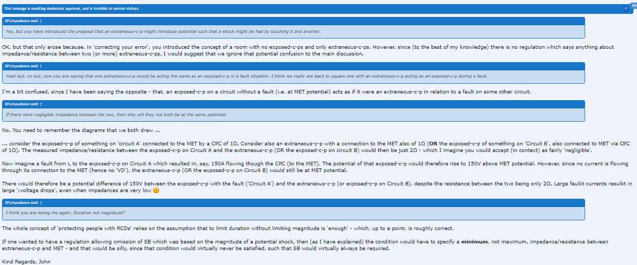

Yes, but you have introduced the proposal that an extraneous-c-p might introduce potential such that a shock might be had by touching it and another.
OK, but that only arose because, in 'correcting your error', you introduced the concept of a room with no exposed-c-ps and only extraneous-c-ps. However, since (to the best of my knowledge) there is no regulation which says anything about impedance/resistance between two (or more) extraneous-c-ps, I would suggest that we ignore that potential confusion to the main discussion.
Yeah but, no but, now you are saying that one extraneous-c-p would be acting the same as an exposed-c-p in a fault situation. I think we really are back to square one with an extraneous-c-p acting as an exposed-c-p during a fault.
I'm a bit confused, since I have been saying the opposite - that, an exposed-c-p on a circuit without a fault (i.e. at MET potential) acts as if it were an extraneous-c-p in relation to a fault on some other circuit.
If there were negligible impedance between the two, then why will they not both be at the same potential.
No. You need to remember the diagrams that we both drew ...
... consider the exposed-c-p of something on 'circuit A' connected to the MET by a CPC of 1Ω. Consider also an extraneous-c-p with a connection to the MET also of 1Ω (OR the exposed-c-p of something on 'Circuit B', also connected to MET via CPC of 1Ω). The measured impedance/resistance between the exposed-c-p on Circuit A and the extraneous-c-p (OR the exposed-c-p on circuit B) would then be just 2Ω - which I imagine you would accept (in context) as fairly 'negligible'.
Now imagine a fault from L to the exposed-c-p on Circuit A which resulted in, say, 150A flowing though the CPC (to the MET). The potential of that exposed-c-p would therefore rise to 150V above MET potential. However, since no current is flowing through its connection to the MET (hence no 'VD'), the extraneous-c-p (OR the exposed-c-p on Circuit B) would still be at MET potential.
There would therefore be a potential difference of 150V between the exposed-c-p with the fault ('Circuit A') and the extraneous-c-p (or exposed-c-p on Circuit B), despite the resistance between the two being only 2Ω. Large faulkt currents resulkt in large ';voltage drops', even when impedances are very low :-)
I think you are losing me again. Duration not magnitude?
The whole concept of 'protecting people with RCDs' relies on the assumption that to limit duration without limiting magnitude is 'enough' - which, up to a point, is roughly correct.
If one wanted to have a regulation allowing omission of SB which was based on the magnitude of a potential shock, then (as I have explained) the condition would have to specify a minimum, not maximum, impedance/resistance between extraneous-c-p and MET - and that would be silly, since that condition would virtually never be satisfied, such that SB would virtually always be required.
Kind Regards, John

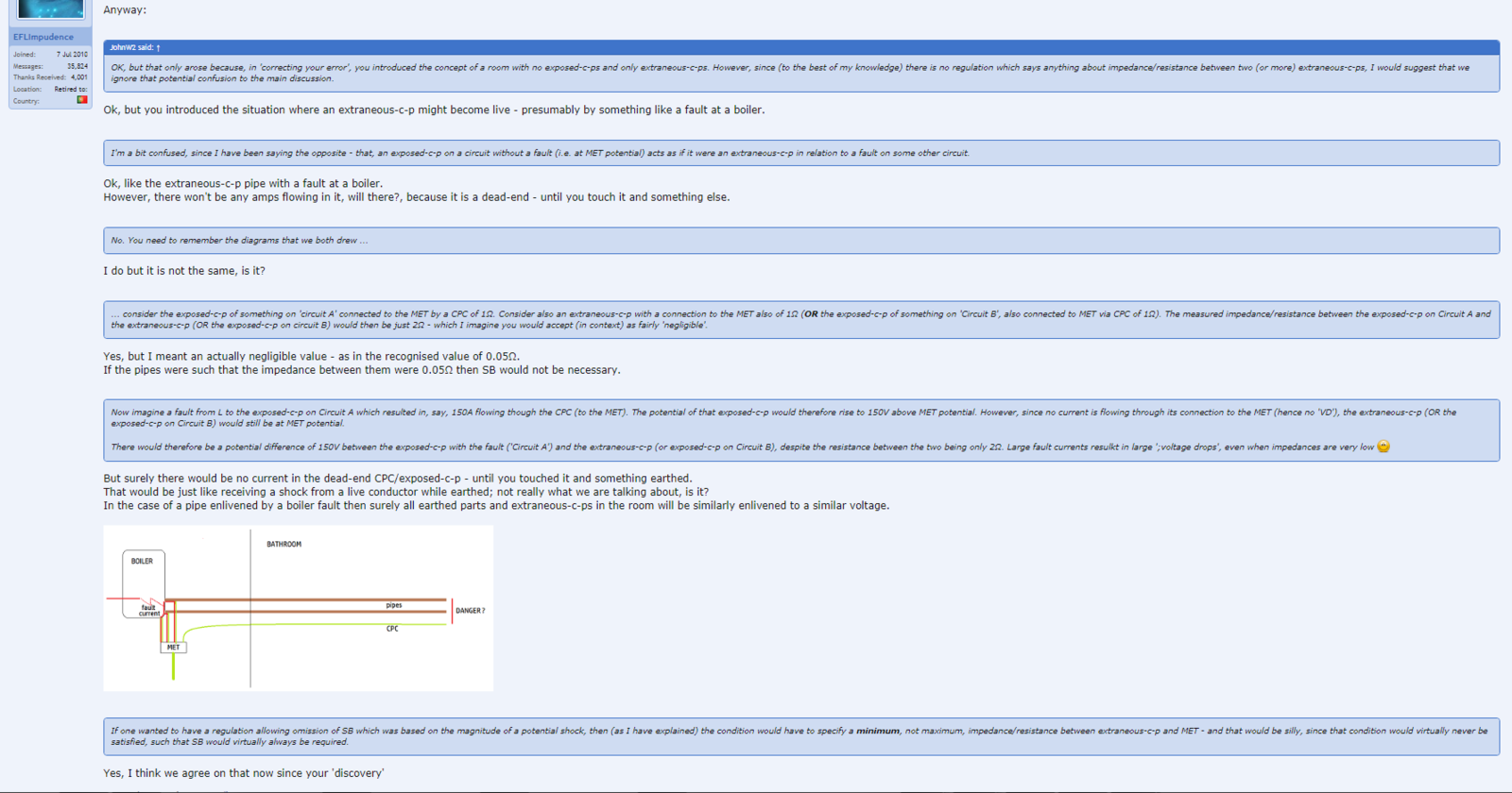

Ok, but you introduced the situation where an extraneous-c-p might become live - presumably by something like a fault at a boiler.

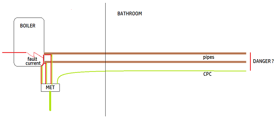

Ok, like the extraneous-c-p pipe with a fault at a boiler.
However, there won't be any amps flowing in it, will there?, because it is a dead-end - until you touch it and something else.
I do but it is not the same, is it?
Yes, but I meant an actually negligible value - as in the recognised value of 0.05Ω.
If the pipes were such that the impedance between them were 0.05Ω then SB would not be necessary.
There would therefore be a potential difference of 150V between the exposed-c-p with the fault ('Circuit A') and the extraneous-c-p (or exposed-c-p on Circuit B), despite the resistance between the two being only 2Ω. Large fault currents resulkt in large ';voltage drops', even when impedances are very low :)
But surely there would be no current in the dead-end CPC/exposed-c-p - until you touched it and something earthed.
That would be just like receiving a shock from a live conductor while earthed; not really what we are talking about, is it?
In the case of a pipe enlivened by a boiler fault then surely all earthed parts and extraneous-c-ps in the room will be similarly enlivened to a similar voltage.
Yes, I think we agree on that now since your 'discovery'

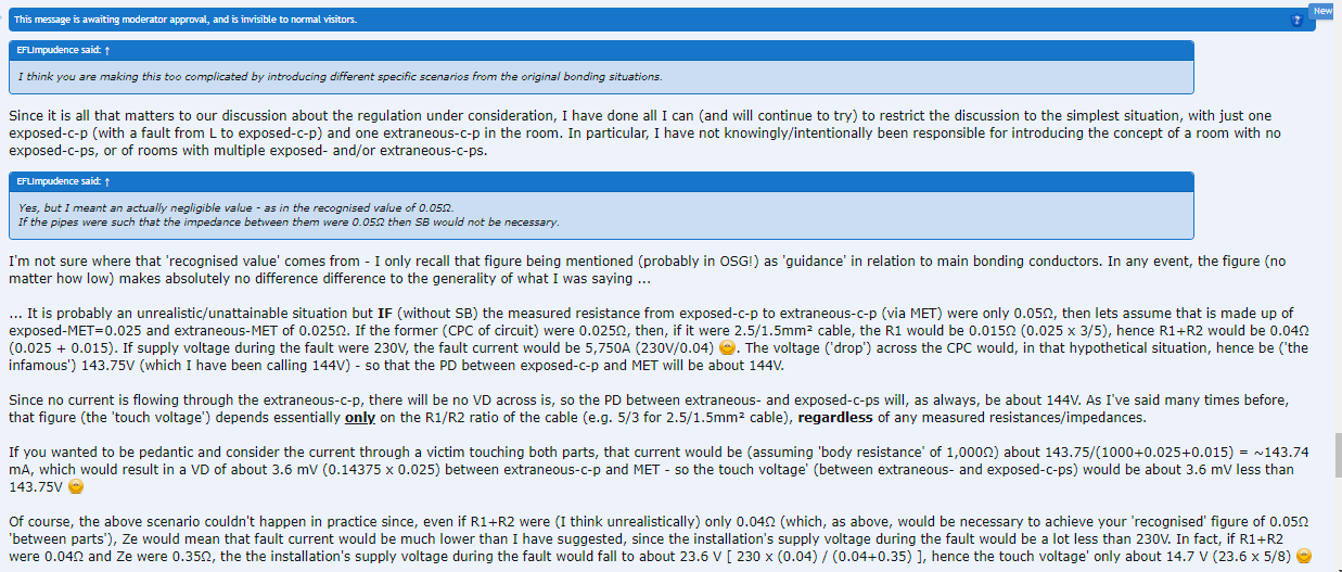

I think you are making this too complicated by introducing different specific scenarios from the original bonding situations.
Since it is all that matters to our discussion about the regulation under consideration, I have done all I can (and will continue to try) to restrict the discussion to the simplest situation, with just one exposed-c-p (with a fault from L to exposed-c-p) and one extraneous-c-p in the room. In particular, I have not knowingly/intentionally been responsible for introducing the concept of a room with no exposed-c-ps, or of rooms with multiple exposed- and/or extraneous-c-ps.
I'm not sure where that 'recognised value' comes from - I only recall that figure being mentioned (probably in OSG!) as 'guidance' in relation to main bonding conductors. In any event, the figure (no matter how low) makes absolutely no difference difference to the generality of what I was saying ...
... It is probably an unrealistic/unattainable situation but IF (without SB) the measured resistance from exposed-c-p to extraneous-c-p (via MET) were only 0.05Ω, then lets assume that is made up of exposed-MET=0.025 and extraneous-MET of 0.025Ω. If the former (CPC of circuit) were 0.025Ω, then, if it were 2.5/1.5mm² cable, the R1 would be 0.015Ω (0.025 x 3/5), hence R1+R2 would be 0.04Ω (0.025 + 0.015). If supply voltage during the fault were 230V, the fault current would be 5,750A (230V/0.04) :-). The voltage ('drop') across the CPC would, in that hypothetical situation, hence be ('the infamous') 143.75V (which I have been calling 144V) - so that the PD between exposed-c-p and MET will be about 144V.
Since no current is flowing through the extraneous-c-p, there will be no VD across is, so the PD between extraneous- and exposed-c-ps will, as always, be about 144V. As I've said many times before, that figure (the 'touch voltage') depends essentially only on the R1/R2 ratio of the cable (e.g. 5/3 for 2.5/1.5mm² cable), regardless of any measured resistances/impedances.
If you wanted to be pedantic and consider the current through a victim touching both parts, that current would be (assuming 'body resistance' of 1,000Ω) about 143.75/(1000+0.025+0.015) = ~143.74 mA, which would result in a VD of about 3.6 mV (0.14375 x 0.025) between extraneous-c-p and MET - so the touch voltage' (between extraneous- and exposed-c-ps) would be about 3.6 mV less than 143.75V :-)
Of course, the above scenario couldn't happen in practice since, even if R1+R2 were (I think unrealistically) only 0.04Ω (which, as above, would be necessary to achieve your 'recognised' figure of 0.05Ω 'between parts'), Ze would mean that fault current would be much lower than I have suggested, since the installation's supply voltage during the fault would be a lot less than 230V. In fact, if R1+R2 were 0.04Ω and Ze were 0.35Ω, the the installation's supply voltage during the fault would fall to about 23.6 V [ 230 x (0.04) / (0.04+0.35) ], hence the touch voltage' only about 14.7 V (23.6 x 5/8) :-)

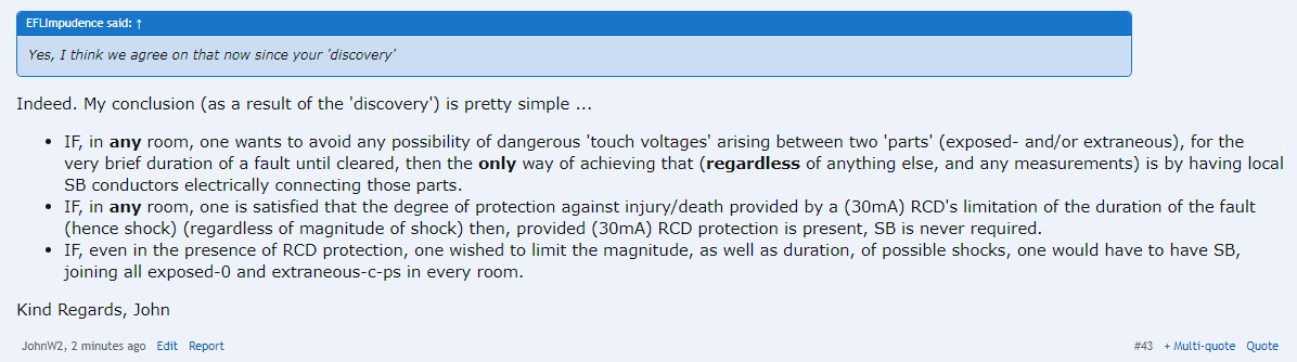

Indeed. My conclusion (as a result of the 'discovery') is pretty simple ...
  • IF, in any room, one wants to avoid any possibility of dangerous 'touch voltages' arising between two 'parts' (exposed- and/or extraneous), for the very brief duration of a fault until cleared, then the only way of achieving that (regardless of anything else, and any measurements) is by having local SB conductors electrically connecting those parts.
  • IF, in any room, one is satisfied that the degree of protection against injury/death provided by a (30mA) RCD's limitation of the duration of the fault (hence shock) (regardless of magnitude of shock) then, provided (30mA) RCD protection is present, SB is never required.
  • IF, even in the presence of RCD protection, one wished to limit the magnitude, as well as duration, of possible shocks, one would have to have SB, joining all exposed-0 and extraneous-c-ps in every room.
