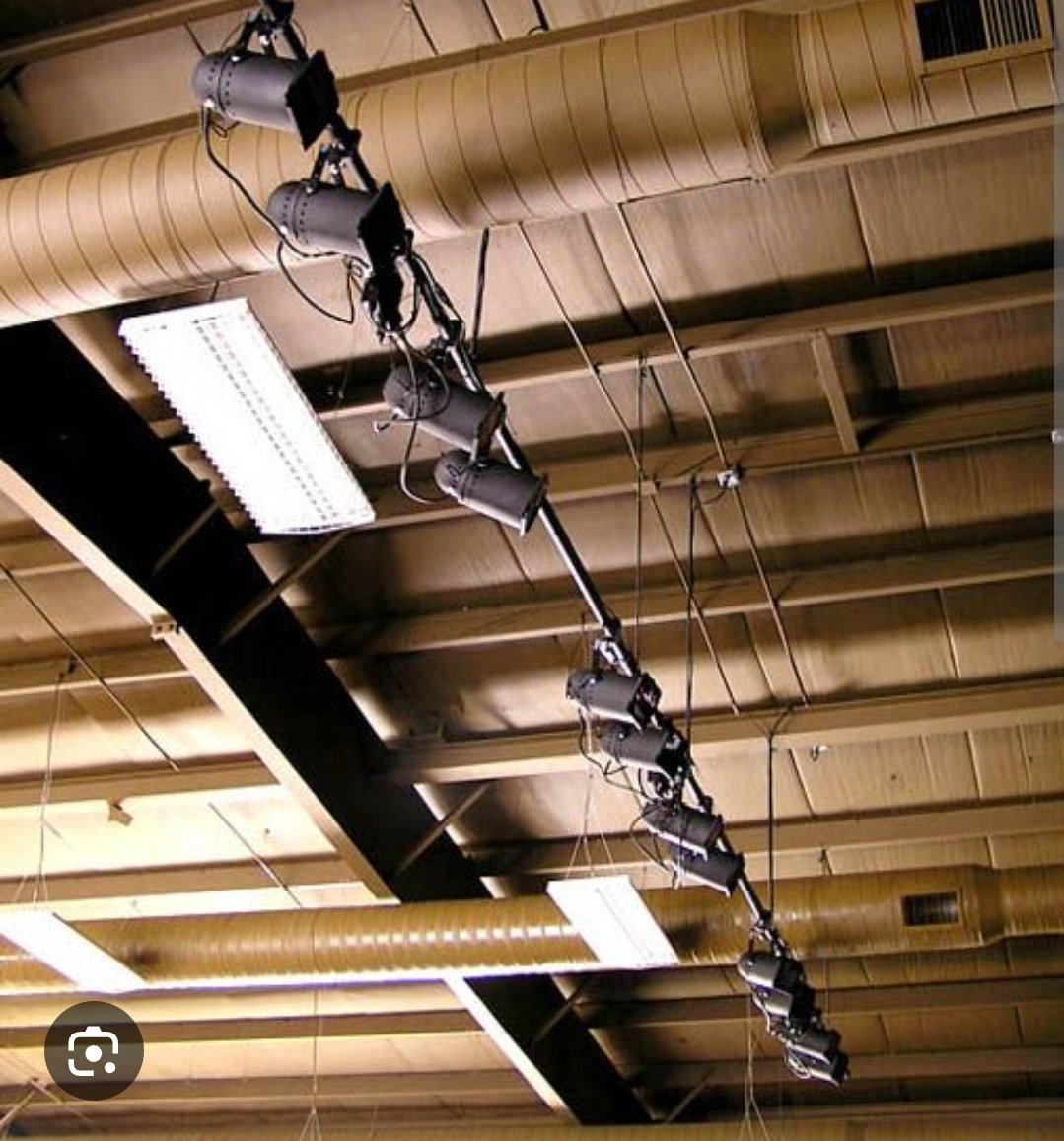

Stage lighting bar?

You you want something like the picture already posted?

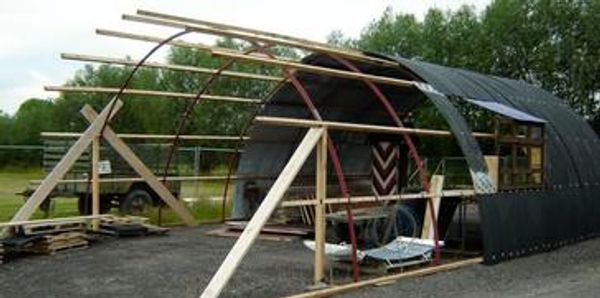

Curved corrugated iron of that thickness can withstand a much heavier load than a few cables and lamps.
