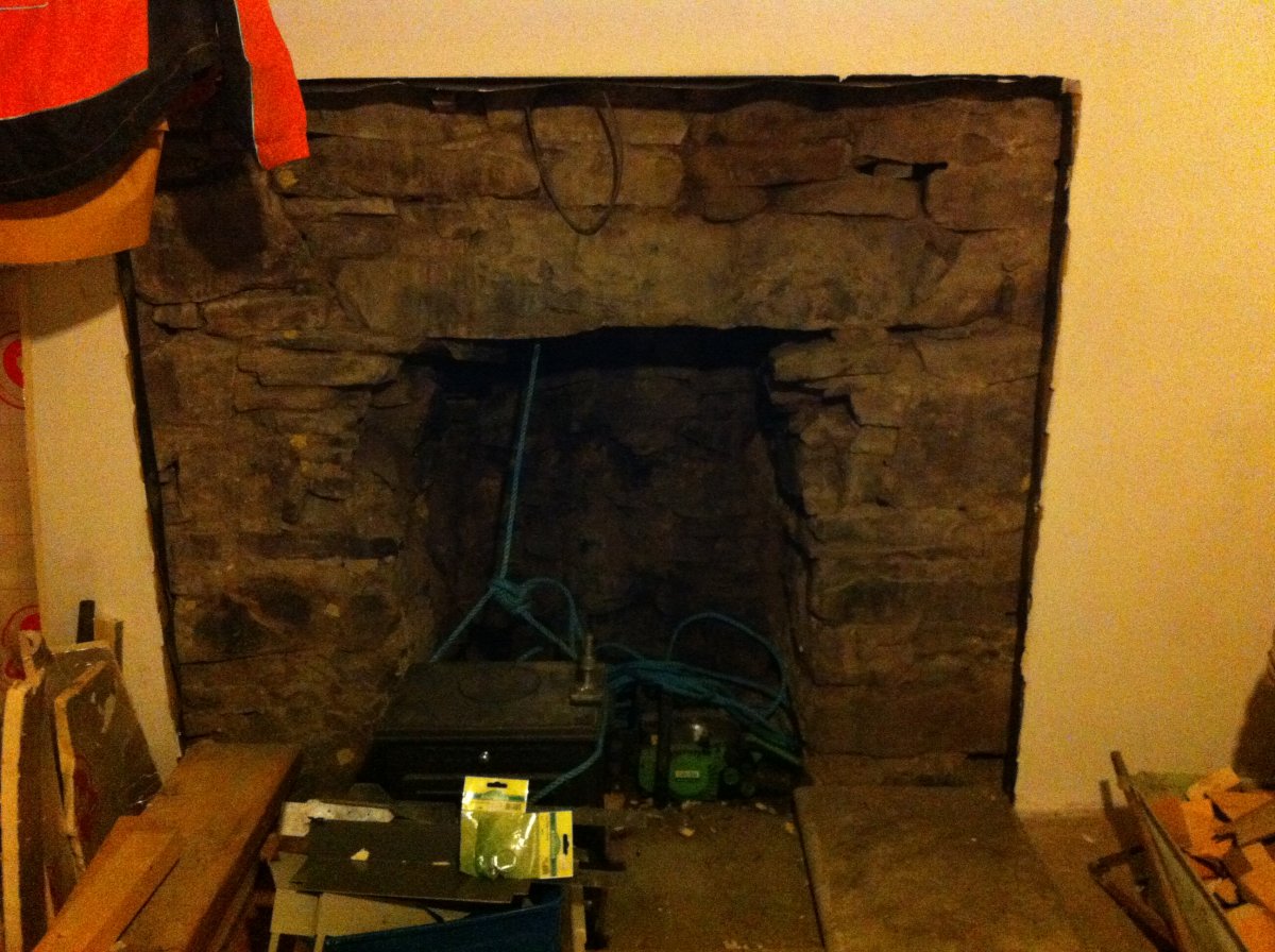

I have an old stone fireplace with a stone lintel which is poorly supported at both sides due to stones falling out (phot attached, hopefully). I am hoping to install a wood-burning stove but wonder how best to support the lintel to enable me to build up the missing stone and mortar at the sides. Would reinforced concrete lintels placed vertically under each side of the lintel be a good idea or can you suggest better?

No that will look terrible. Pack up the opening with building blocks and hammer in some long thin wooden wedges. That will hold the lintel in place. Gently take the sides down and rebuild. Move the stones and perhaps use bricks behind them, so it looks "stone" but the core is brick. It would be nice to move the lintel a bit towards the left.
I doubt if the lintel is holding the whole stack up, just a metre or so above the opening, but it would be messy and dangerous if it fell down during construction.
If you use a bit of round bar in a joint, it reduces the friction, so stones can be "persuaded" to move, which they would not if sitting on another stone.
