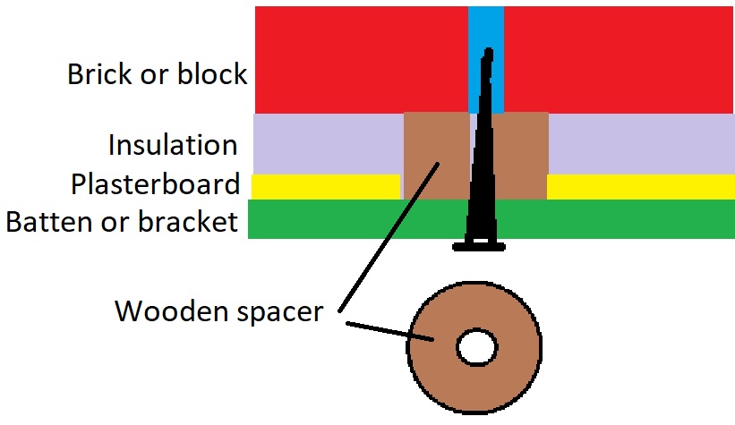

You will need to go directly into the masonry or if the gap is quite large you will need to take out a section of plasterboard, pack off the wall with plywood or OSB (to make a pattress), then make good the PB, and fix through the PB into the pattress (and ideally the masonry behind it as you will need some really quite long fixings)
I think the gap is around an inch from recollection... I've used dot and dab fixings on my 3m roller blind successfully but obviously this would have a lot more weight...
In an ideal world I'd just stick a leg or two there but there's a cat flap which needs access underneath...
This should work, the screw ( black ) and plug ( blue ) will need to be as long as possible.

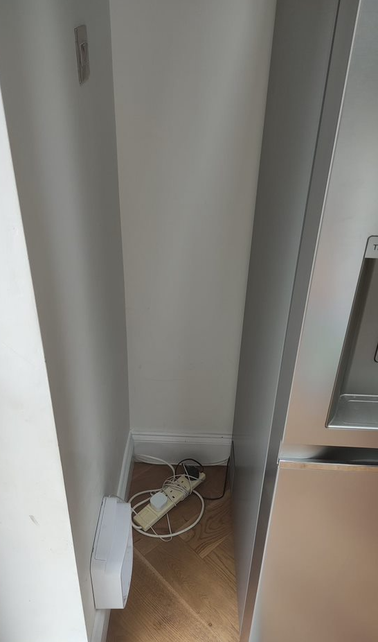

To aid the conversation here is the space.
I'm mostly worried about canterlever motion from the direction the picture is facing... (I'm hoping to be able to fix my beer engine on here at parties!)

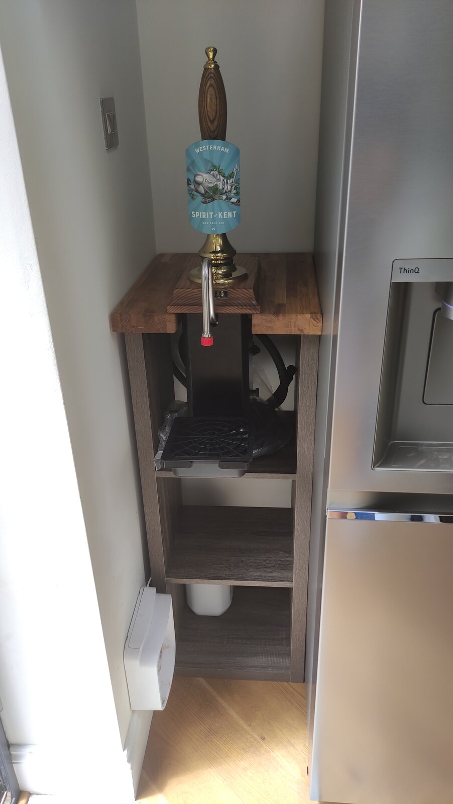

Well, serendipity is a wonderful thing. Walked into Wilko the other day and they had a unit on clearance that fit the gap nicely.
Modified it with an old worktop cut to shape, screwed to wall with an aluminium angle left over from our kitchen and bobs your uncle. Works a charm
