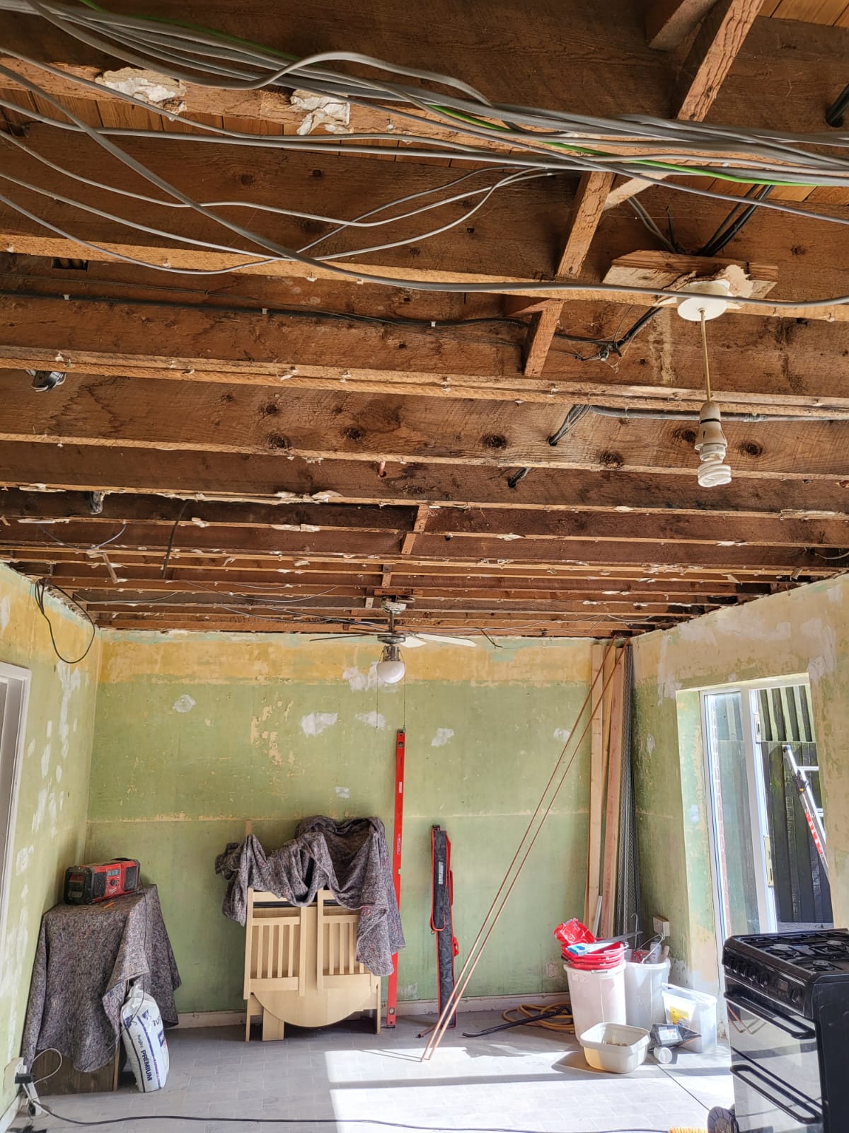

Hi all
So I had an internal wall removed and the builder bought an RSJ then decided he didn't need it (I know right)
We then had it plastered up and finished but I am now worrying as I never told the insurance because I am a fool!!
Luckily we got a picture of the wall taken down....it was halfway between the light fittings, maybe slightly closer to the sexy fan.
Can anyone see any sign there that it was a load bearing wall......the wall was some kind of breeze block looking stuff
Thank you for looking
Richard
If it ran parallel to the joists, it probably wasn’t supporting anything. Unless that double joist is relevant, and it was below that. But sounds like it wasn’t under that.
It looks like the double joists are every 5 or so joists so I thought that wasn't relevant either.....
