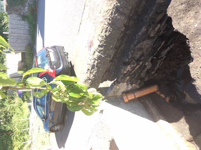

After a hell of a lot of digging (I'm also doing a driveway), I found that the old clay pipe leaves my property into the road. The pipe was completely full of soil at this point and I have cleared this to about 4m from my property (using a drain cleaner on pressure washed) but I'm now hitting something solid - I think this may be a T junction in the road.

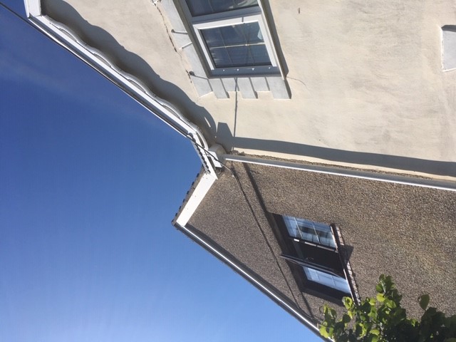

Good morning Lucas, can you show me a photo of the neighbours roofline at the front and back were it’s connected to you. If you can send a photo of the down pipe that takes your neighbours rainwater and the gully it drops into please. Properties built prior to October 1937 are subject to section 24 sewage law that states if a property takes a neighbours foul or waste water as soon as it hits the drainage system it becomes a public drain and is the responsibility of the water company. This is the law in England I will check for Wales.

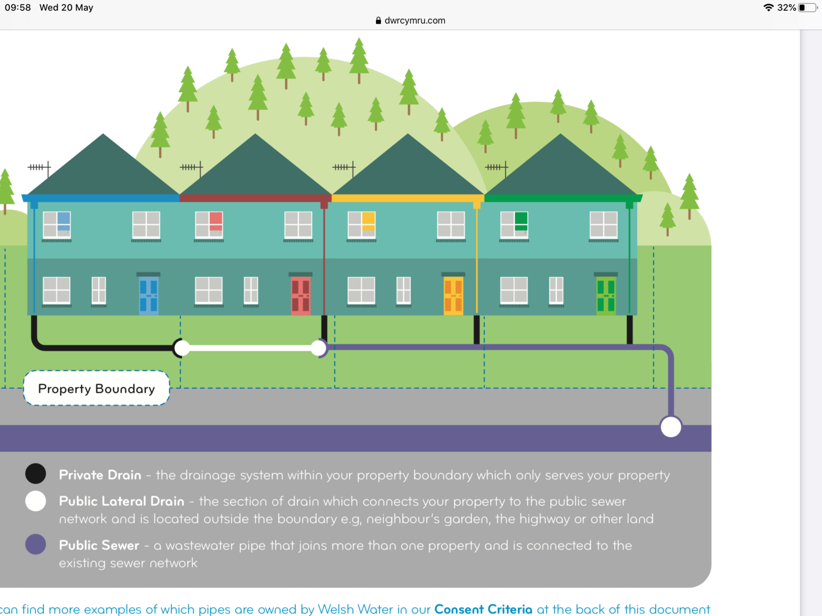

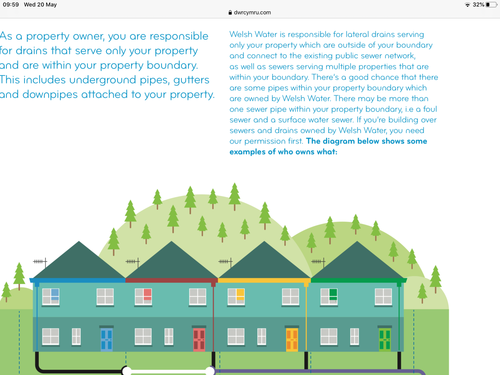

Hi Lucas, you might be in luck. See attached, normally properties at the end of the drainage run are public drainage and are the responsibility of the water company.

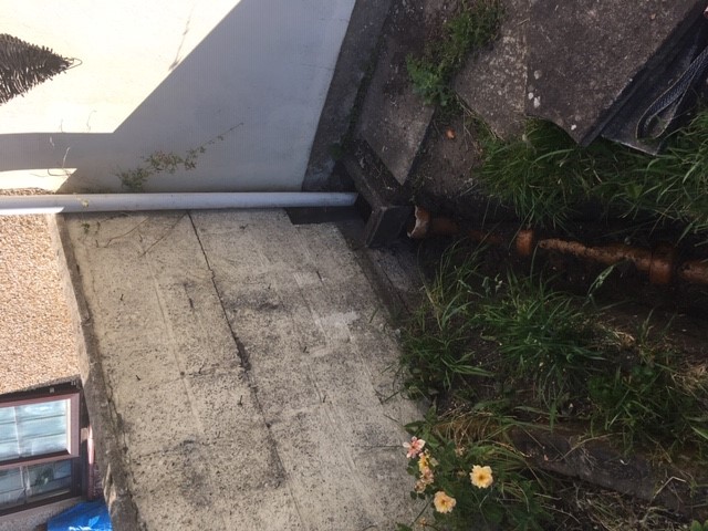

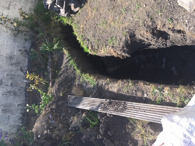

Pictures attached. So the downpipe picks up roof water from both properties at the front. (the rear seems to feed into the foul drainage). Where you can see I've dug the trench and it kinks, there is a Y connection, so this gully feeds into a drain that originates from my neighbors property. It then pics up a feed from another of my gullys, and leaves my property as per the photo.
In the overhead picture, my house is the last one on the right. There is an elevation drop of about 1m across the width of my property with my property being lower than the next door. I believe the houses on the corner feed into other drainage.
Just to clarify, the drain doesn't connect into a sewer or a 'known' pipe. This seems to make a difference for the latest 2011 (i think) adoption rules, but not sure about the section 24 ones.

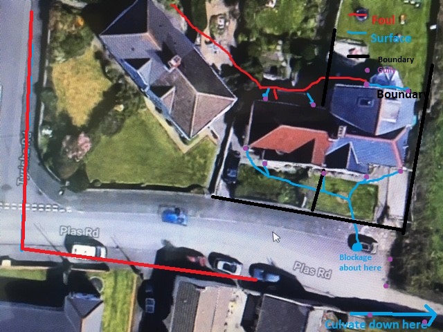

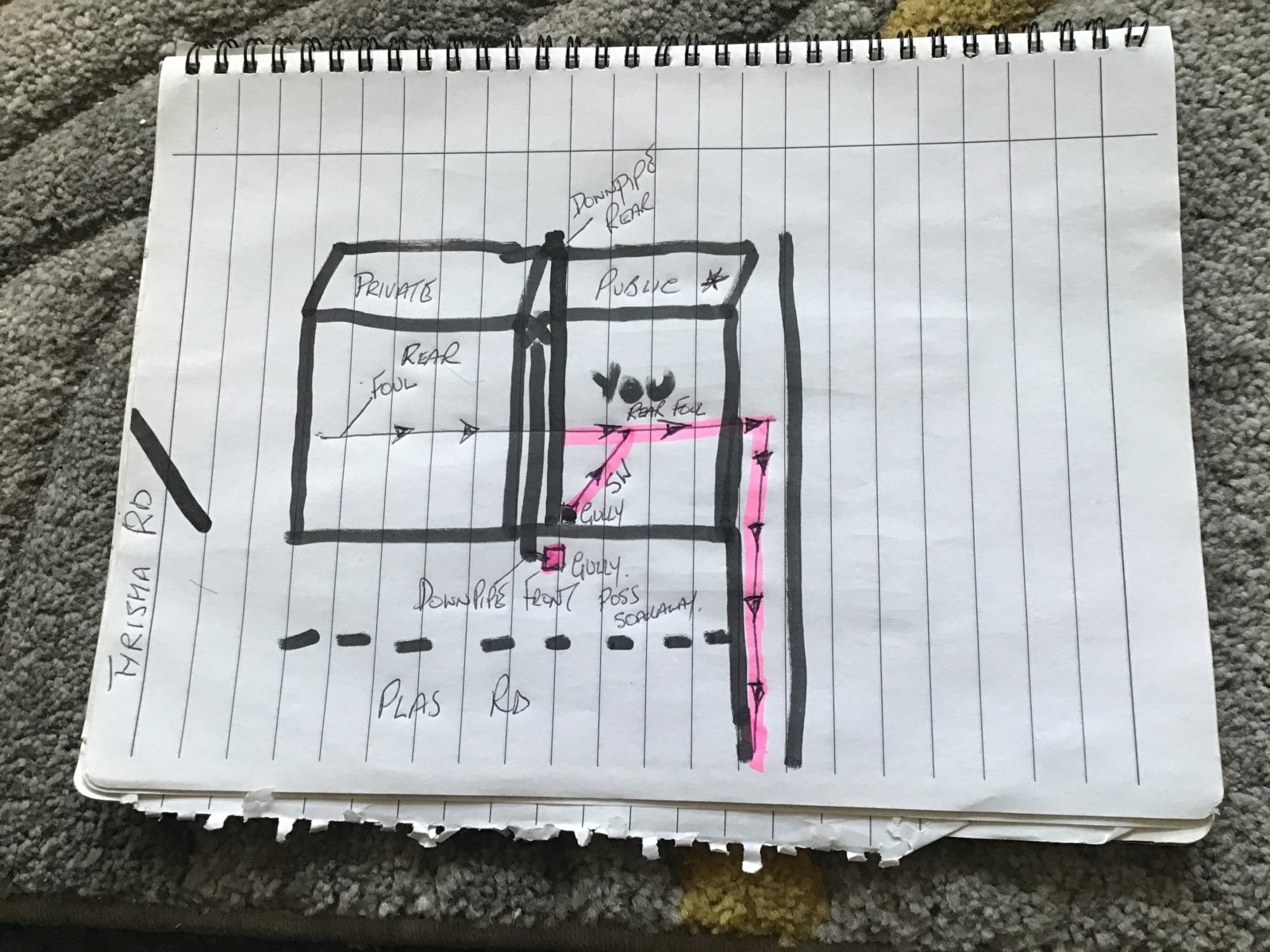

Hi mate, does your drainage run into the main on plas rd. I have done a diagram from the pics and info so if I’m seeing it right it runs like this. See attached. Pink is section 24. The gully at the front looks like a soakaway.

Hi Johnny,
Thank you for taking the time to do a diagram, really appreciated.
I've done a crude layout below of the drainage layout. All the drainage pipes to my front garden are exposed, so I can track the pipes from gully up to the boundary.
The main foul line on Plas Road is uphill of where my pipe leaves my property. I've checked all the manholes and gullies in the road and there are no connections from my property.
I've spoken to Welsh Water again, and they indicated that if it wasn't connecting into 'their network' it most likely wouldn't be their responsibility. What I seem to read is that, if it was installed before 1937, where it becomes combined with the neighbors, it becomes the 'authorities' responsibility even if it doesn't connect into their network and its only surface water. I am not sure however if, as it isn't connected into the 'network', responsibility may actually have been passed to the highway authorities or local council - this is what the lady indicated.
Thanks for your help with this.
