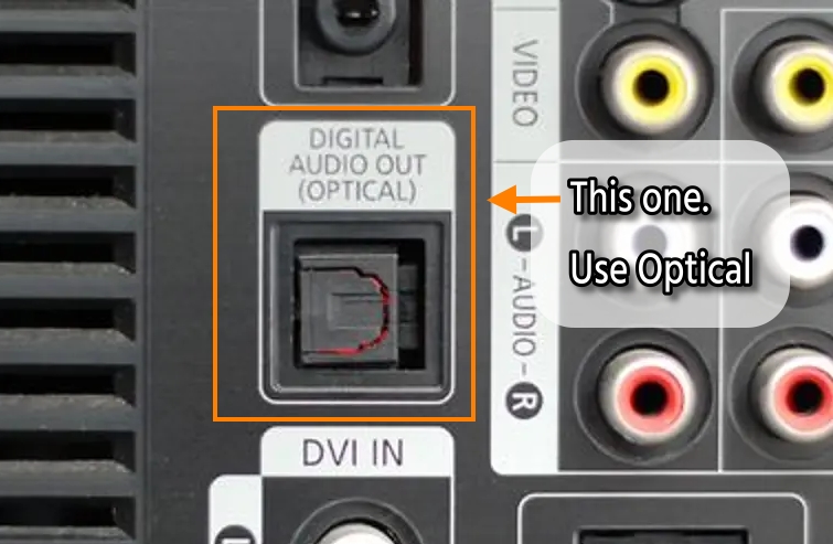

Most TVs have an optical output.

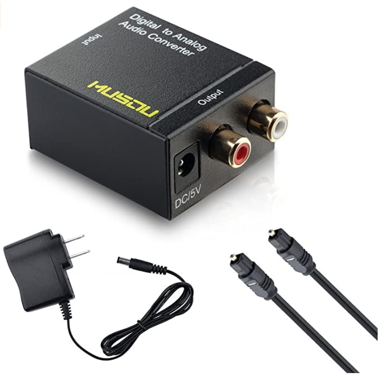

Your Panasonic has a standard RCA stereo input and a SCART which can input and output connections within its 21-pin construction. Both are analogue whereas Optical is a digital signal standard. You will need a digital to analogue convertor, like this.
On one side there's an Optical input. On the other side there's the stereo analogue connection via RCA sockets. This will convert digital stereo from Optical into analogue stereo for connection to your Panasonic surround system.

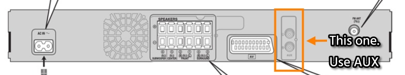

The simplest connection from the convertor is to the Panasonic's AUX stereo line input. This will get sound from the TV, converted from digital to analogue, into the Panasonic so you can hear it in surround.

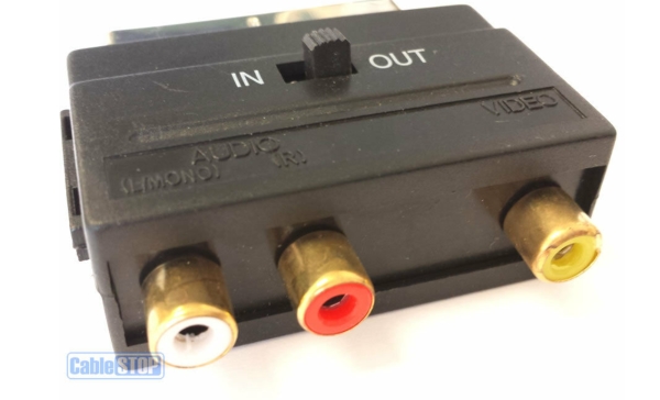

Composite is what we see via the yellow RCA out from VCRs, DVD players, some games consoles, and via adapters that connect to a SCART socket. If you have a SCART to 6 phono/RCA cable (2x video, 4x audio) then use that. If not, then since SCART is bi-directional, you run the risk that a SCART to 3x phono/RCA will be in the wrong direction. i.e. RCA-to-SCART and not SCART-to-RCA which is what you need.
Buy one of these switchable SCART adapters instead. It's impossible to get this connection wrong when the switch gives you both in and out options.
Take a cable from the yellow connection to the green of YPbPr.
Put a DVD into the Panasonic and allow it time to load the opening menus
Go to the TV menus, then choose the necessary options to select or enable the AV/Video input

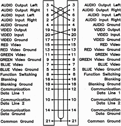

If there is no signal from the Panasonic surround kit's DVD player, first try the other position of the adapter switch. If still no joy then it's because the Panasonic is outputting RGB video which uses different pin connections to composite.
The only remaining option is to find a TV with a SCART socket to make a temporary connection in order to see and change te settings menu. The adjustment required is to change the video output from RGB to composite

The Optical output on the TV will need to be set to PCM Stereo rather than Dolby / Dolby Digital
