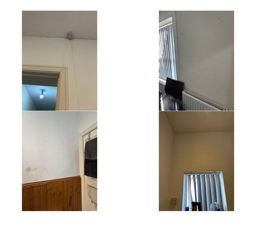

We are buying an old 1900 3-bed terrace and surveyors report picked this up:
There are cracks/distortions in the bathroom and rear bedroom that could be associated with drains leaking below ground and close to the building externally or plumbing leaks below the floors. Faulty drainage or plumbing can cause movement and buildings can often be found to have defective drains. Plumbing leaks are found less often. Leaking water can soften the ground beneath the foundations, leading to movement. We therefore recommend that the drainage is tested by means of a pressure test, possibly followed by a CCTV inspection. A CCTV inspection alone will not confirm whether or not there are any leaks, nor whereabouts the leaks are located. The local water company could be responsible for some drainage repairs and this should be confirmed by your legal advisor. The plumbing system can be tested for leaks by a reputable plumbing contractor. Further advice with regard to remedial work necessary, can be obtained from a structural engineer. A structural engineers specification for necessary repair will also be required, particularly if no leaks can be found.
It said this about the hallway as well. I have attached pictures of the said crack as well. just wondering if anyone has any advice regarding this, as we are wondering if to proceed with purchase.

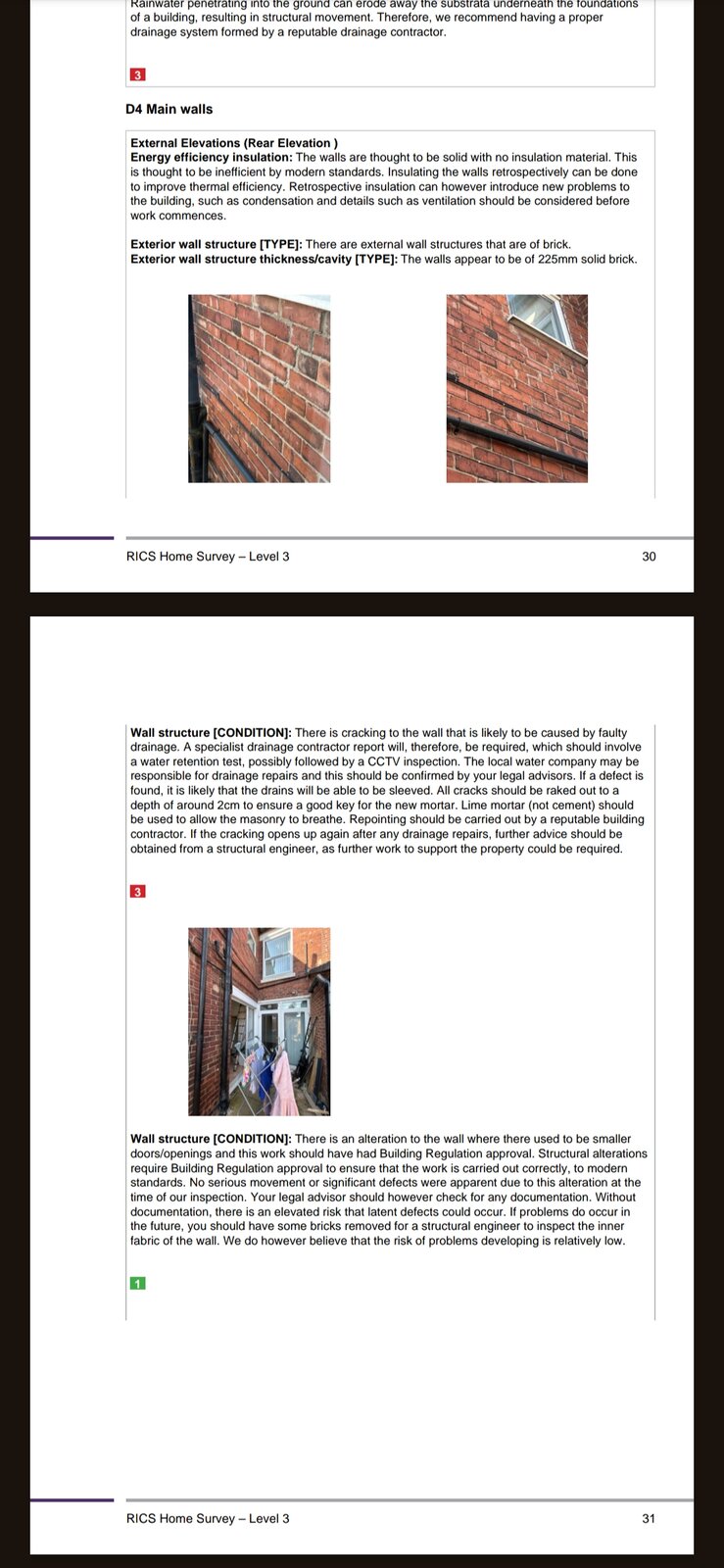

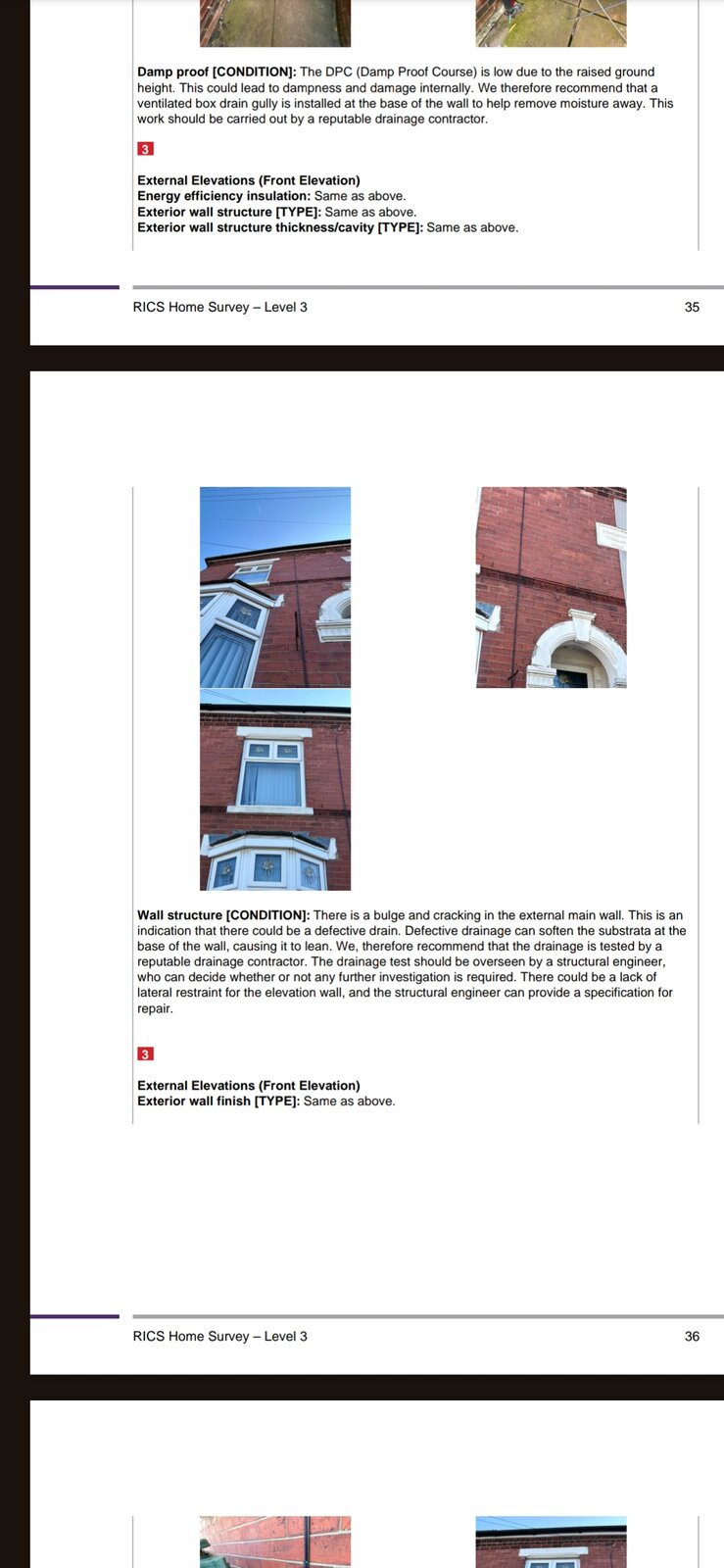

Survey did identify cracks on external wall as well. I've attached pictures and the statement.

It's impossible to judge from tiny photos at the other end of the internet.
Fixing the drains is essential IF they are the cause. It could be a minor patch up or complete replacement of every pipe. Nobody knows this is even the cause, it's the surveyor's guess. But whatever the cause, the damage needs repairing. This could include underpinning, which will cost £1000s and will probably mean it's hard to insure and/or you pay extra per year for ever, and you'd need to declare this to any future potential buyers. I think some councils keep a register, so it won't ever be forgotten.

You're probably not, it's the biggest investment most people make in their lifetimes. Structural cracks are definitely a big deal. But... it's impossible for anyone here to tell just from the tiny photos you've posted.
In general shrinkage isn't a big deal - which is usually a vertical crack resulting from entirely horizontal movement. More common in new buildings. If there's any vertical movement (downwards) then that is a concern. If so you'd get a step in the bricks courses on each side of the crack, or a crack that's wider at the top than the bottom, where two parts of the building are tilting away from each other.
