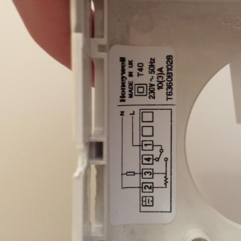

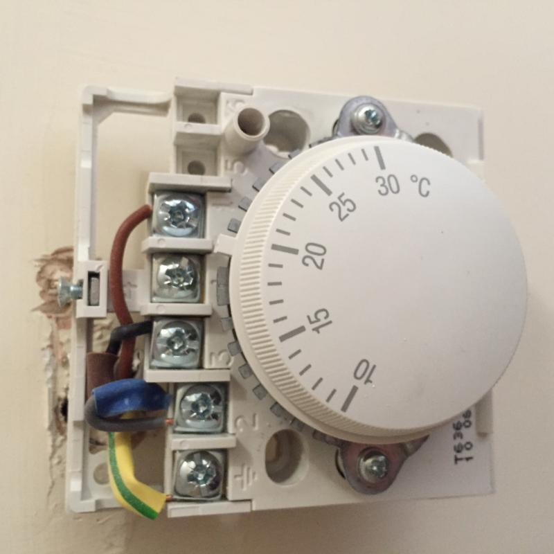

Hi, I've purchased a new digital thermostat to replace my old one.
The wiring is slightly different, can someone advise which wires I should connect to which terminals in the new thermostat?
Old stat

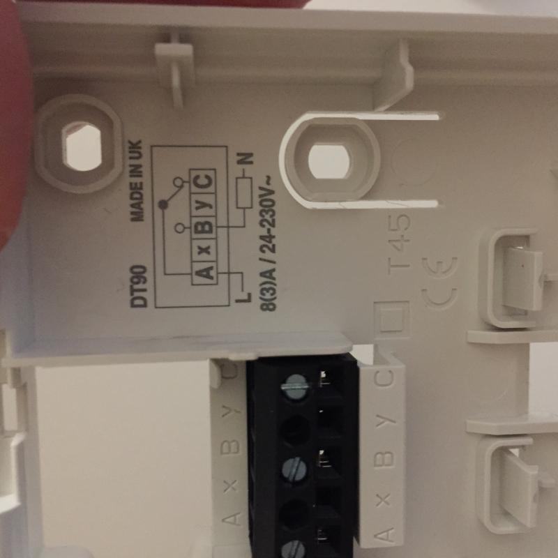

New wiring diagram

1 to A, 3 to B and terminate the other two safely (separately in two pieces of terminal block).
