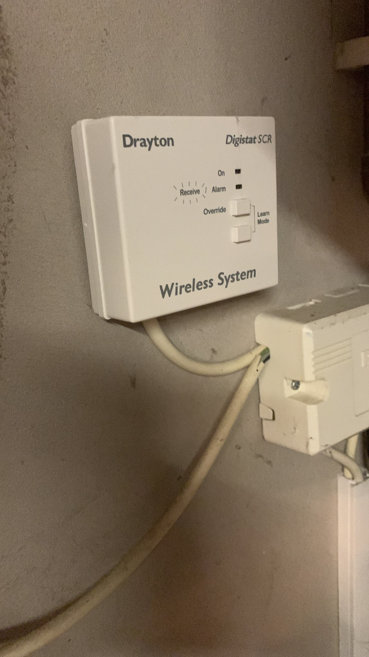

Hiya, is this old thermostat
could be replace easily with the Drayton wireless system as pictures below
.605B3ED6-CB20-4769-AB3B-B6DF7E1ECBC1.pngCE5944B6-E234-48CF-AC85-67F4563E6BE6.png?
thanks

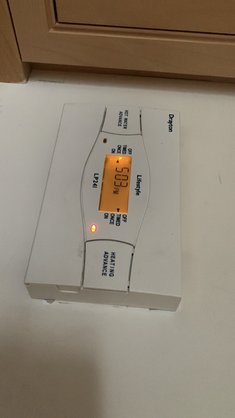

It should be doable, but the Drayton photos are only a programmer and receiver, no thermostat

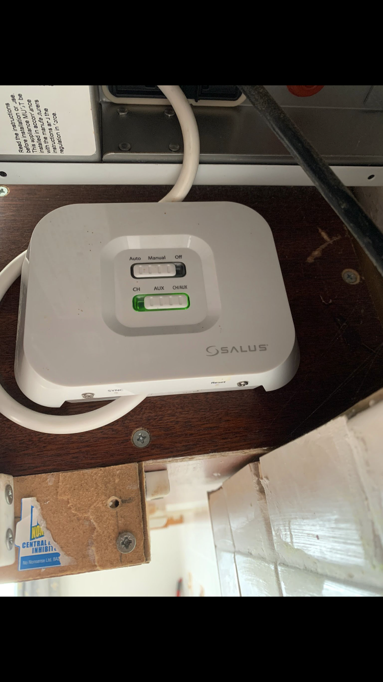

Does that mean I could replace the Drayton wireless system box to the SALUS one? And that could do the job. Thanks
Possibly, just check it’s connected inside the junction box. Make sure you have the wireless thermostat as well, otherwise you’ll be substituting one receiver for another.
