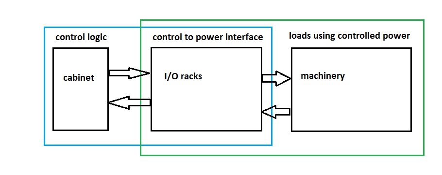

If the load was replaced by a CONTRACTOR and it powered the load then I could agree.
Contractor or contactor :(
Who would have responsibilty for the area where the green ( electrical power ) and blue ( control ) areas overlap.
And there is the added complexity of safety systems that must operate independently from the controls in the cabinet.
I think you're trying to over analyse John.
As you will realise from what I believe and have just written. I would say that everything 'controlling' the current in the coil of a relay/contactor was a "control circuit" (quite possibly using a different voltage from the "power circuit", and that everything in the circuit switched by the contacts of the relay/contactor ('controlling' current flow to the end-load" is a "power" circuit.
... But even then it would still come under the jurisdiction of the controls engineer. Everything within the control panel is quite deliberately kept locked away from untrained personel including 'qualified electricians' for 2main reasons, 1 so they don't get hurt (extremely common) and 2 so they don't break it (even more common). ....
Maybe this is really what we are really talking about - logistical/'bureacratic' demarcations (which, as you imply, may be well-intentioned), rather than any sensible electrically-based distinctions?

Loads to answer but not much to add.
The question has developed into: when a circuit contains power and control elements what is it? I say the complexity moves it to control.
Therefore green and blue boxes are both under the control engineer.
Which takes it right back to my earlier comments.
Loads to answer but not much to add. The question has developed into: when a circuit contains power and control elements what is it? I say the complexity moves it to control.
It's obviously open to debate, and BS7671 is seemingly silent on the matter. Your view may well be 'operationally reasonable' in truly complex situations, even if not based on any 'electrical logic' - but I would question the 'complexity' of a simple circuit which, say, supplied a control signal to a boiler and power to a pump. In any event, in terms of this thread, I remain of the view that it is not really either appropriate or useful to describe a lighting circuit with a manual switch as a 'control circuit'!
Again, quite probably 'operationally reasonable' if the situation is complex, but not really based on anything electrical.
