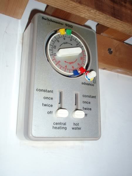

Does anyone have an instruction manual for a switchmaster 900 central heating/hotwater controller that they would not mind sharing?
I have read other similar posts and I can work out the controls but an instruction manual is always useful and this is really what I am after.
One problem I do have is that there is no arrow to line up the timer dial!!

It is very easy to change for another programmer. They have a "Programmer Compatibility Guide" page 50 of their 2009 catalogue which you can download
IIRC is is very similar to the SM2 programmer which is very easy to use and intuitive even for the older untrained user.
You set the time by rotating the main dial clockwise so the correct time is against the mark near the Advance knob.
The four coloured markers are ON, OFF, ON OFF. You can move the markers by pulling them out (away from the centre) sliding them round the dial then pushing in again. This allows you to have two periods when the heating/ hot water are on. (You will have to experiment to find out what each marker does but the will always be in the order: On, Off, On, Off.)
The slide switches allow you to override the marker settings:
Constant means the heating/hot water is on 24 hours a day
Once that is goes on at the first marker and off at the last, i.e ignores the two intermediate markers.
Twice means it goes on at the first marker, off at the second, on at the third and off at the fourth.
Off means it is off all the time.
The advance knob allows you to temporarily override the setting. So, if the heating/ hot water has just gone off and you want to bring it back on again, e.g for a late night party, you just turn the advance knob anticlockwise until it clicks and the boiler will come on. It will then stay on until the next schedule ON time. You can turn it off again by turning the knob anticlockwise until it clicks.
Similarly, if the boiler is ON and you want to turn it OFF, e.g going out for the day, you can turn the knob clockwise which will turn the boiler off and stay off until the next scheduled ON time.

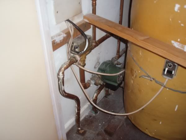

depends if you have fully pumped system, or gravity HW
Post some pictures of the pipes around the boiler, pump, cylinder and valves if unsure.

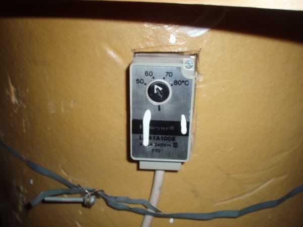

Is there a thermostat on the cylinder?
good question, I will check this evening. There is a central heating expension tank in the loft and a cold water tank that feeds the hot water tank.

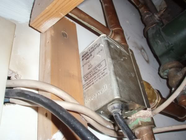

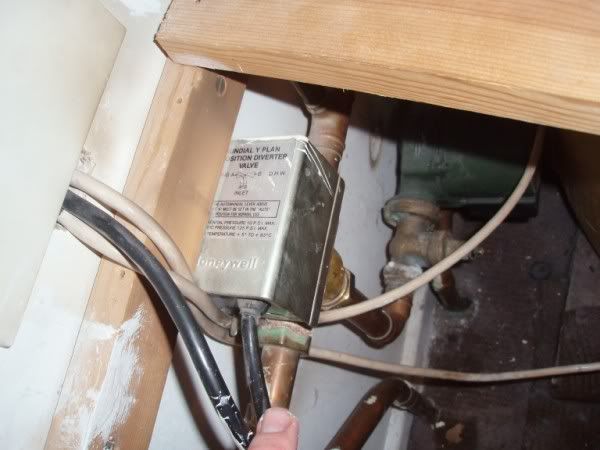

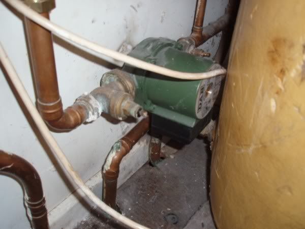

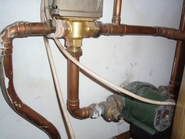

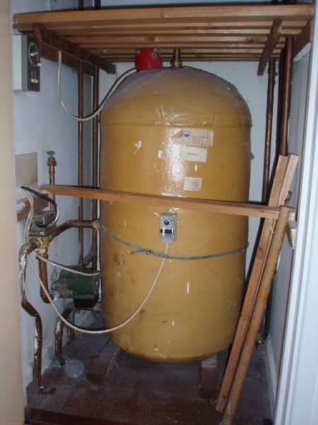

Apologies for the delay, here you go:
and the switchmaster manual:
Neil
you appear to have a fully-pumped system with a 3-port motorised valve.
Sometimes the valves leak internally with age, or just stop working.
Or perhaps yours has been set to hot-water priority or has been set to Gravity HW by mistake.
It does not need to be like that. But I would have thouight it would get the cylinder hot in half an hour or so, so no big deal.
Thanks John,
You are right, it only takes 20-30 minutes to heat the tank so not too bad. I am beginning to think the controller was not wired for that operation. I have someone coming to service the boiler soon so will ask them to take a look then.
cheers and I hope someone else will find the instructions useful.

John,
I noticed another problem yesterday. I ran the HW only but after heating the tank this then also ran the CH. So it appears that I have no control over the HW or CH other than to turn it in or off. Does this sound like a 3-port valve failure?
The plummer is coming Friday so I can chinwag with him about it then but I little bit of insight goes a long way!
