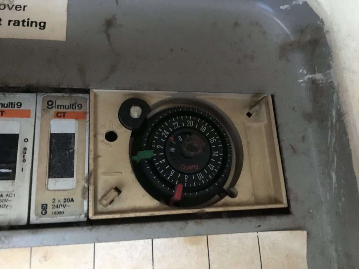

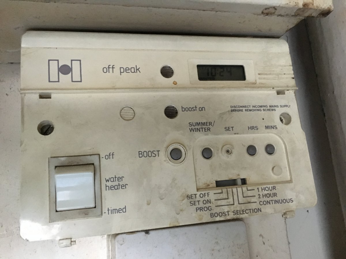

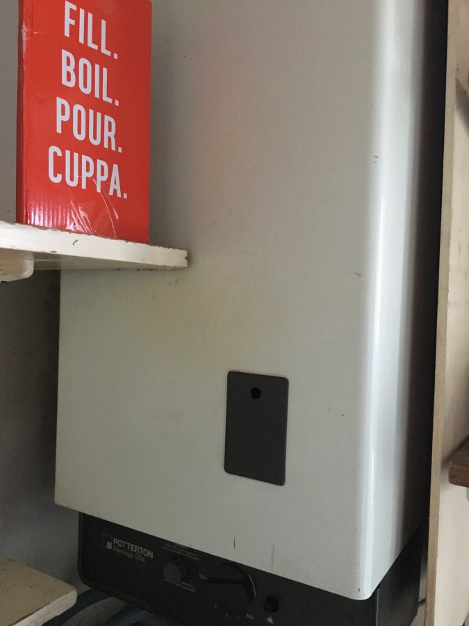

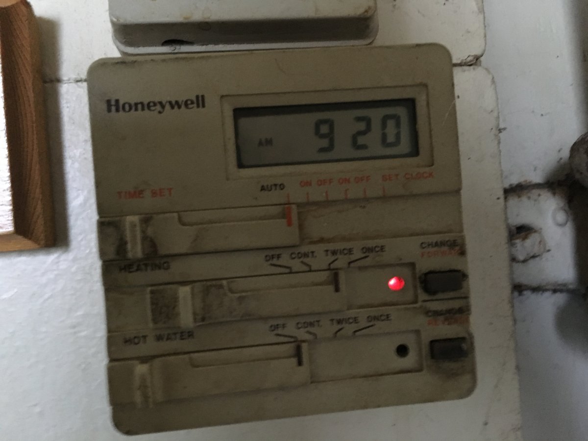

Hi there,
Following a project house purchase i was hoping someone would be able to identify the set up for me. We will be renewing it all in due course and installing a combo boiler etc but in the interim I could do with someone IDing the parts..
There is a tank in the loft space so assuming this is a traditional gravity fed system.
However it doesn't appear that the boiler is heating the water as the boiler isn't on enough currently to be heating piping hot water.
Am I right in assuming there is an electrical system heating the hot water.
The clock you can see in the board is happily ticking away...
Thanks in advance.

Third picture is an immersion heater timer. So I'd guess gas heating and electric hot water.
The Programmer has Central Heating and Hot Water controls so looks like the possibility of gas and / or electrically heated hot water.
The correct term for a hot water cylinder fed by a tank in the loft is 'open vented'.
The expression 'gravity' is used to refer to a system where the central heating is pumped and the hot water relies solely on natural (gravity) circulation. You may have this arrangement, because the main problem with it is the hot water can take a long time to get hot. If you do, it's not a quick fix to convert it to a fully pumped system, it requires motorised valve(s) and extensive wiring, all of which would become redundant if you were to move to a combi in the future.
Having said that, in the photo of the programmer hot water is shown as set to 'off' and the heating set to 'on'. That configuration is not normally possible with a basic gravity hot water system.
I have no idea what the remaining third timeswitch (in the 1st Photo) is for it seems to be part of the consumer unit, so it could be wired to pretty much anything. Maybe it's not used anymore, or it controls some exterior lights perhaps.
For more information you need to confirm what sort of pipe system the boiler is connected to. For example:
1. Basic gravity hot water with pumped central heating
2. Gravity hot water with pumped central heating and 'C Plan' control
3. Fully pumped system 'S Plan' controls
4. Fully pumped system 'Y Plan' controls
5. Something else
If you are not sure, an internet search will provide you with details of each type of system to enable you to identify what you have.
I would highly recommend you get that boiler serviced before you use it as they are great old boilers but can be dangerouse if not checked as they are positive pressure and really need regular servicing
