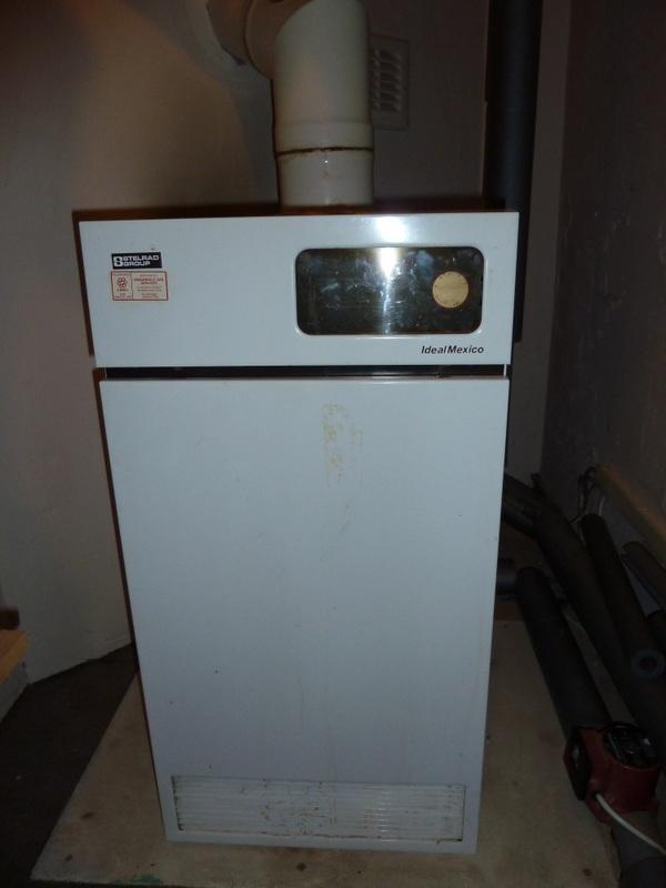

I have an old (VERY! I have just moved house) heating system, its a traditional gravity fed heating system comprising;
Ideal Mexico Boiler (CF125)
Copper water cylinder

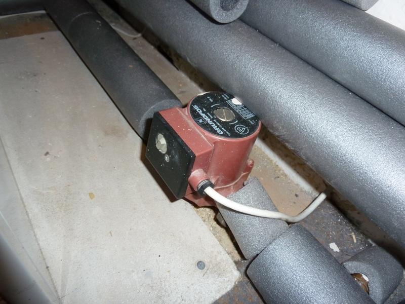

Heating circuit is pumped
Water is gravity, with cylinder stat and moterised valve to shut the water off when it reaches temp.
Potterton EP2000 programmer
The boiler has two heating circuits coming from it (4 pipes total), one for the central heating the other for the hot water.
All I want to be able to do is have the hot water on independanty from the heating. I have read various posts and Internet sites and I "think" this may be possible? I think the central heating can only be "on" if the boiler is on and therefore the hot water circuit too? But can the heating for the hot water be on and heating for the radiators be off?

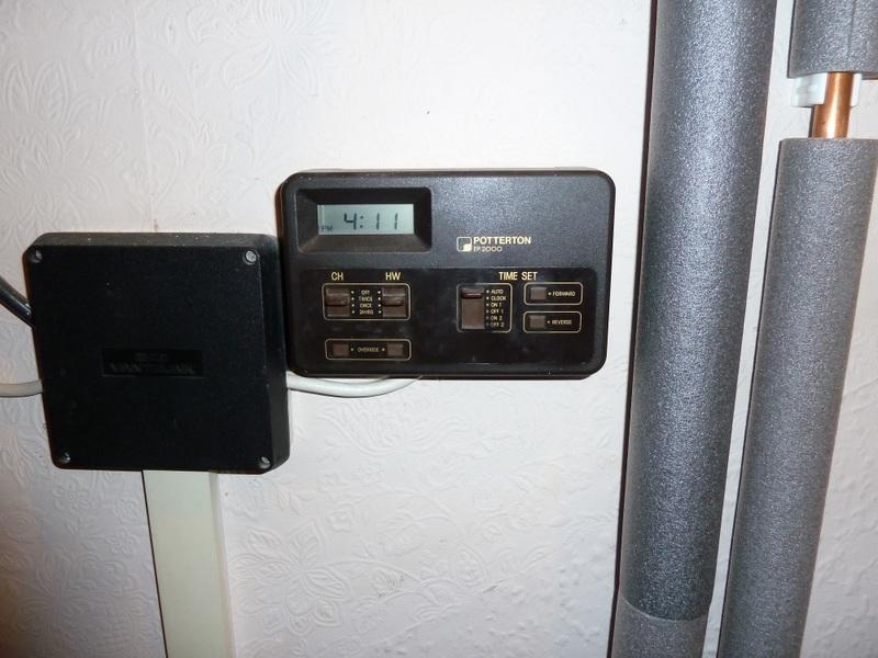

My potterton EP2000 programmer will not allow the hot water and heating to be controled independantly. I was wondering if I could change to a different controller to allow the hot water to be turned on but not the central heating.

My Potterton Ep2000 will NOT allow the independent control of hot water and heating.

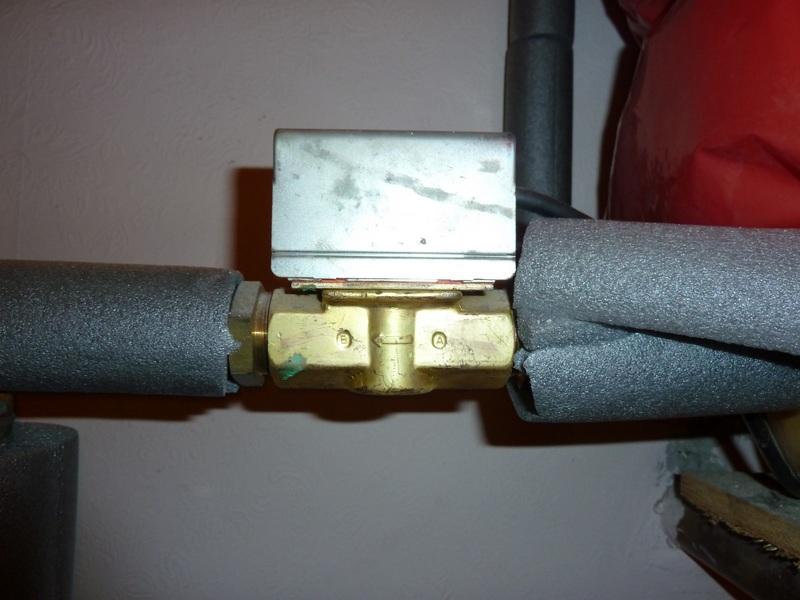

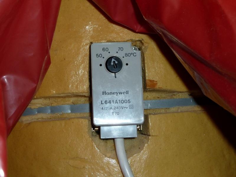

I think I have a "zone" valve (3 port moterised valve) on the feed from the boiler to the hot water cyliner. I think it's controlled via a cylinder temp stat. I assume this is to turn the hot water off when it reached the desired temp?
The Potterton EP 2xxx and 3xxx range appear to be designed to only allow hot water and heateing together. On my programmer it's physically not possible to have hot water on and heating off. The instaructions for the units appear to show this is correct i.e how they were designed??

There is an electronically controlled valve on the hot water circuit near the hot water cylinder. It controls the circuit dependent upon the temperature set by the cylinder thermostat. I am not sure if this is a Zone valve or a Port valve???
This is the only electronic valve I can see on the entire system.
Thanks,
Terry
Which type of valve do you have - left pic or right?
View media item 5946 View media item 11762
It's the one on the right. (the two port version and it's a Honeywell)
And I need to correct my original information. I can turn the central heating off and just have the hot water on. The limitation of the programmer is that the on\off times refer be both the heating and hot water.

Simplistically does the room stat just kill the power to the pump on the heating circuit?
