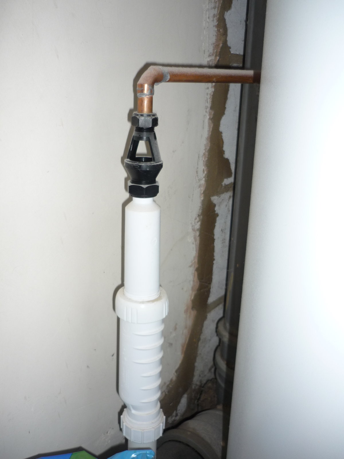

Hi,
The boiler is oil fired from the eighties. I've been outside, there are no pipes poking out of the wall. If I look behind the boiler, there's a pipe to and from, but nothing that would vent into a waste system.
I had the closed system with a tank installed a couple of years ago. The plumber that did it put in a vent next to the tank (see photo attached), but I never see anything dripping there.
Regards
Jever

Well it would have helped if you'd posted that in the first place :rolleyes:
If the heating system is sealed then you will have a discharge pipe somewhere... Look for the expansion vessel and around that for PRV (plastic red top maybe) and discharge could go from that.
Boiler and other components make and model and location of everything please...

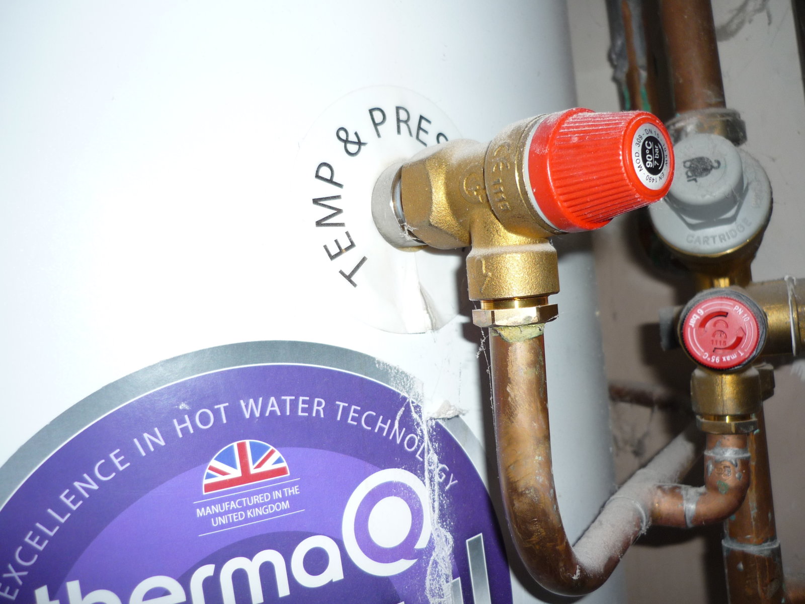

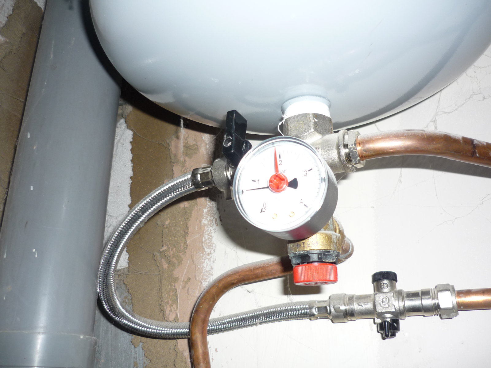

Hi,
The boiler is a Myson Velaire, located downstairs. I think I've found the PRV(s) - see photos attached. The tank and everything else I've given photos of are upstairs in the bathroom.
Items in these to photos are attached directly to the outlet I attached in the previous post.
I never see any water flowing through the outlet, but I guess that doesn't necessarily mean it isn't going out that way.
I assume the thing to do is to try to find a way to collect whatever might be flowing through the outlet?
Jever
