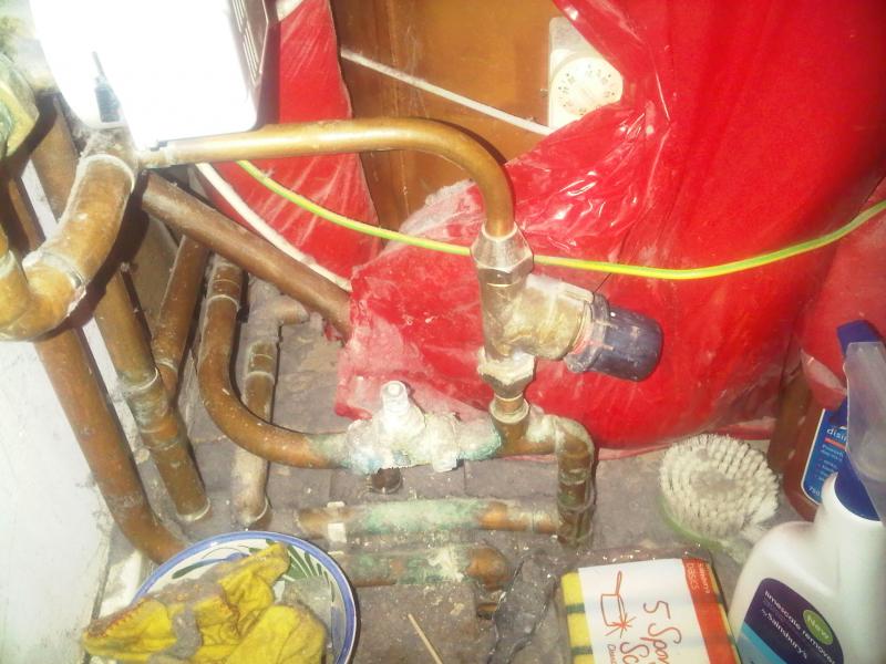

That's an auto bypass valve. I very much doubt that adding flushing chemicals will cure your pumping over problems. Those chemicals will not remove solidified crud.
