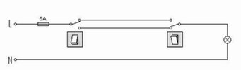

PS back in the past, two way was wired like this.
