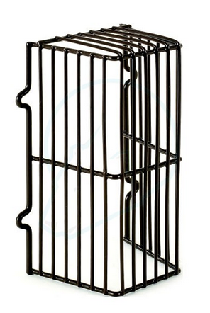

Just spoke to Kingspan Technical - who's Cylinder we have purchased.
It was advised not to run it to the plastic gully, but run it to ground ... 100mm above, guarded (to avoid small fingers getting near the outlet).
As there is block paving along the side of the property it will be terminated on the outside wall there, with one of these around the end:
