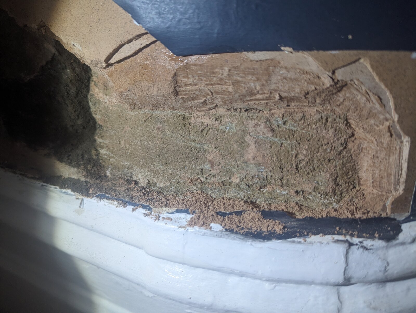

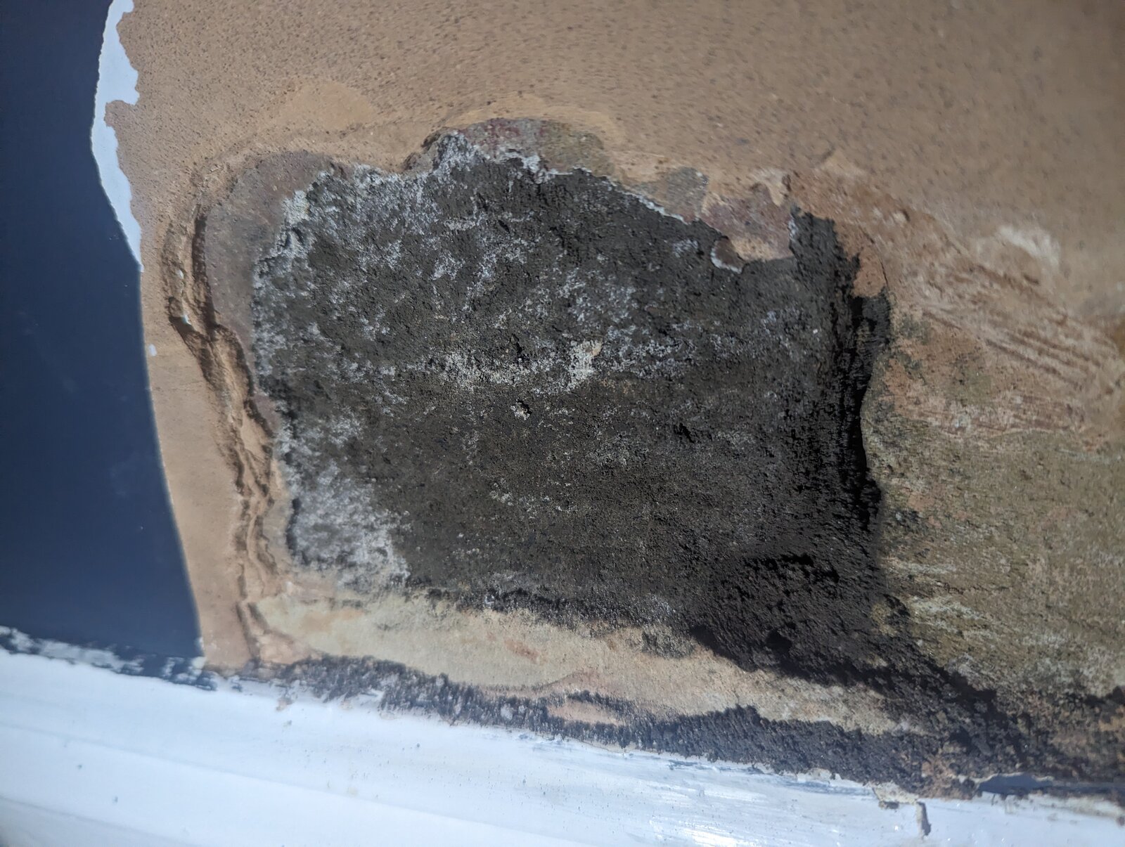

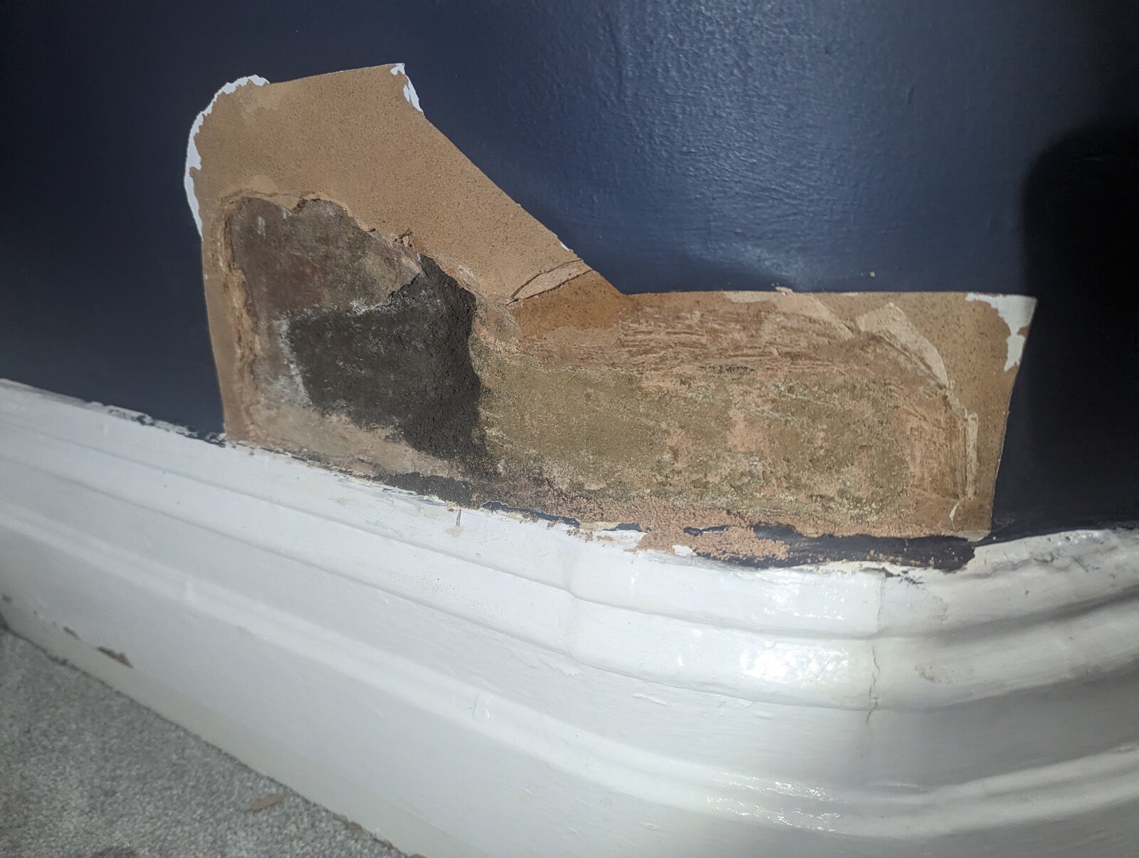

125 year old Victorian terrace and had penetrating damp on external wall, cracked soil pipe now fixed, and damp/ salts coming through a small amount into internal lounge wall. Stripped paint off but salts still appearing through plaster.

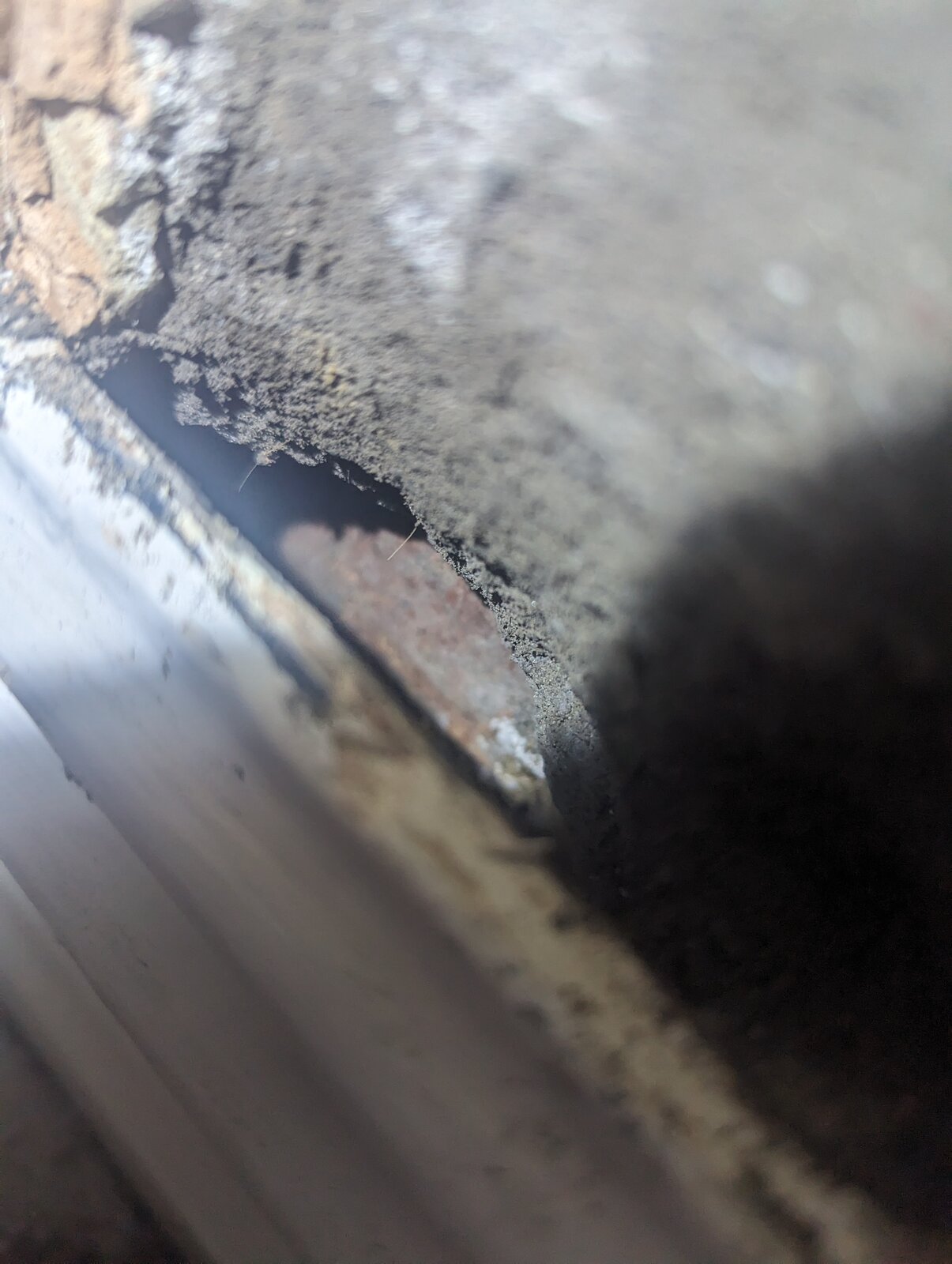

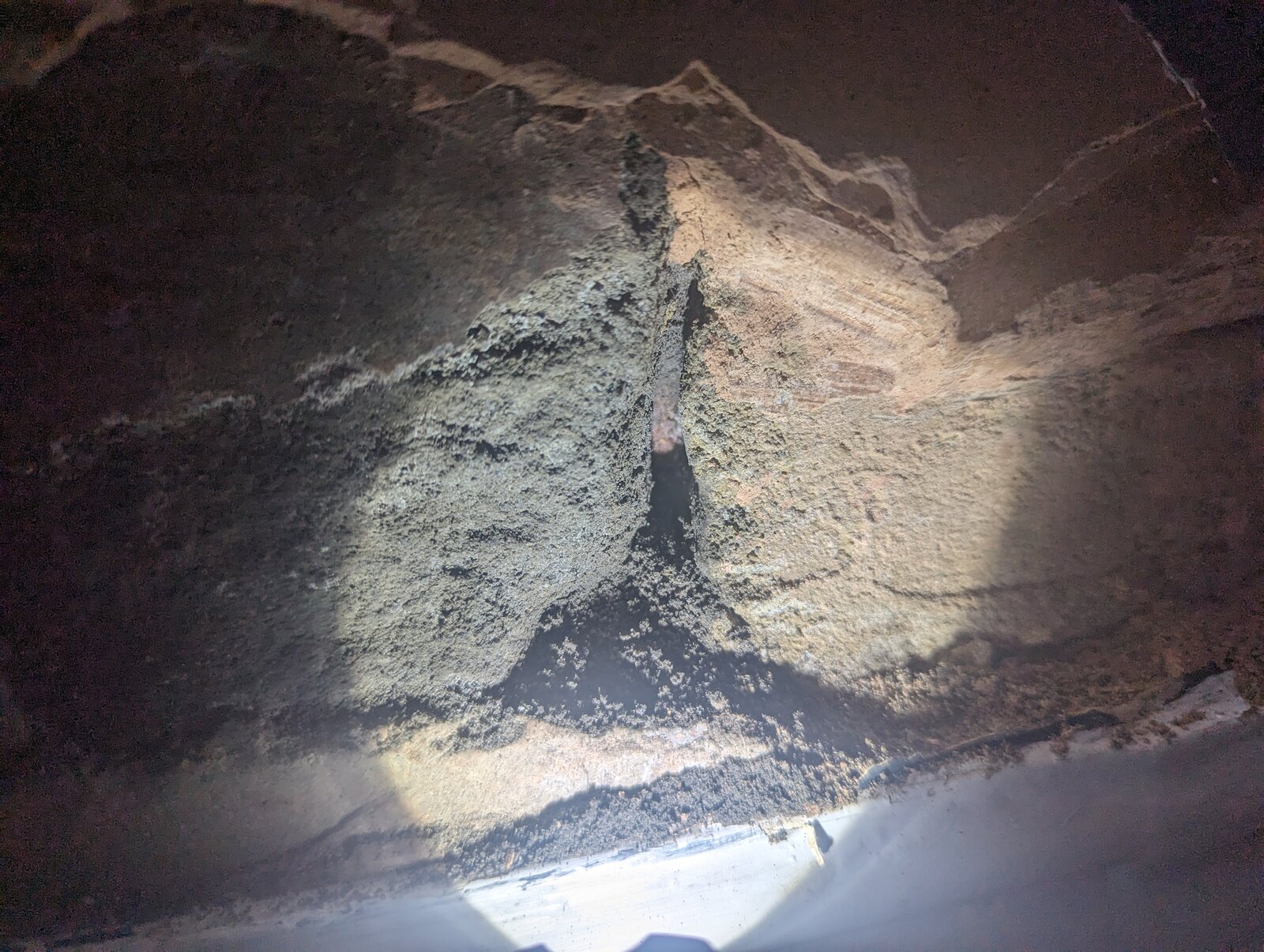

I have now chipped away the smalls section of plaster expecting to see brick but I have come across a slab of concrete on one side and some black crumbly stuff on the other. Having looked behind the black stuff, I can see the red brick about 1.5inches back.
In order to fully let that part of the wall dry out, can I let it dry out as is now the contimainted plaster has gone for a few months and then re-plaster with salt resistant plaster?
Or do I need to fully strip it back to brick, take concrete and black stuff off, which will create a gigantic hole to then have to fill back in before plastering?

Once damp problem is resolved it can take many months for salts to stop leaching out .
So is it just worth leaving it as it for a few months and then re-plaster once salts stop or do I need to strip it the other 1.5 inches back to brick which I really don't want to do to let it dry out?
Also, would I use regular plaster to repair the whole or could I use tanking slurry as well to make that part of the wall waterproof or would I just be pushing the issue elsewhere?
It's not very deep, so Joint Cement will do it.
Fill once, slightly recessed, then a final thin skim, pressed very hard. This is a good way to fill and cover any cracks or blemishes that might occur.
Never overfill above your intended finished surface. If you do, shave it off before it sets hard.
