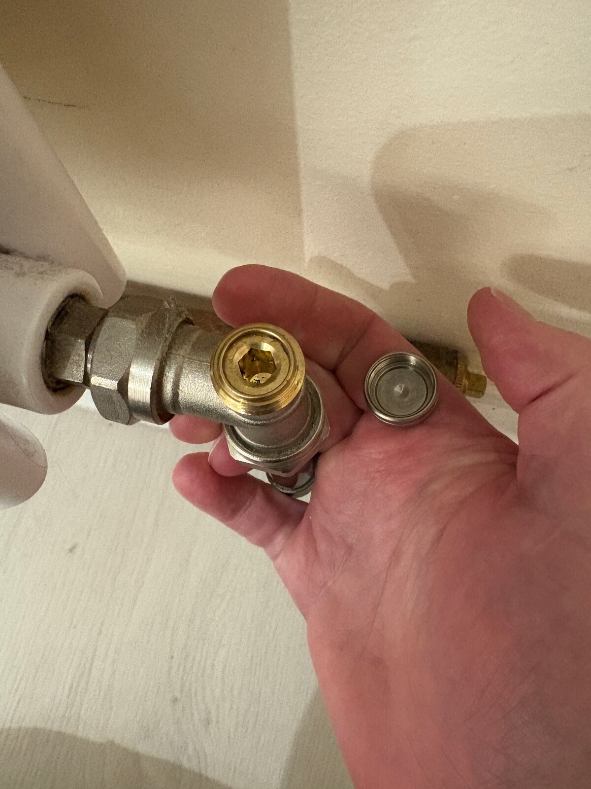

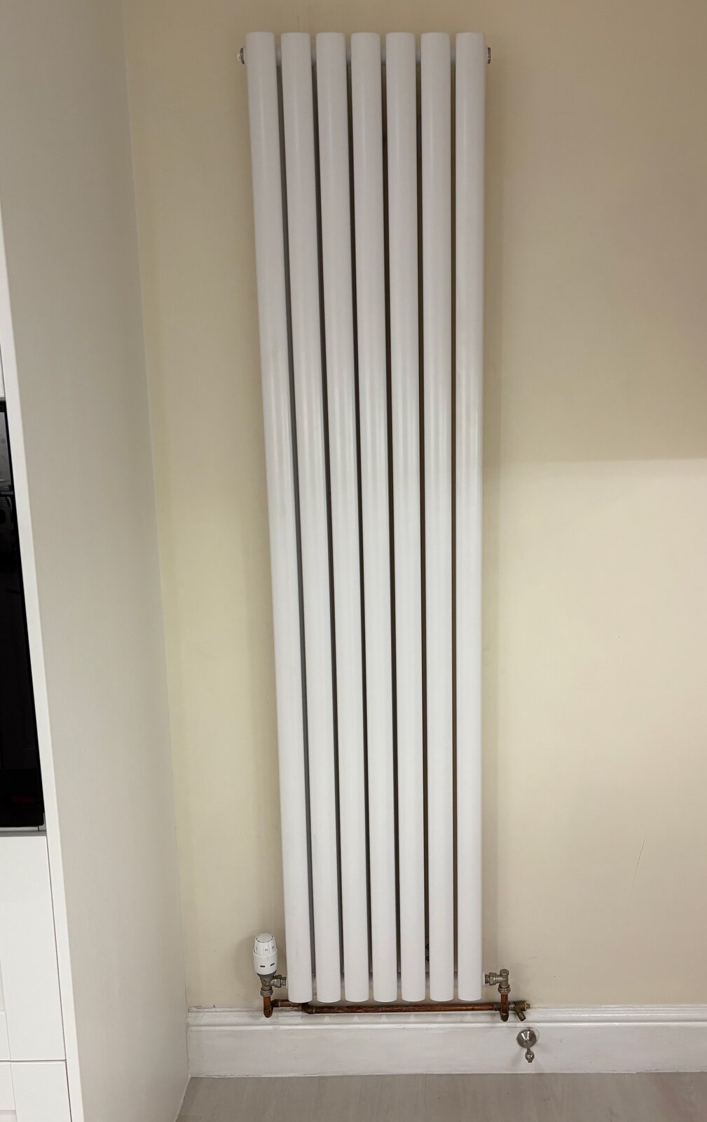

See pics. This is in our daughter's house so the info I have is not complete. The previous rad was replaced during their kitchen refurb., approx 2 years ago The new vertical rad was supposed to be better than what was there before, but it isn't (currently) and has never worked properly.
The plumber had a look, tried but basically gave up. Subsequently another plumber, doing a different job for them, also got no improvement.

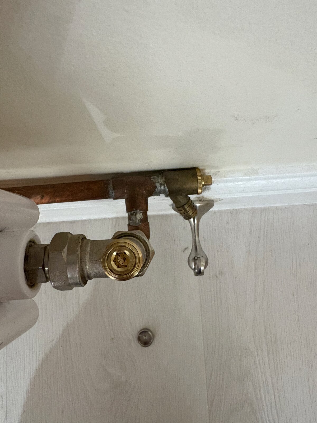

The TRV side of the pipework gets properly hot. The return (lockshield valve side) gets warm to the touch. However the entire rad is barely warm, indicating basically no flow.
The rad is full, a quick bleed showed no air at all.

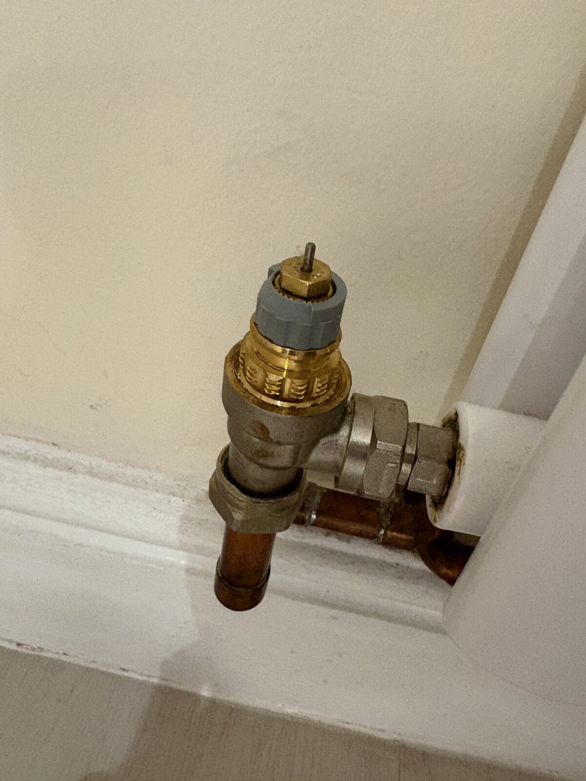

The TRV is branded Danfoss. The pin moves smoothly and freely up and down.
The lockshield side is probably also the same brand. It uses a 6mm Allen.
EDIT: this valve with the 6mm allen is anticlockwise to close, clockwise to open, correct? (Opposite of a Drayton one with exposed flat pin?)

Would be better if you could confirm flow and return by discharging into a suitable receptacle. Maybe check that it’s not been connected to both either flow and or return, I had this once, took me a good 10 minutes to realise that some clown had plumbed flow and flow (as return) on the same circuit.
Anti clockwise to open, some vertical rads need a baffle fitting or are directional have you the make of the rad
Thanks. Rad is Ximax Champion Duplex Vertical Designer Radiator, White (W)410mm (H)1800mm.
Weird that the Danfoss PDF I linked to shows an anticlockwise motion, diagram bottom of page 2. It's unclear which action it relates to.
If the new one replaced anything but a similar designer vertical rad then it would never be better
The allan key lockshield is opened anticlockwise, as suggested, but looking at the pic it seems to be fully open anyway.

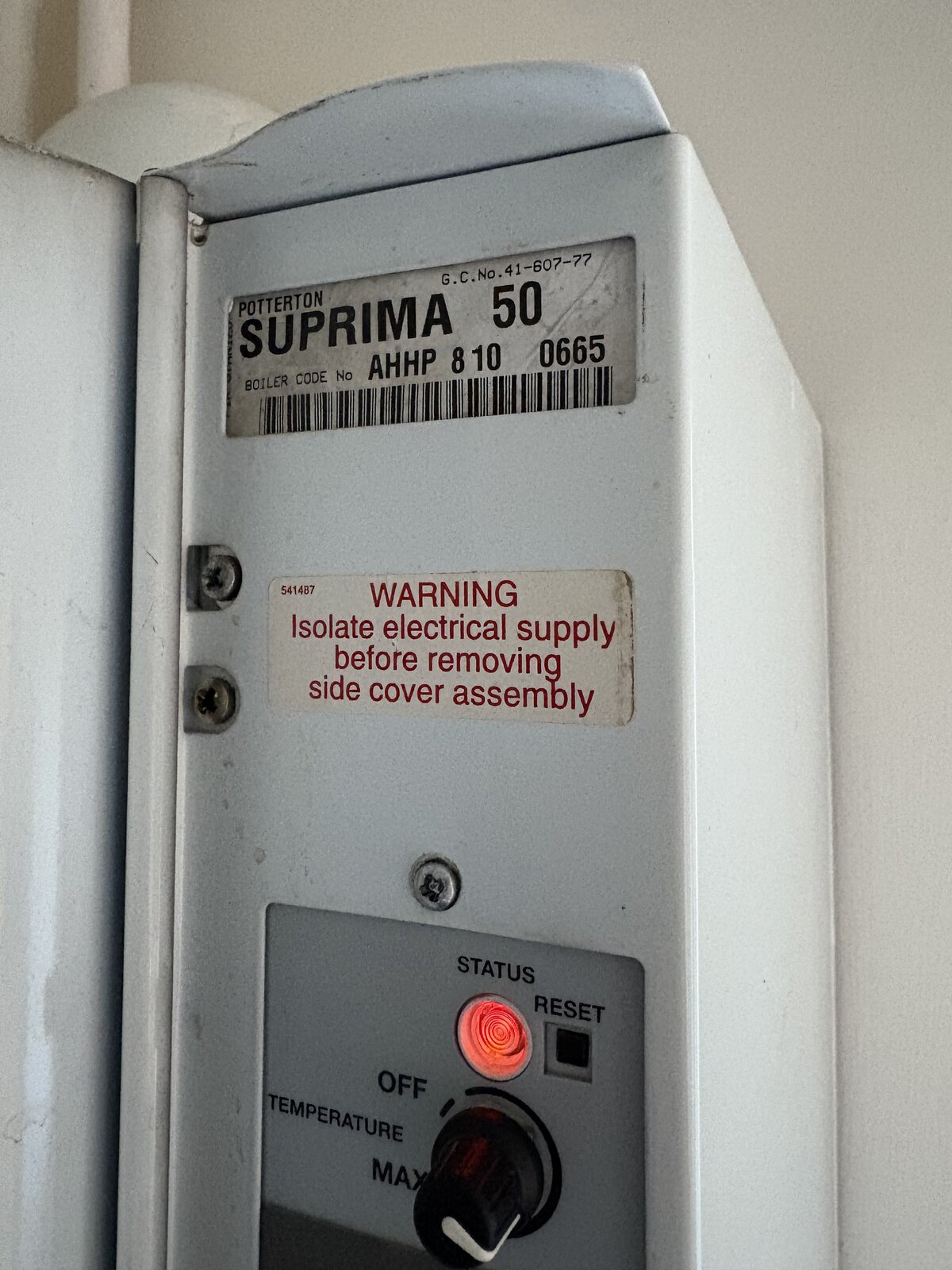

Checked last night - and the rad is now getting warm - similar to the other ones in the house, after getting the lockshield open approx 1 turn. I think the whole system needs a powerflush and a magnaclean. The boiler is a Potterton, quite old now but still working. There's no kettling so that may be because it's not a modern one with very fine heat-exchanger.
What potterton?
There's dozens.
The pump might be getting a little lazy if it's an old boiler and that'll mean the system probably needs balanced.
